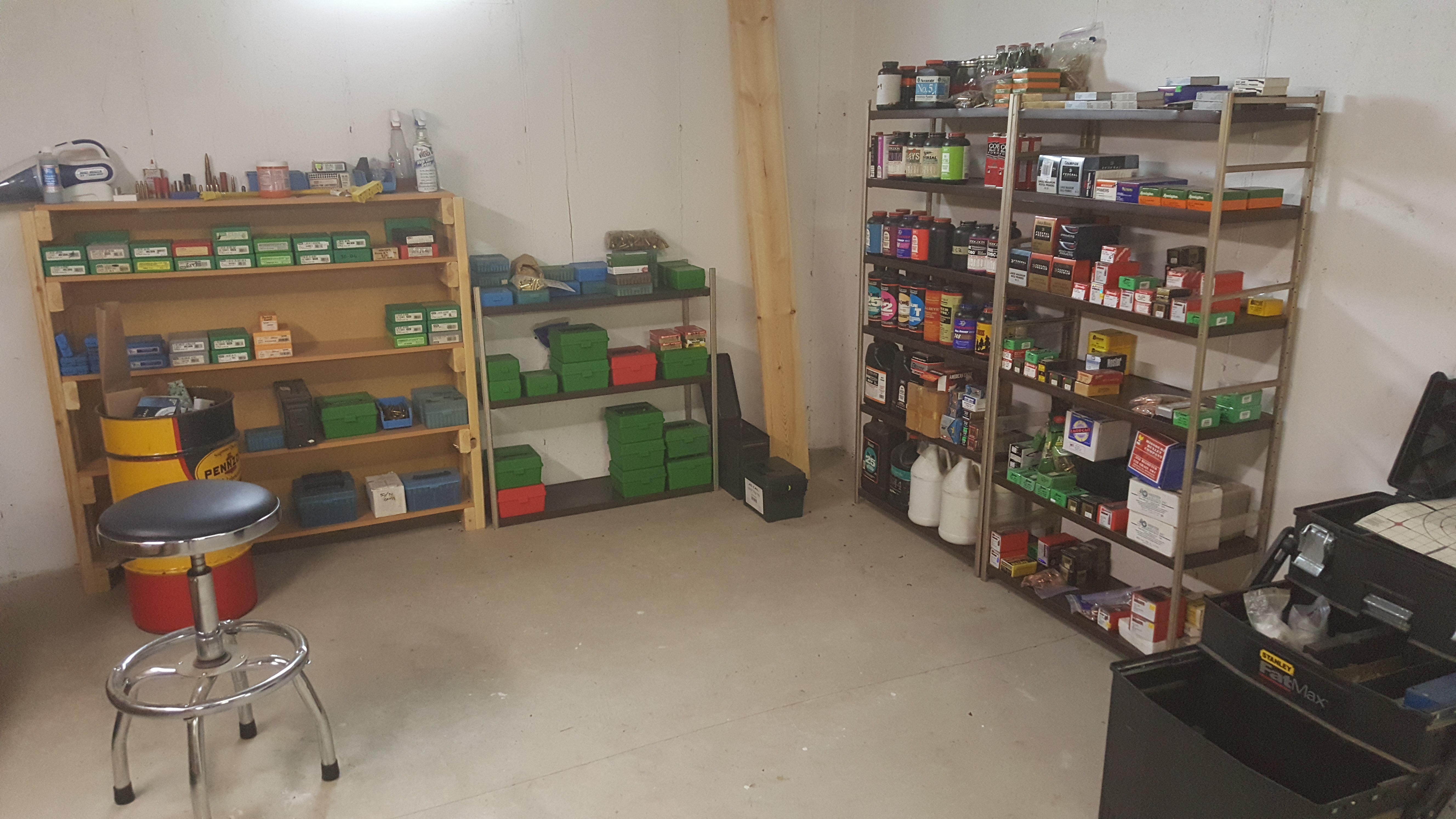

Just like with money, you can never have too much (many) reloading manuals, cartridge brass, bullets, primers or powder.
I have 3 presses, 2 single stage RCBS's, and a Dillon progressive, several dozen die sets, "many" different gunpowders/primers/bullets, and I reload for a couple dozen cartridges both rifle and pistol.
Some of my components and die sets:
My "main" reloading bench I do my cartridge loading on. The press in the center is my first one, bought new in 1975. They don't wear out in several generations if you take care of them:
A good sturdy workbench with lots of bright overhead lighting really helps you keep a sharp eye on what you are doing.
