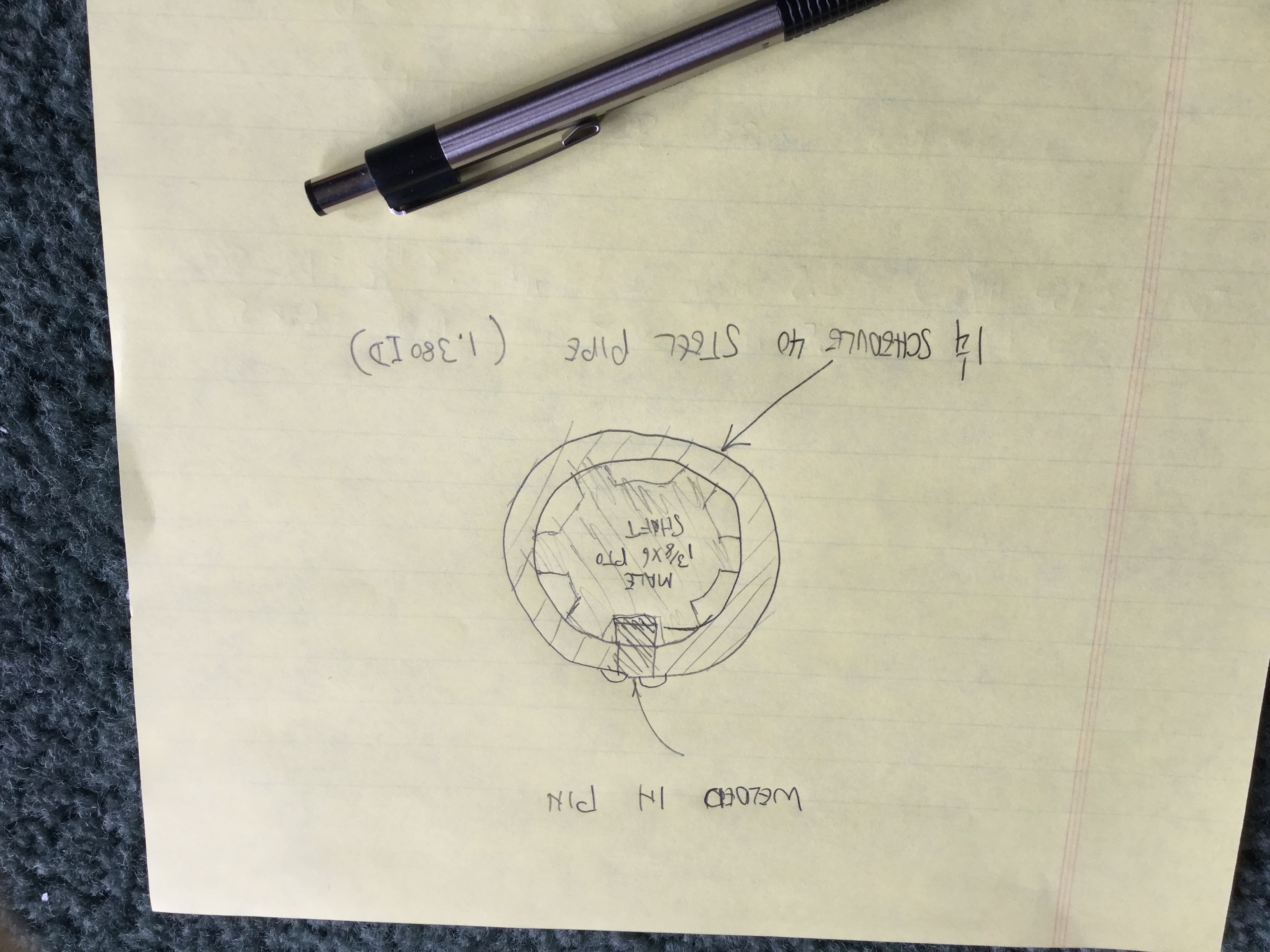

I need to make a tool to turn my Woodmaxx chipper's flywheel by hand for working on the blades. I can't turn it using the pulley.
I can weld a 1/2" socket to a female PTO adaptor but I'd rather not buy a $40+ coupler. So far the cheapest I have found is this
Pto Adapter Quick Release , pto adapter
I'll need to grind off the splines and the coating on the end. I don't need the quick release but it won't hurt.
Anyone know of a cheaper alternative?
Thanks

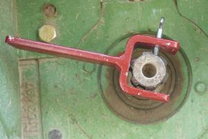

If you can weld, make one of these from stuff in your scrap metal bin. pto wrench.jpgimages (4).png

Thanks. The tool zzvyb6 posted wont' work with out mods due to a PTO shield. But it gave me an idea for a different design that I might have materials for already.
   / cheapest female 1 3/8 PTO coupler #6
If the PTO spline has a hole through it, slip a piece of tubing over it with a hole drilled for a pin. :thumbsup:
   / cheapest female 1 3/8 PTO coupler #7
Just a piece of pipe slipped over the pto with holes drilled in the proper places for bolts/round stock or flat stock to go through and a handle is easy enough, even a pipe wrench will work for a handle.
