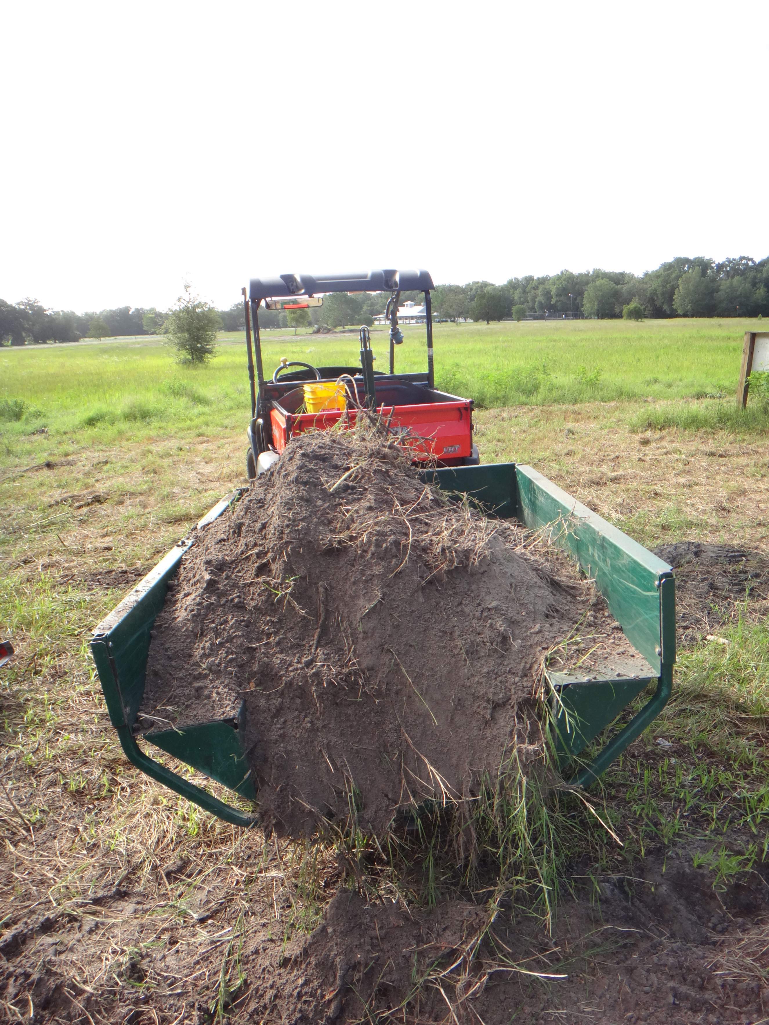

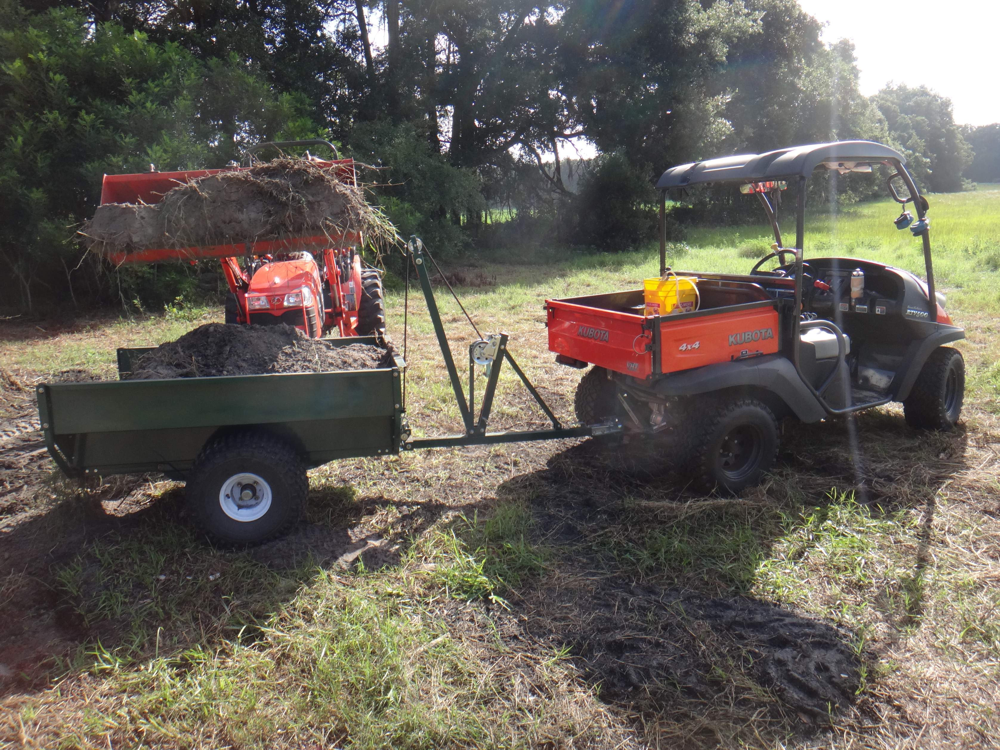

I have a Wallenstein BX42s chipper. I chip a lot of wild grape vines pulled from trees. The BX42s is fine for 3/4+" vines. Running a 30' section of 3" vine through, which self-feeds, is fun!
BX42s tends to plug with thinner cuttings, like green, flexible, annual pruning material, which does not have enough mass/inertia/resistance for the knives to cut and therefore wrap around the rotor trunnions and load the rotor chamber before plugging the chute. Chipper (only) is not the tool for you.
For processing annual pruning waste get a Wallenstein BXM42 CHIPPER/SHREDDER.
Pictures show the Wallenstein mounted on my Kubota B3300SU (25 PTO horsepower) which had enough power to run the BX42s chipper satisfactorily.
LINK TO WALLENSTEIN WEB SITE: Wallenstein BXM Series PTO Wood Chipper / Shredder Specs - Wallenstein Outdoor Power Equipment Made in Canada

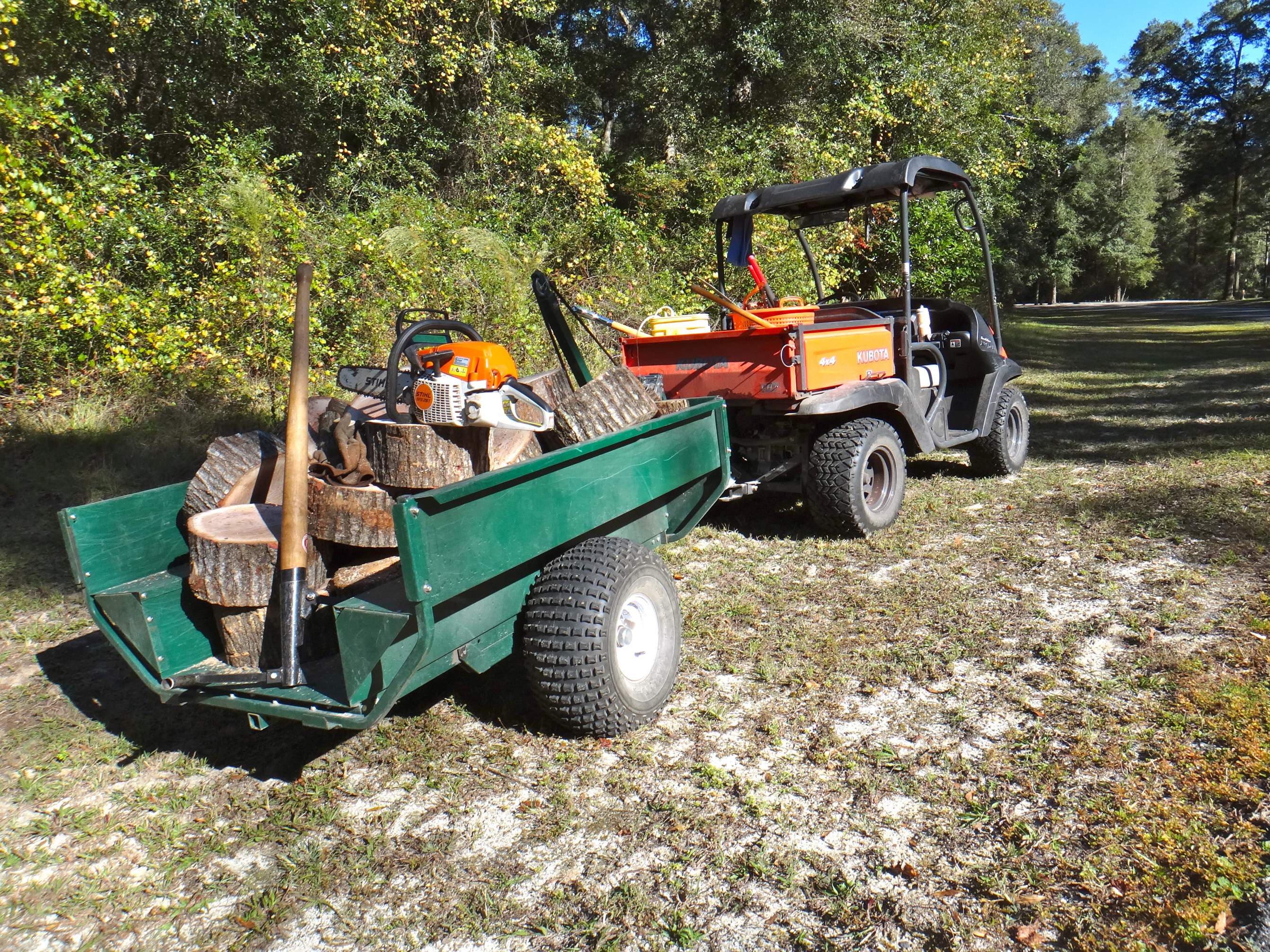

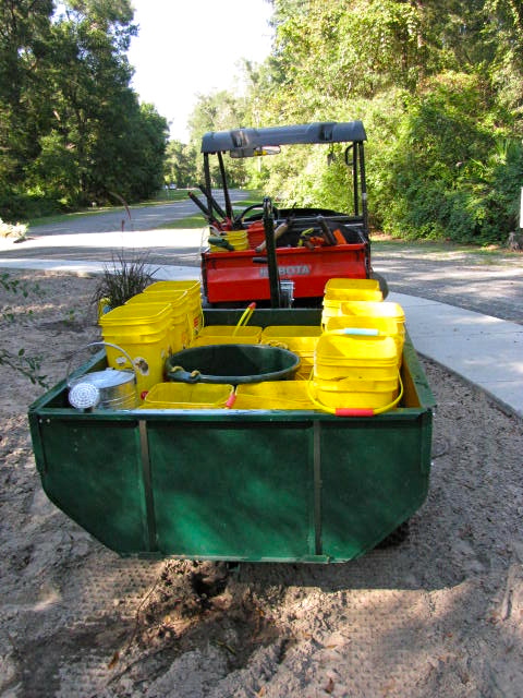

Interesting "Dump Cart" you have there. Looks like it has built in seats too! What brand model is that?
   / Chipper or Shredder for Grapevine Prunings #16
It is an older, single axle MULTI USE TRAILER SYSTEM (MUTS) all terrain trailer from Canada. The 'seats' place the trailer load low, on the plane of the axle, so it will go anywhere your utility vehicle or tractor can go.
MUTS dumps with a mast and boat trailer winch, which is a real labor saver.
MUTS - Multi-Use Trailer System for your ATV, Quad and 4 Wheeler - Welcome
