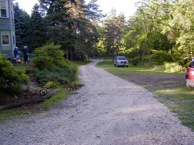

I have used a rented 60" rotary cutter behind mine. About 2.5 acres fairly flat, from low to high point about 8' in elevation difference. Field was probably not cut in atleast 5-10 years. (saplings about 1" diameter and lots of good size rose bushes) Slow and easy about 4-5 hours. Finished up the edge of heavier brush in sizes up 2". about .25 acre. This took a LOT longer. Required backing into the brush, pulling out, back in again, back out, repeat until done.
It would not be a problem on a field that is kept maintained and fairly flat. If hills are involved a 4' will be easier to maintain speed.
I also use a 5' box blade. I have not had any problems pulling it. The only complaint that I have with the box blade is that it fills up to fast /forums/images/graemlins/blush.gif. This is through top soil and clay. I have used it with the rippers down to remove roots (from the area that was brush hogged). Spread about 16ton of gravel on approx 200' of driveway (see attachment) (it was just dumped.. not tailgated). Also makes it nice since it is wider than the tires. The only one that might be better is a 54" to match the bucket.
Kurt

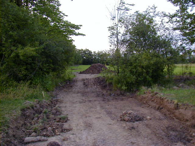

Here is a pic of about 88' of an other driveway that the boxblade and toothbar cut out. (this is still in the rough stage). (This is the same field that the Rotary Cutter was used on.)
