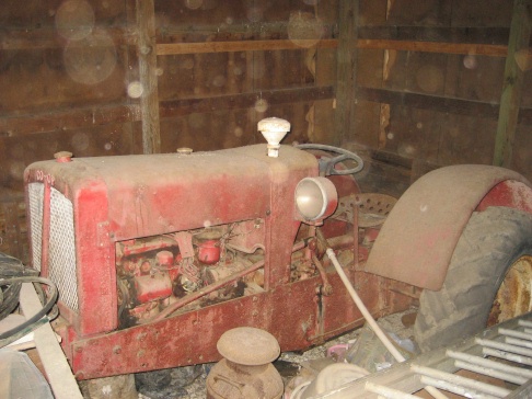

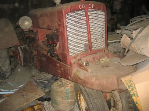

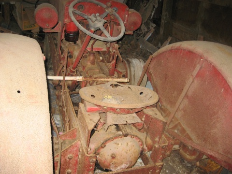

Here are the pictures I promised. hope it works. Couldn't get them in last night.
Mark

   / CO-OP Tractors? #7
Don't think so.
Cockshutt started making tractors in 1946--the Cockshutt 30.
He said CO-OP not Cockshutt. Later on Cockshutt took over the CO-OP stuff but the early ones had nothing to do with Cockshutt.
They were a lot uglier. Made by the Duplex Machinery Co or something like that if I remember correctly.
See em at the shows and antique pulls a bit.
