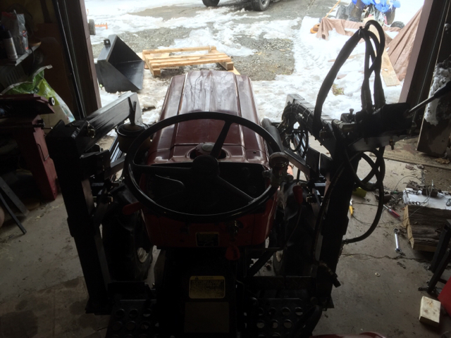

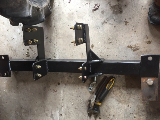

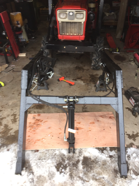

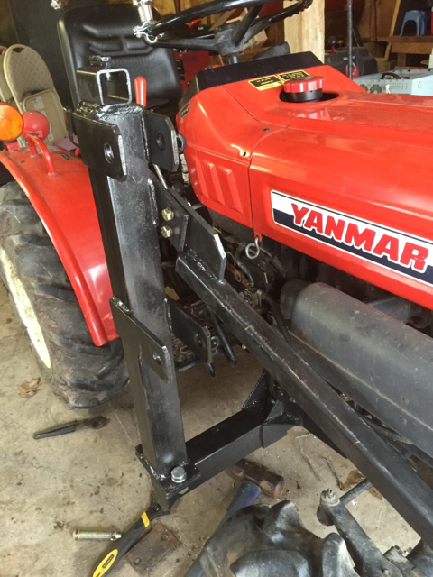

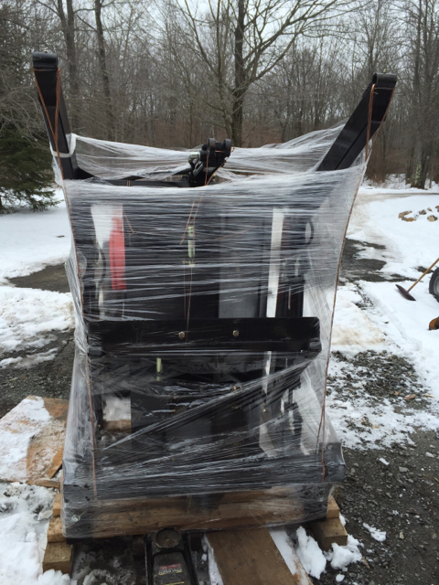

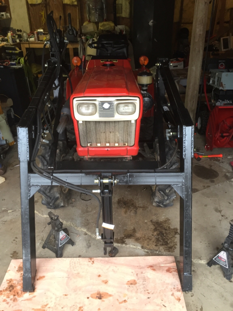

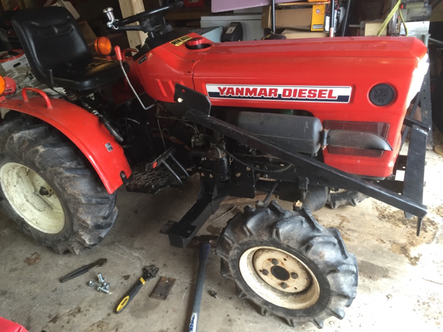

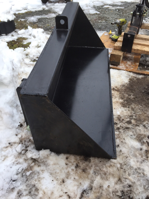

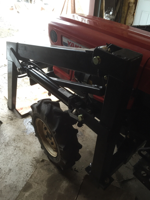

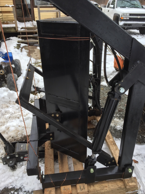

This is how I got today with the install. So far very pleased with ColdWater. Great customer service and knowledge. All welds look great. Very nice looking loader. Tomorrow will pin on bucket ,plumb it up and see what kind of trouble I can get into here

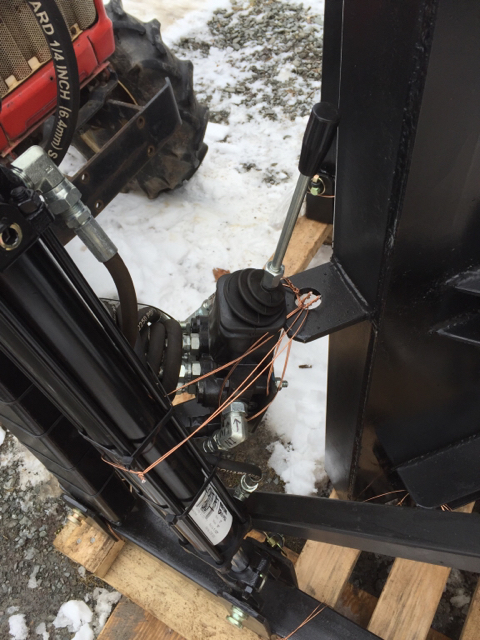

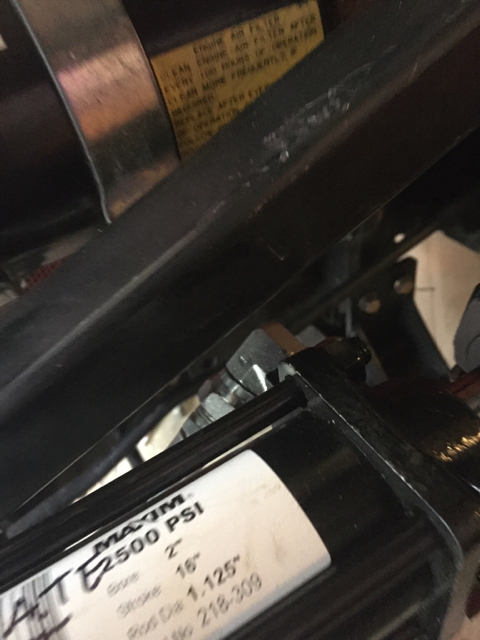

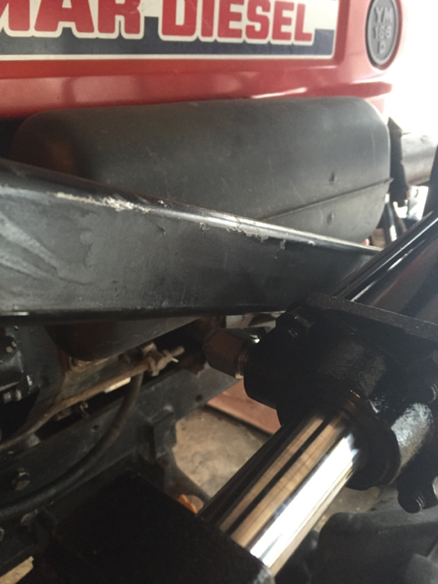

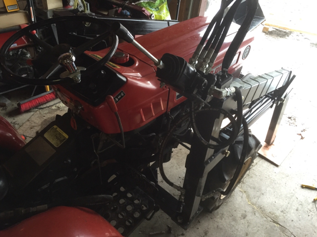

I got the loader all working! Just one problem can only go up a couple inches before I would it a 90 fitting in the ram. I emailed cold water waiting on a reply. It's like that on both sides. Guess I did something wrong. Image1460044126.630163.jpgImage1460044138.822829.jpg
   / ColdWater tractor loader install #8
can't you rotate that cylinder ,so that the fitting is on the bottom or top ? I don't have a cold water loader,but my fittings are on top I believe,, I know they aren't on the side
#9
Kenmac your a genius all fixed and works great. I guess being excited makes you blind because it said it right there on the sticker Turn out lol. Thanks again. As soon as this rain is done I'm taking it out.
I just pulled the end pin and turned the whole cylinder on each side easy peasy
