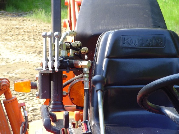

If anyone is interested in seeing the Eaton valve mounted, here it is.
   / Compact Hydraulic Valve #7
It has a very small footprint.

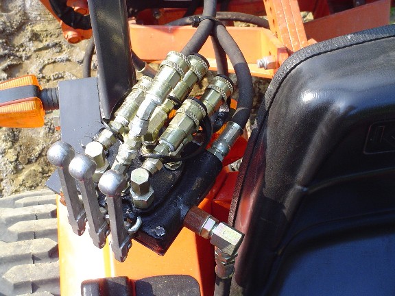

   / Compact Hydraulic Valve #8
Last one.
