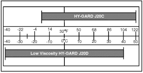

Friend left me a couple of almost full gallon containers of JD HYGUARD fluid.
One is TY6354
The other is TY22000.......listed as low viscosity.
I've got a Kubota M8540
A CAT D5G
A Challenger MT 525, with Diamond mower
What will the JD be compatible with such that I can use it to top off any of these. Yes......they all have the typical tiny drips here and there.

Hy-Gard in low viscosity is J20D winter use down to -40F or more.
These two are the same because Yanmar has been making compact tractors for JD for the past 45+ years.
Yanmar uses this fluid in the MTD Cub Cadet's too.
