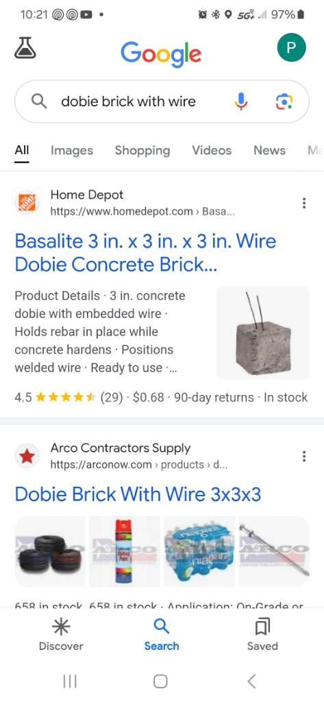

My last large pour, (40 yards, 15+ years ago), I used chairs made from concrete with a built in wire tie. Very handy. I searched and cannot find them now. It seems like plastic or wire are the only choices. I used #4 rebar, 24" on center in a grid format. I have no cracks, I did not use fiber in the small aggregate 4000 psi concrete.
Search Dobie brick. Looks like Hime Depot lists them, but may not stock them; place like Whitecap should stock them.

What I don't like is the lack of a loop on those wire ends for consumer box store dobie blocks, you can't use a twister. Imo it would get old in a hurry on a big pour bending over tying all those blocks with a lineman's or similar pliers.
