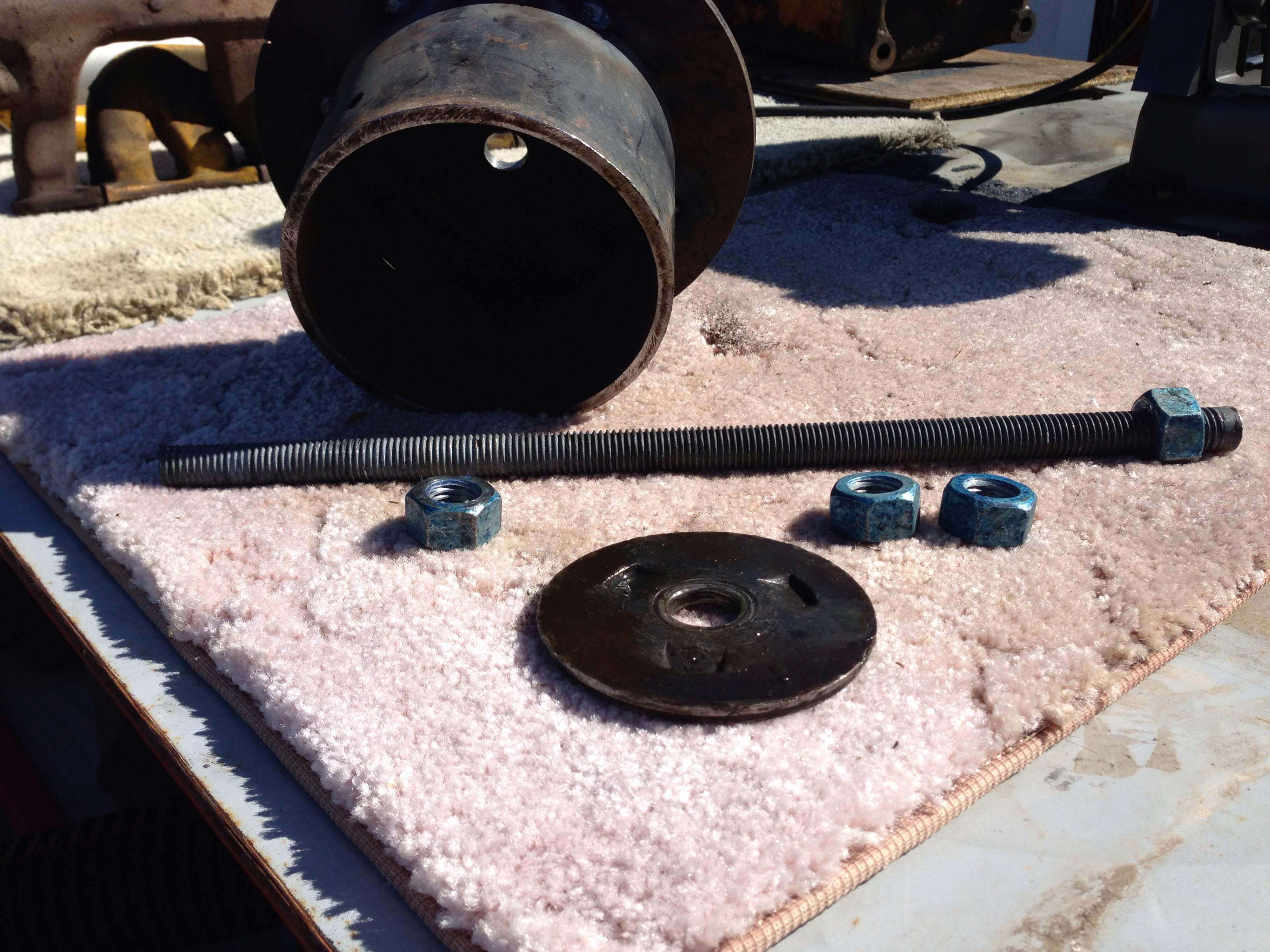

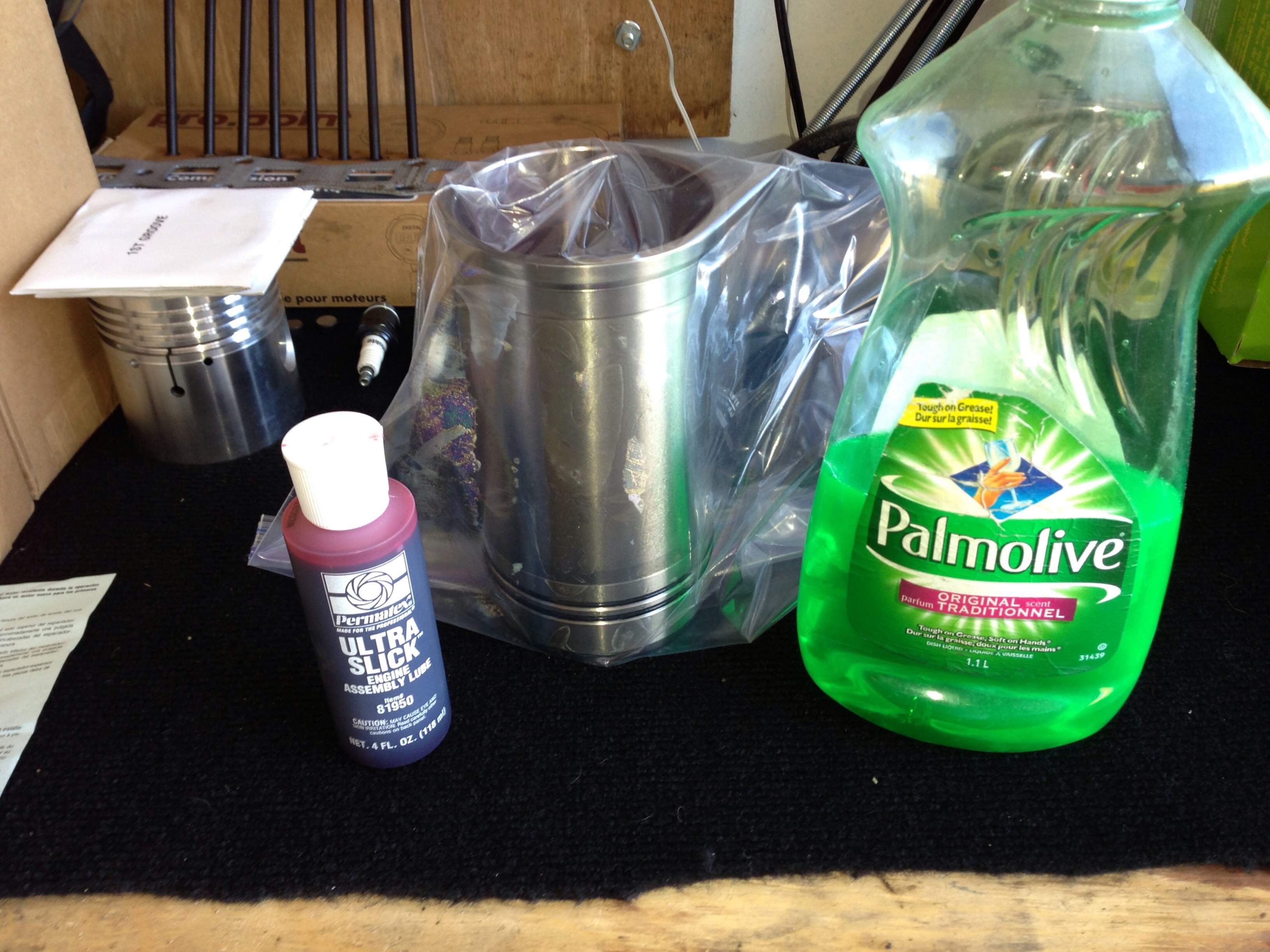

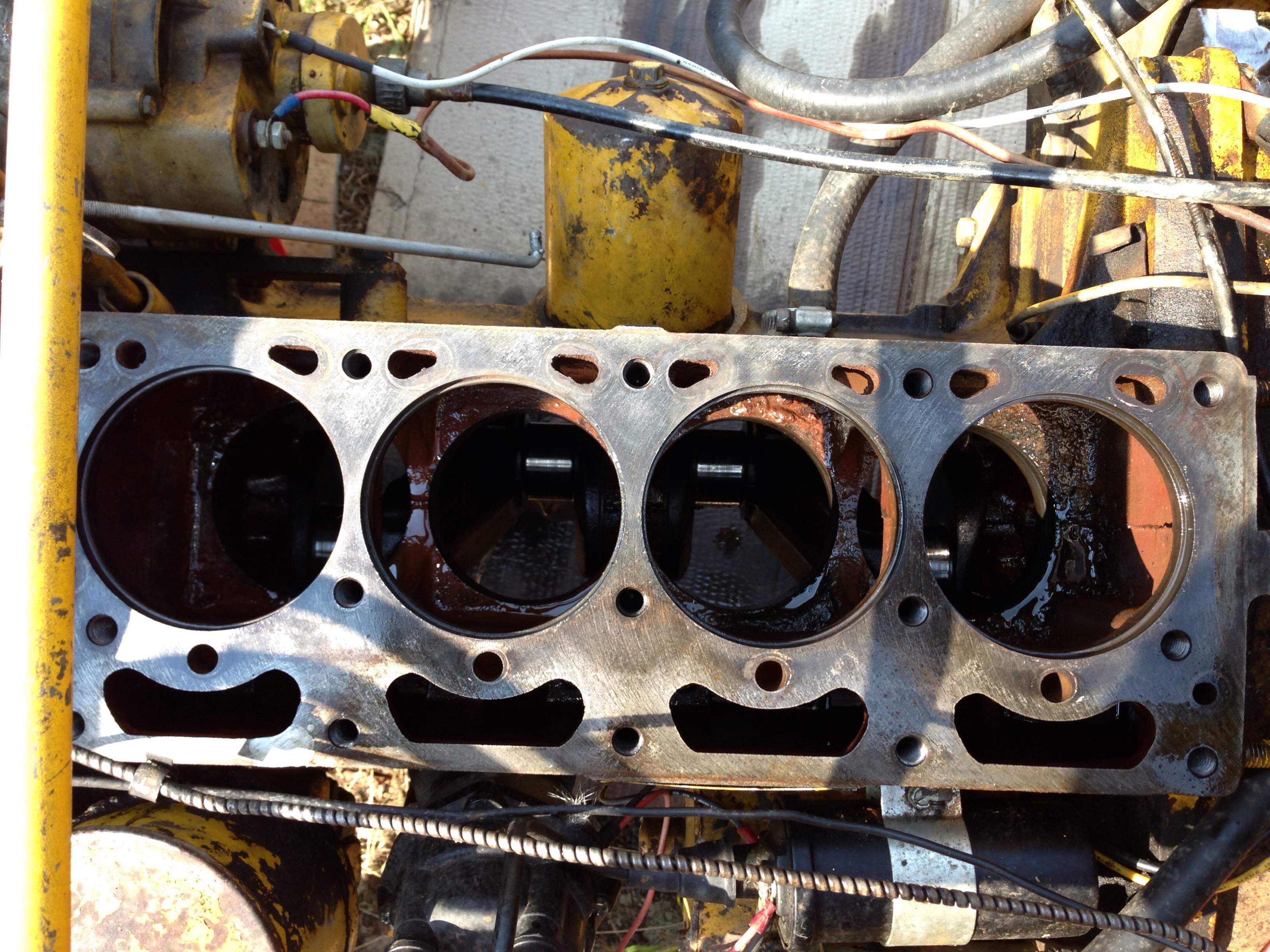

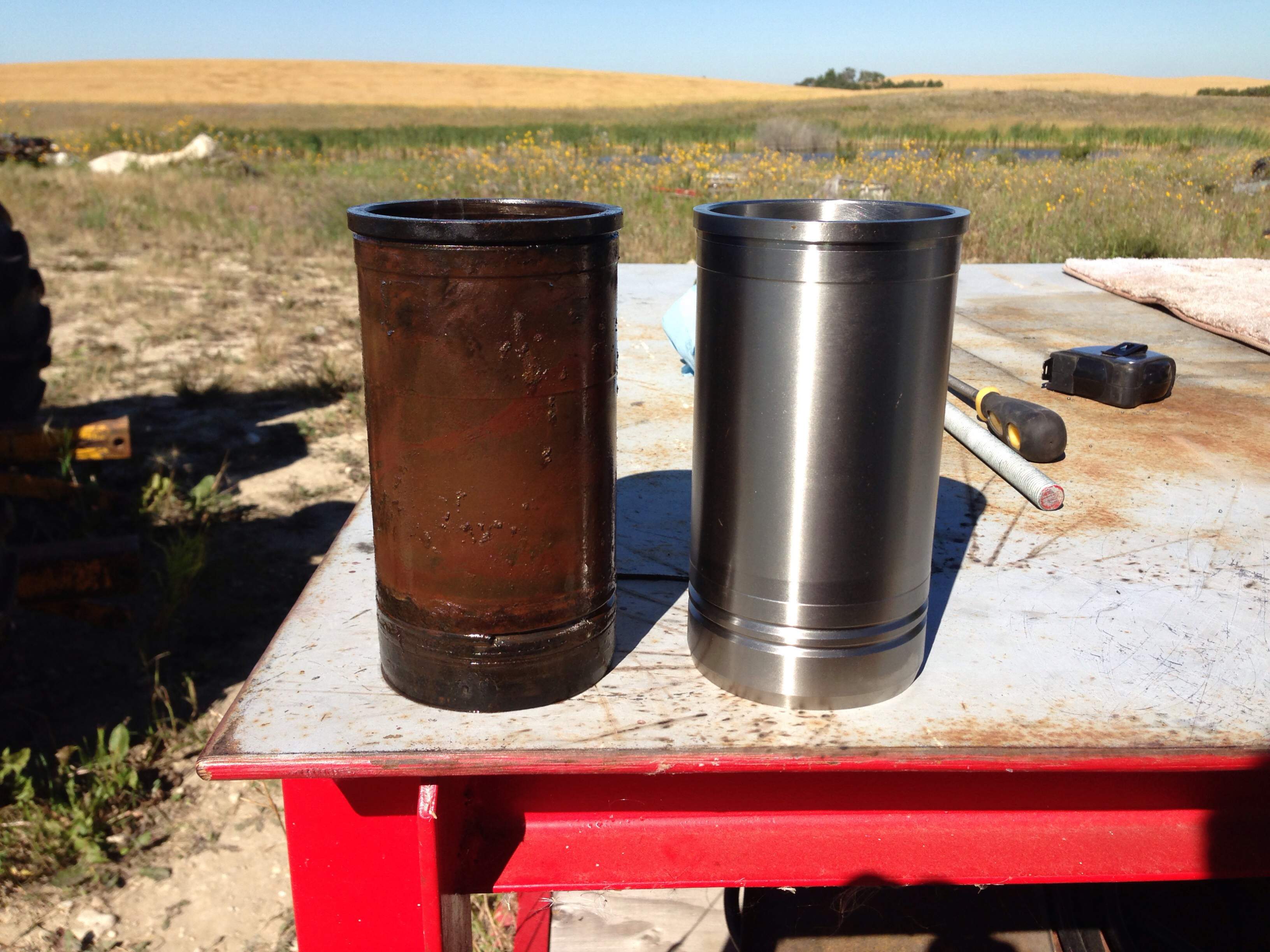

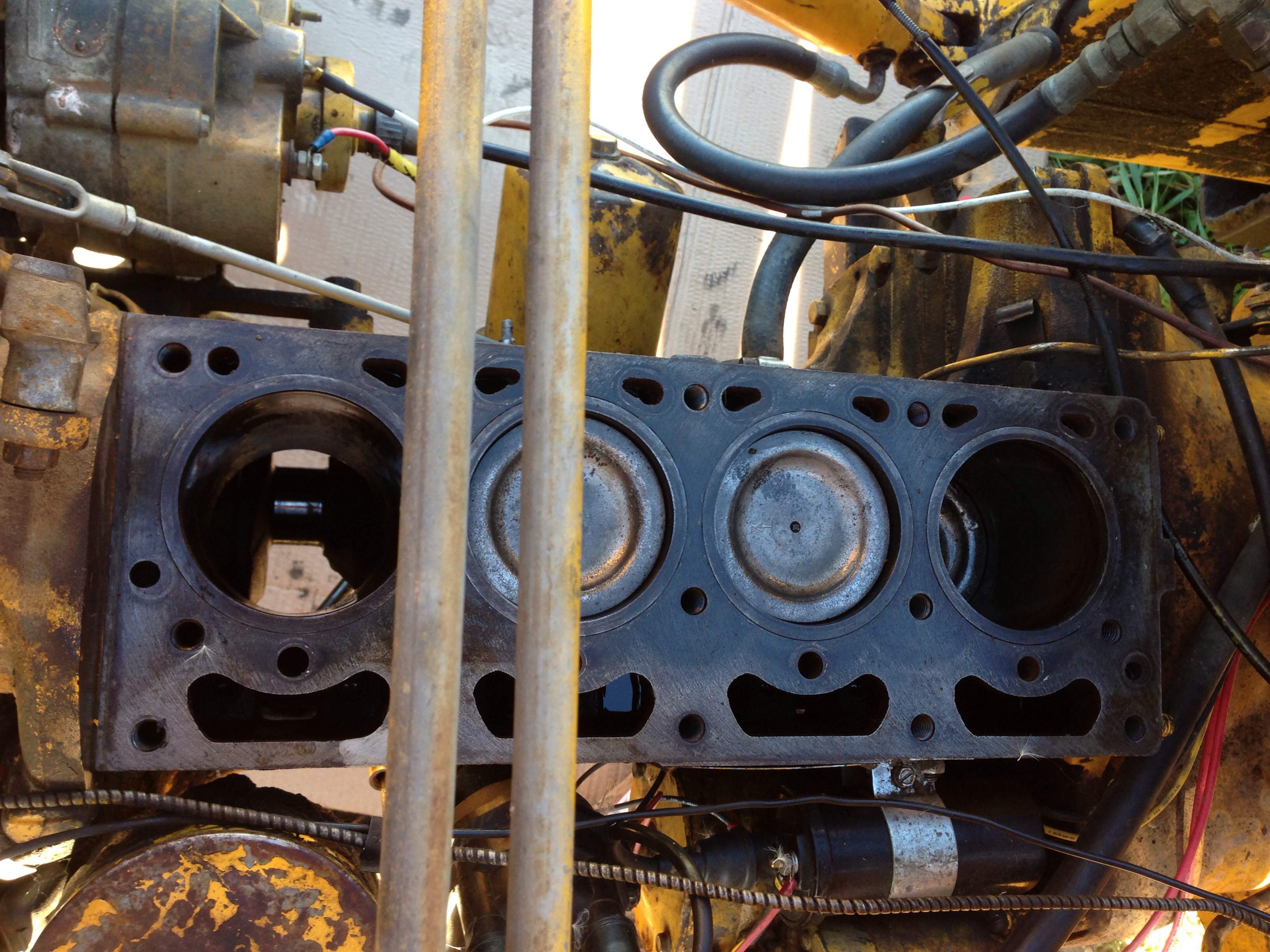

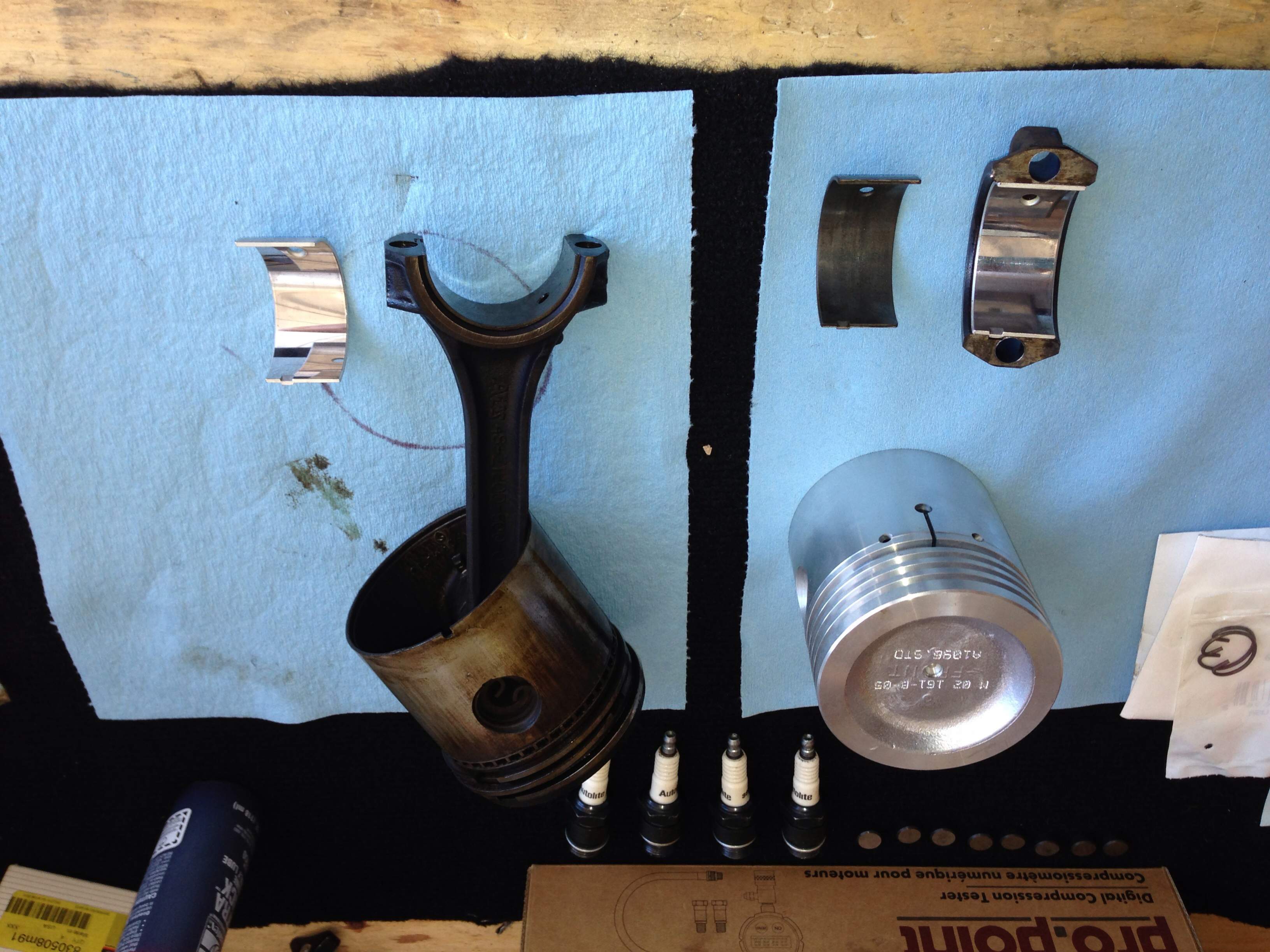

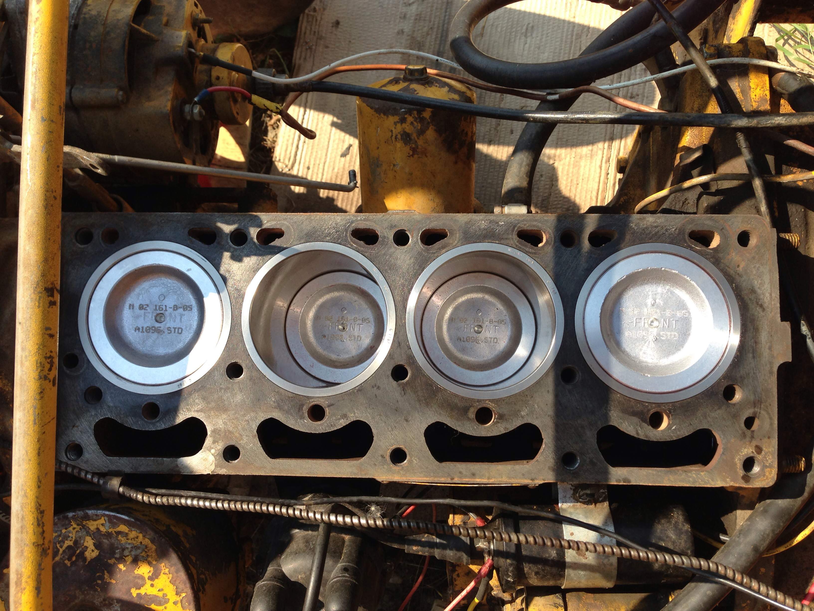

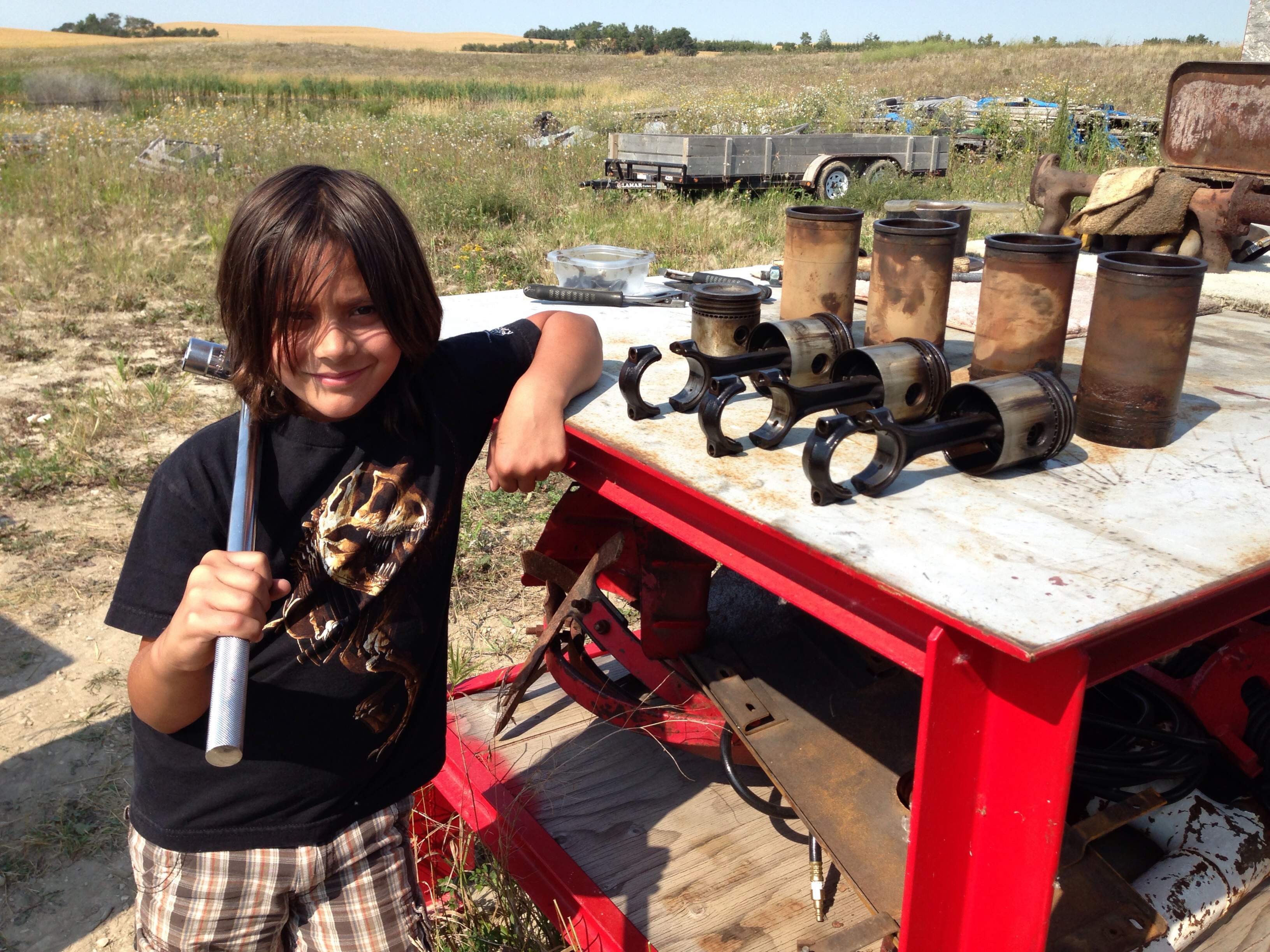

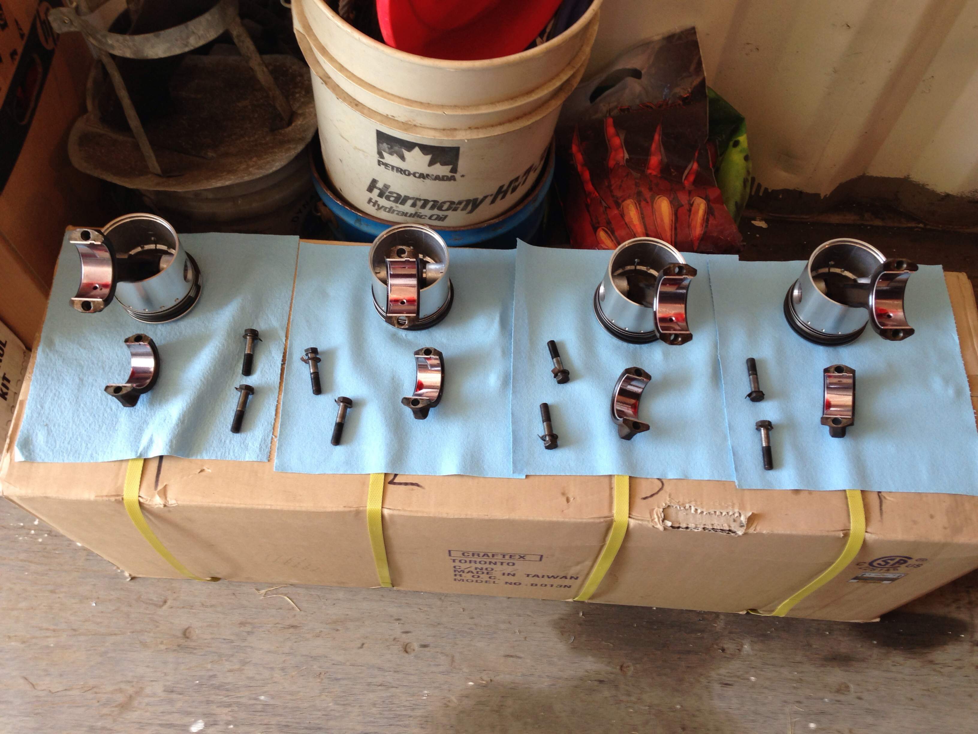

Well it has been some time and I did finish the job last fall. I figured I would finish the post with some photos in case anyone ever needed the info. I did the overhaul with my son, 10 at the time and he had fun pounding out the pistons.
Before and after
