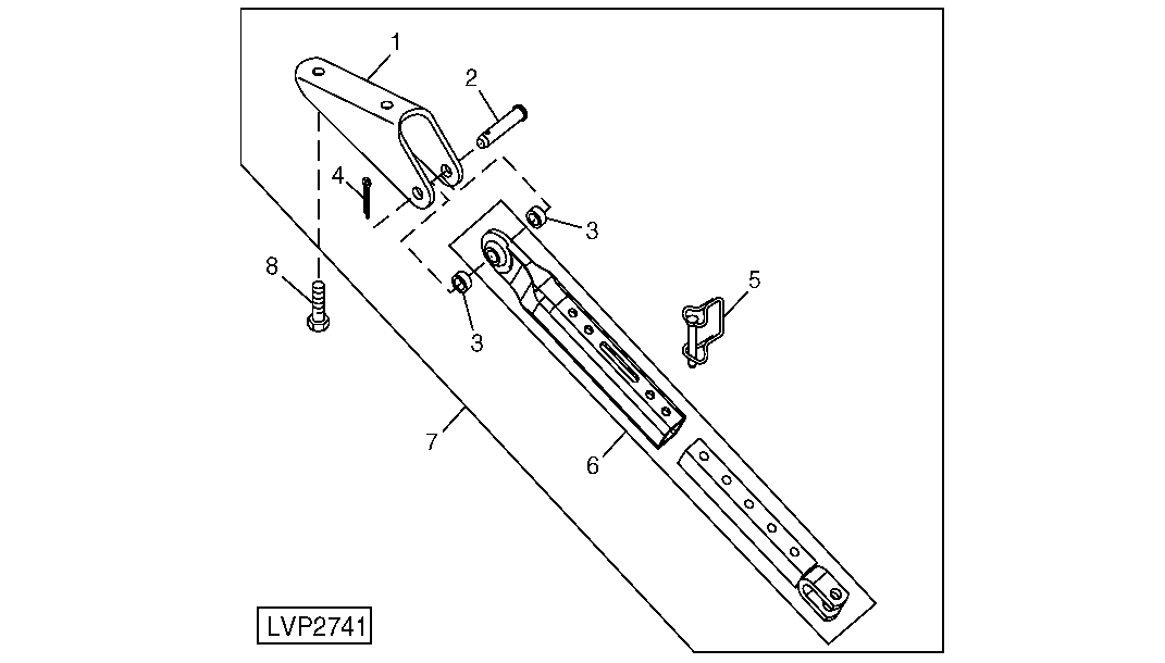

I hate the Threaded Adjustment stabilizers & wanna convert to square telescoping type like on a 5425 that you simply drop a pin in correct hole.
You guys have a link to a parts illustration ?
   / Converting 5093E 3pt hitch stabilizers to square male / female telescoping type #2
From jdparts.com
   / Converting 5093E 3pt hitch stabilizers to square male / female telescoping type #3
Looks like Zebrafive hooked you up!!!
My Kubota came with them. I converted my Ford to them using CNH's online parts listing to find a replacement.

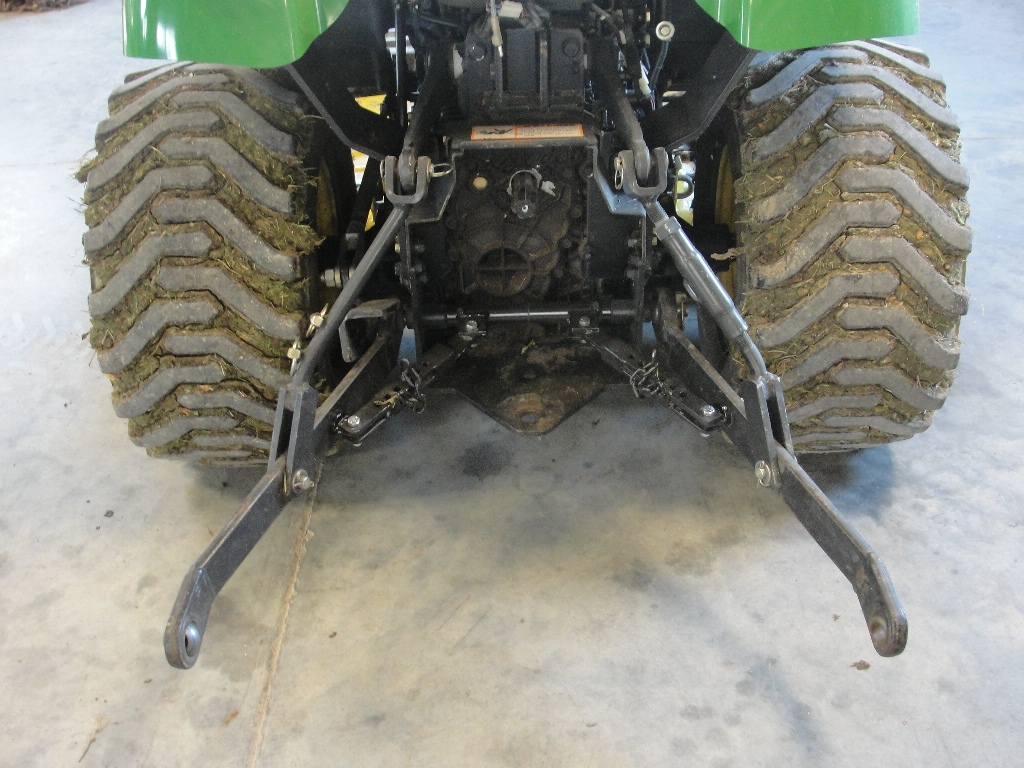

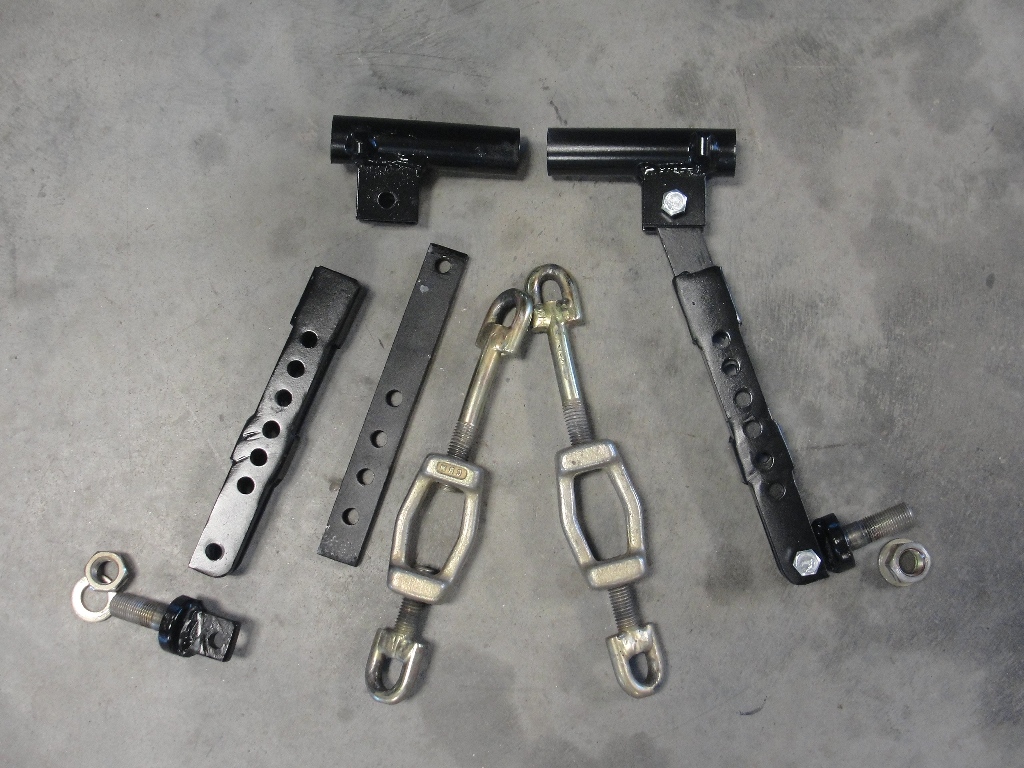

Yeah possibly. Just seems cheap to me. I run a QH on my Kubota with telescoping stabilizers and like you said, never use them. But I'd still think I got slighted if it had thread adjustable stabilizers.
I even converted my JD 2210 to telescoping stabilizers.
