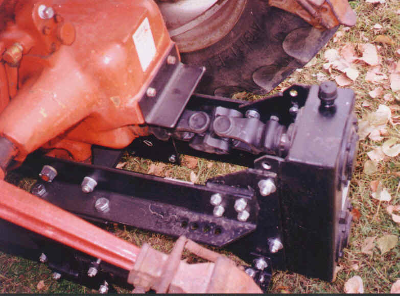

If I have time this summer, I'm going to look at converting my new blower. I'm having problems finding the thread I wanted to pass on to you. Our firewall at work isn't allowing me to follow all of the links. But I believe it was from here.
I have a habit of pulling down pictures for reference and then forgetting where I got them. Attached is a setup from a company who allows 3pt attachments on the front via a drive shaft from the rear PTO. They didn't list any TC's. I just want to purchase their 3 pt setup and fab the rest. I'll update later if I can find the link.

Picture from the front side.

Your pictures present an interesting approach and certainly eliminate driveshaft breakage concerns. Would need to remove the FEL though. Any idea what the price tag is for that unit and where it is available?? Is it a hydraulic drive for the blower? Also, as it is on a 2WD tractor I am guessing a big rear weight would be needed to have any traction at all.

1. You're sure you don't have a mid-pto on your tractor? Ok, ok, just had to ask.... /forums/images/graemlins/wink.gif
2. As you note on the link, it takes a good 25-30 hp, even a bit more, to drive a good sized snow blower like you have. Not many tractors supply that much power through the hyd pump. If they do, it builds up heat quickly, & you will probably need to add some oil coolers. Running with oil steals about 1/3 of your hp, so does your tractor run the blower with ease now, or is it sized about right? Assuming 12 gpm & about 2000# pressure, your current pump will only do about 15 hp, and at that you will heat things up fast on a constant load like an orbit motor, have power losses, etc. The orbit motor will be several hundreds of bucks. Kinda trying to say, hydraulic is not the way to go on a tractor for a high-power item. Works with skid steers, because they are narrower (smaller blower), & have a whopping big hyd pump with lots of oil cooling.....
3. The pictures in the one message showing the front mounting & the jack shaft under the tractor is pretty common, but runs about $3-5,000 for the conversion, Lots of extra work to mount them.
4. Can't much use a pto shaft to power a blower on your loader arms, as you will make a pretzel out of the pto shaft.
5. You could probably configure a ~25 hp engine & mount it all on your loader arms. Will take some work, & make your tractor very heavy up front, but you have 4wd. You'll have to get 2 engines running every time you need to blow.
6. 3pt starts to look pretty good....... /forums/images/graemlins/wink.gif
