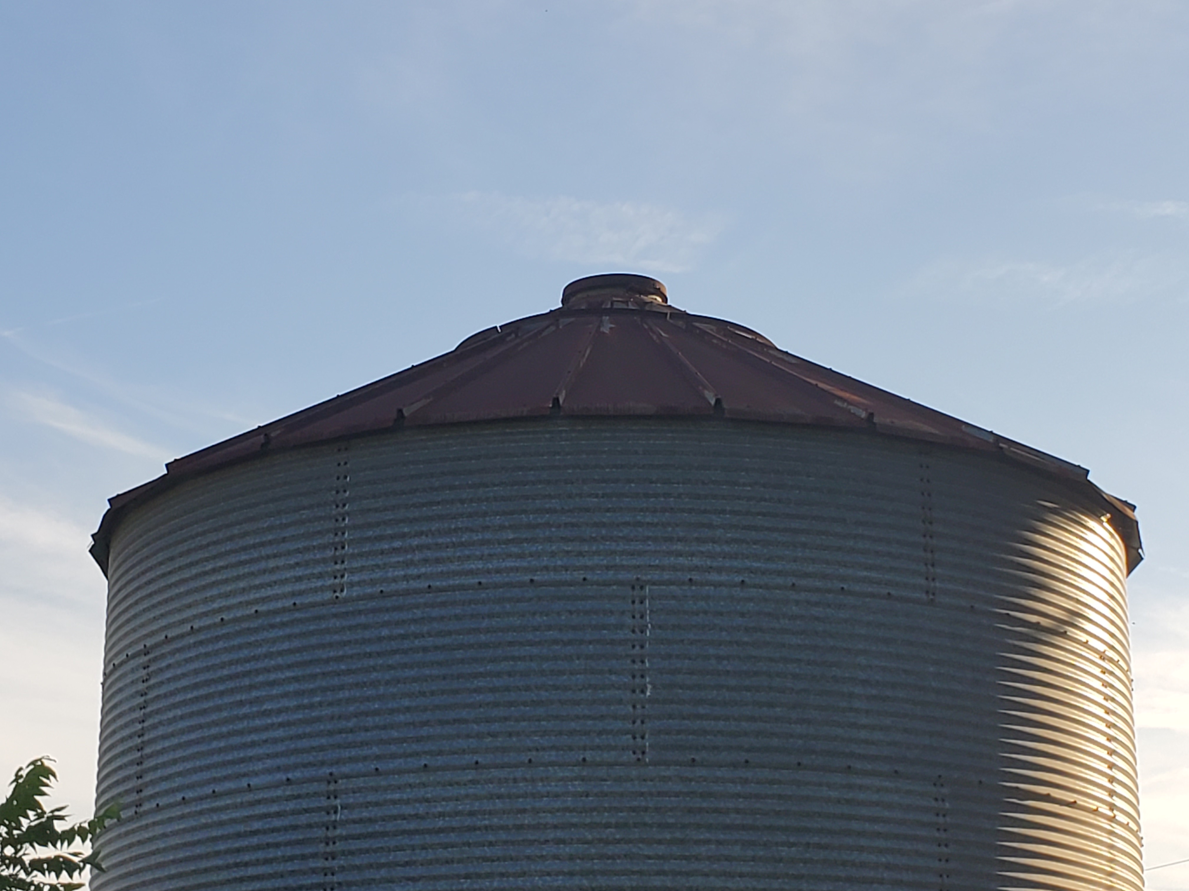

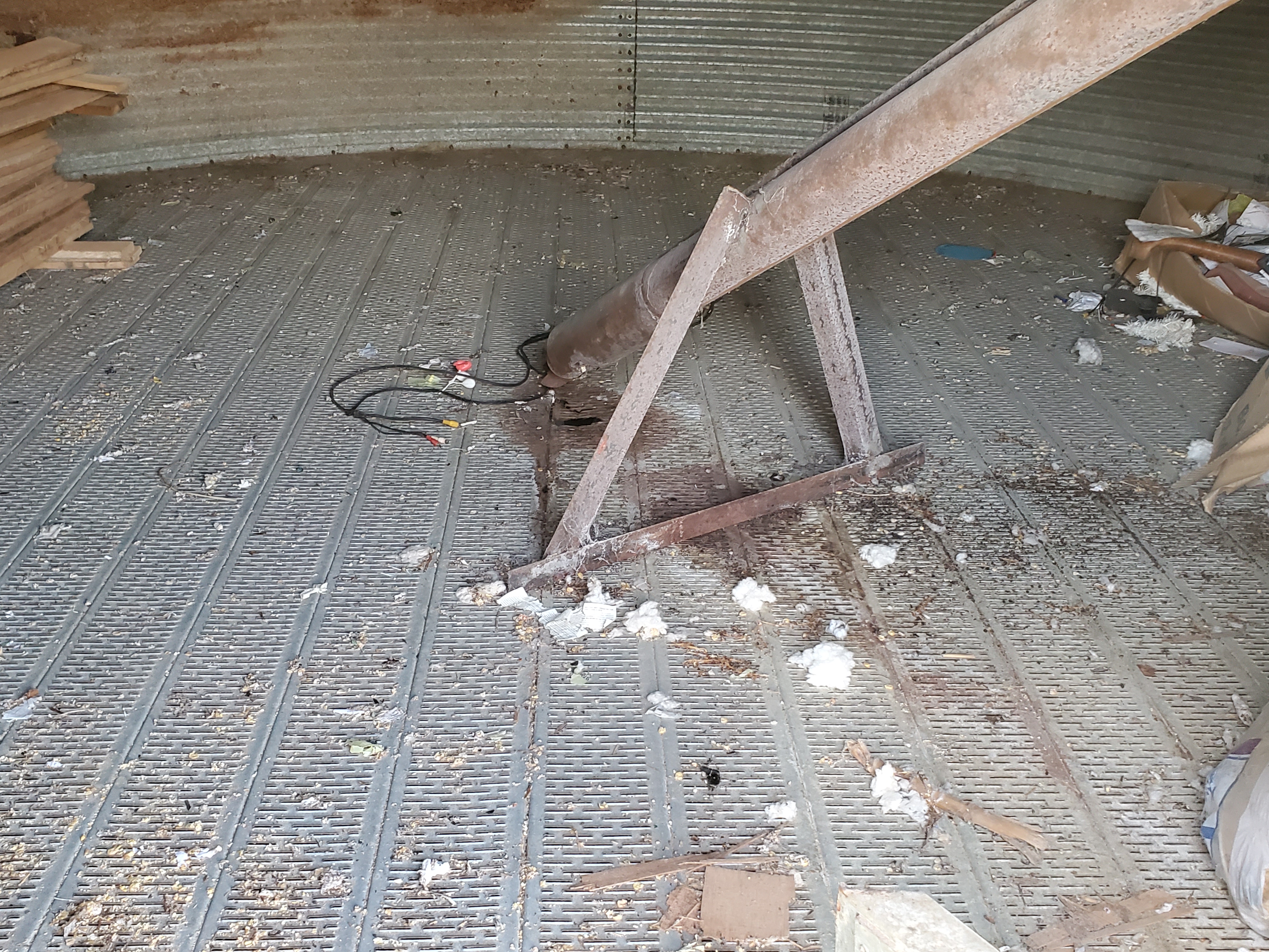

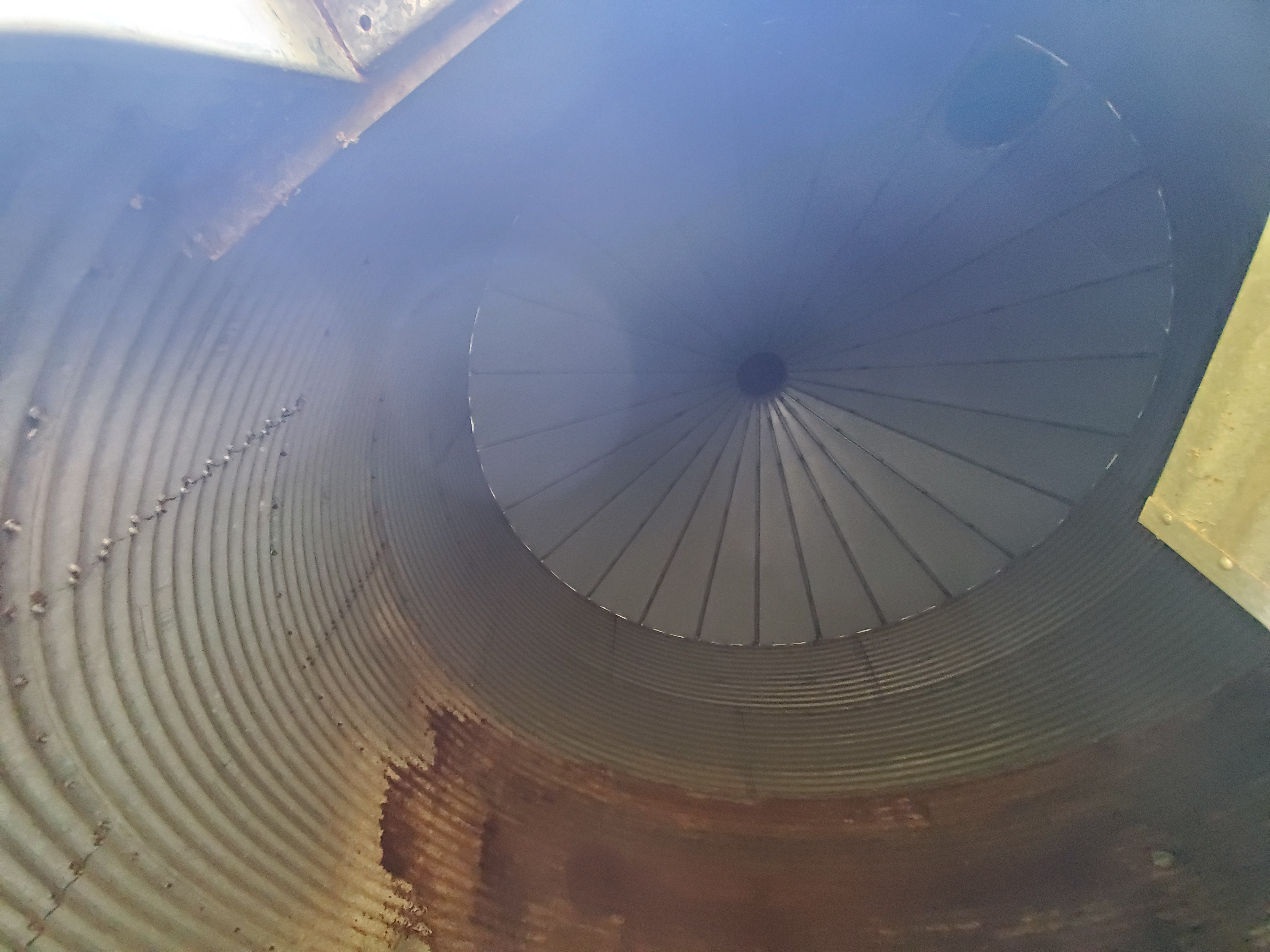

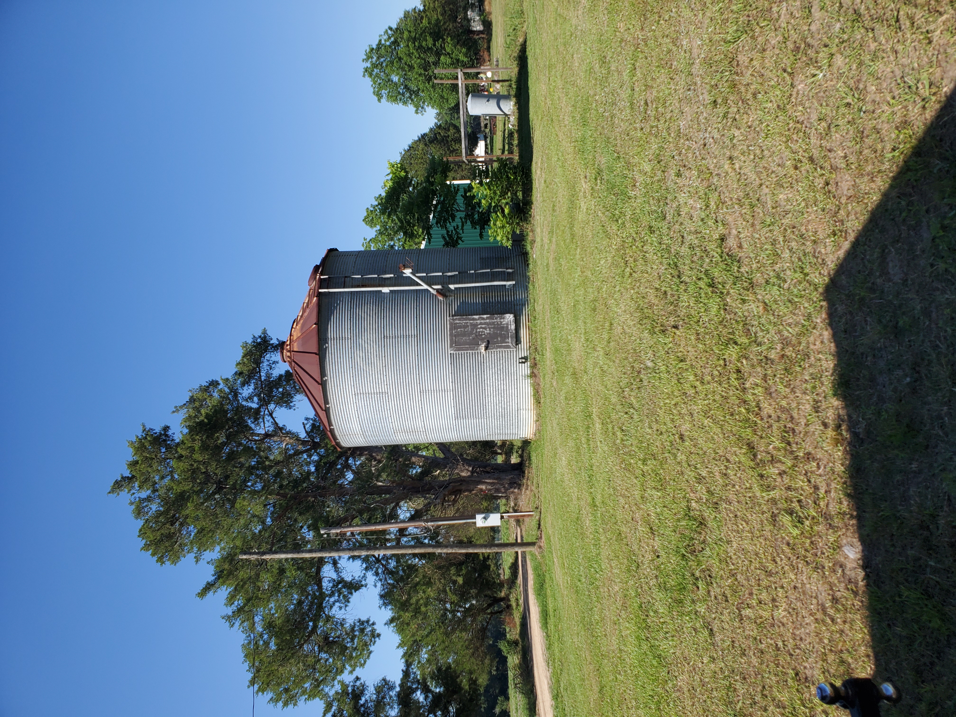

I have an old corn bin that hasn't been used in a long time. It is rusted on the inside and some on the outside, but seems to be still stable. I was debating about making it a tiny home.
But then I was thinking about just making a small cabin.
I figure the corn bin deal would cost more money, but it would be different.
The added benefit to the corn bin is that a power pool is next to it and the deep well is right behind it. The only downside is that it is less than 10' from the dirt road (but we are aiming to close the road and make it private).
The only possible thing in think the cabin would have is more room and i can build it anywhere

I would think heat would be a huge issue. A giant tin can with no windows in Georgia is bound to get mighty warm inside. How would you handle ventilation? How far below the surface in the foundation? Think about digging under it for plumbing.

I wouldn't want to be in there in a lightening storm! You might think about the ramifications of such things as mold residues from the corn, and also any varmints hanging around.

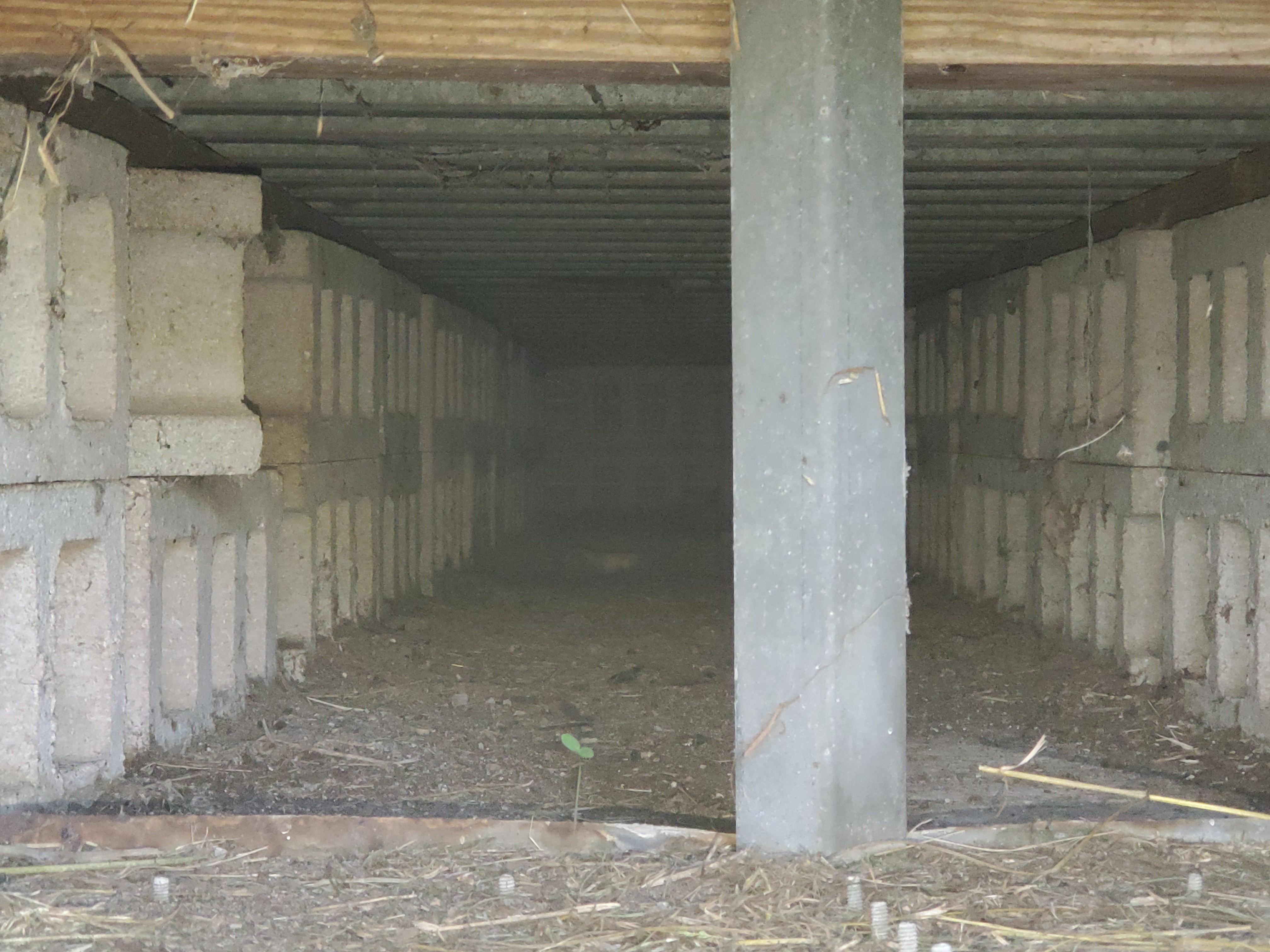

I was debating about insulating it and then build a small wall on the inside in hope it will keep the temperature maintained.
There is also space under the grate floors in it.
It may just be better to build a small cabin.
Here is the space below the floor in the corn bin.

It’s too small, too close to the road and will cost more time and money to make....everything will need to be custom made to match the curve, windows won’t look good etc. It sounds like you answered your own question.

I'd do it just for the fun of doing it. You already have a foundation, power, walls and a roof. The rest is just finish work. Just like any other metal building, you will have to build interior walls for insulation and utilities. Round walls are not very difficult to build. You just use plywood for your sill plate and top plates. Add an awning over the windows and make sure you flash them really good and there wont be any weather issues. Should be too different then any other metal building.
As for the rust, that's not too hard to treat.
How tall is it? Can you make it two stories? Have the living area with kitchen, bathroom and tv watching area downstairs and a loft upstairs for sleeping.
Insulate with fiberglass to save money, or closed cell foam to max out your R value. I would probably do closed cell foam on the ceiling and fiberglass on the walls, but I would make sure that all the metal was totally air tight first.
