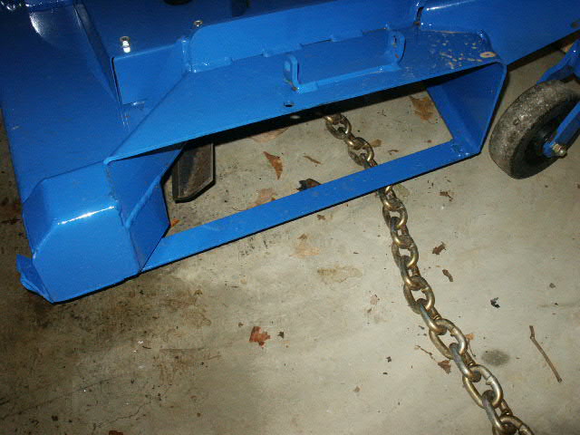

I did have little extra work performed, I had a bar welded across the bottom of my MMM deck to prevent me from scalping on uneven ground.
