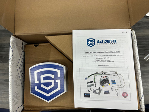

I don't know much about duramax's, but I do know there are CP4 replacements for a powerstroke. Maybe it could work for a cheby too...
DCR pump conversion. Eliminates the issues with the CP4
