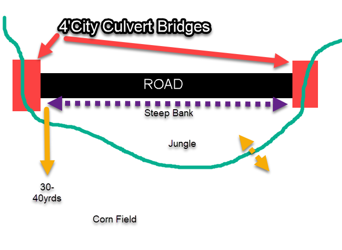

How long of a bridge would you need to get from good ground to good ground?
Creek of 3ft does not sound like much of a challenge. The city telling me I could not have a bridge of any kind on my property would incentivize me to get real creative real quick.
I would build a trailer of sorts that I could push in and pull out with the tractor at will. When they ask tell them you don’t have a bridge you have a trailer. It could be built in a way that uses a roller instead of wheel so it does not sink in the mud.

I would guess around 10' would be pretty safe most times of the year. I cut stuff like this in August usually or early fall so it tends to be drier. Not sure how that is going to go this year with all the rain.
