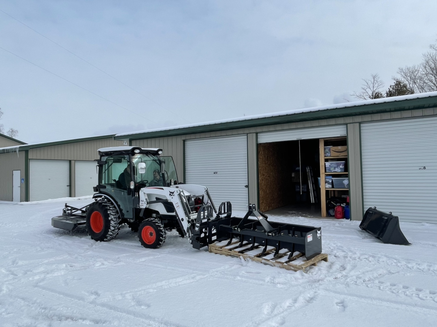

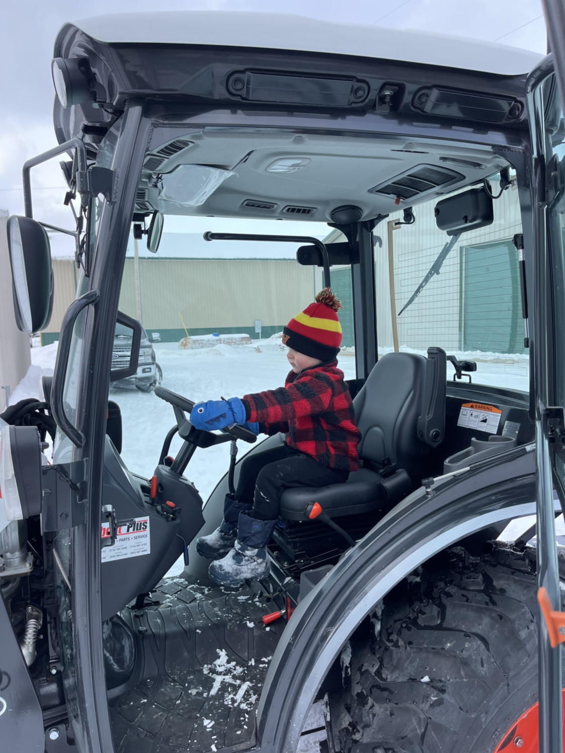

It’s been a long wait but my Bobcat CT2540 finally arrived yesterday! Pretty happy with it so far. Only problems I’m having are the work lights and dome lights aren’t working. They worked when the tractor first arrived at the dealership. I’m wondering if one of the mechanics messed stuff up when they were adding the hydraulic top link or 3rd function valves. Anyone happen to know if they share a fuse or relay that could be the issue? I couldn’t tell from the manual. I’m hoping it could be a quick fix since the dealer is almost two hours away.
I think my wife is as excited about it as I am. We put 2 hours on it just driving around the storage unit. Our 3 boys aged 3, 6, and 8 are already talking about when they’re bigger and can drive it. Can’t wait for spring to come to get our land prepped for a new home.

Nice tractor! Glad you got it and are happy with it.
