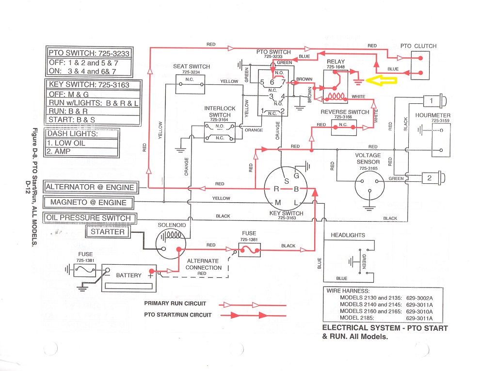

I looked over the manual in the link you were kindly provided with. It is all black and white.
Usually an original paper WSM will have color schematics showing how a particular circuit works.
Cub has the practice of sending power to say the pto clutch but they control its on and off by making the ground for the clutch.
It is very confusing unless you work on them for a living.
See yellow arrow on the page attached.
If you are having trouble understanding the wiring, then keep looking on line, say eBay for someone selling an original manual. Before buying, ask the seller to send you a photo of just one page of the wiring diagram to see if it is in color.
