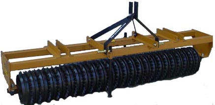

I've got a cultipacker with smooth rollers and wondering if I should have ordered one with sprocket rollers, I plant 99% small seed, clovers and alfalfa, is there really a big difference in the job they do?

The smooth rollers do a better job of firming soil. The toothed rollers do a better job of crushing dirt clods. Difference is marginal at most. 6 of one, half dozen of another.... Both will do a satisfactory job 99% of the time.

The sprokets and rollers on my cultipacker are removable. I'm guessing that's the same with yours.
So, if you're up to some disassembly, you can experiment with the two options. If you remove the sprokets you'll have to add a few rollers, which I assume you can find at your local used farm equipment place.

Mine's only the smooth rollers, the cultipacker's leinbach offers looks different than yours does, on the ones with sprockets, the rollers look "flatter"
