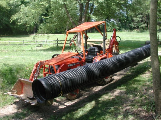

I have an area behind my garage that is used for water run off. The ground slopes down away from the garage and runoff from the road and my driveway run through this area as well. There is no water in it unless we have a downpour and then it isn’t much. I would like to fill this area in to build a wood shed that will attach to the back of my garage. I also want to place an outdoor wood furnace on this filled area.
I guess I need to place a culvert about 30’ long to accommodate the runoff and fill over it. Any ideas on an inexpensive way to do this? Is there another way to do this without using a culvert?

IF this is the case, I would not go with the flex drain pipe. I would put the 12" pipe in, with the expectation I could clean it out later if I needed to. Actually one pipe, if it were smooth inside would be kind of self cleaning anyway.
Around here (your prices may differ) it cost me, last spring, about $9 per foot for 18" black plastic, corregated outside with smooth wall interior culvert pipe. 12" might be 5$ or $6 per foot. I would go with a single, reasonable sized pipe if it were going to be in a place I could not dig up later. Especially if you are not trying to really drain a wet area, but really are just concerned with a rain run off situation.

<font color="black"> Yes that is right. Can you buy 12" flex pipe at HD? I can't find much on their web site.</font>

I don't know...the pipe I was referring to is rigid, double wall, and sold in 20' lenghts (they will sell a half length though). I got it from a local culvert pipe supplier. Even 18" by 20 feet can be moved around by one person, so it is not that heavy. It has a rubber gasket on the male end, that goes inside at the bell end, where pipe sections are joined by sliding one inside the other...not too bad to work with.
I think I have seen larger diameter (12" or larger) flex type corregated piping sold in 20' lenghts at TSC. This stuff is not double wall though, and is more like the 4" stuff that Home Depot sells, just larger...
I've attached a picture of the stuff I used...
