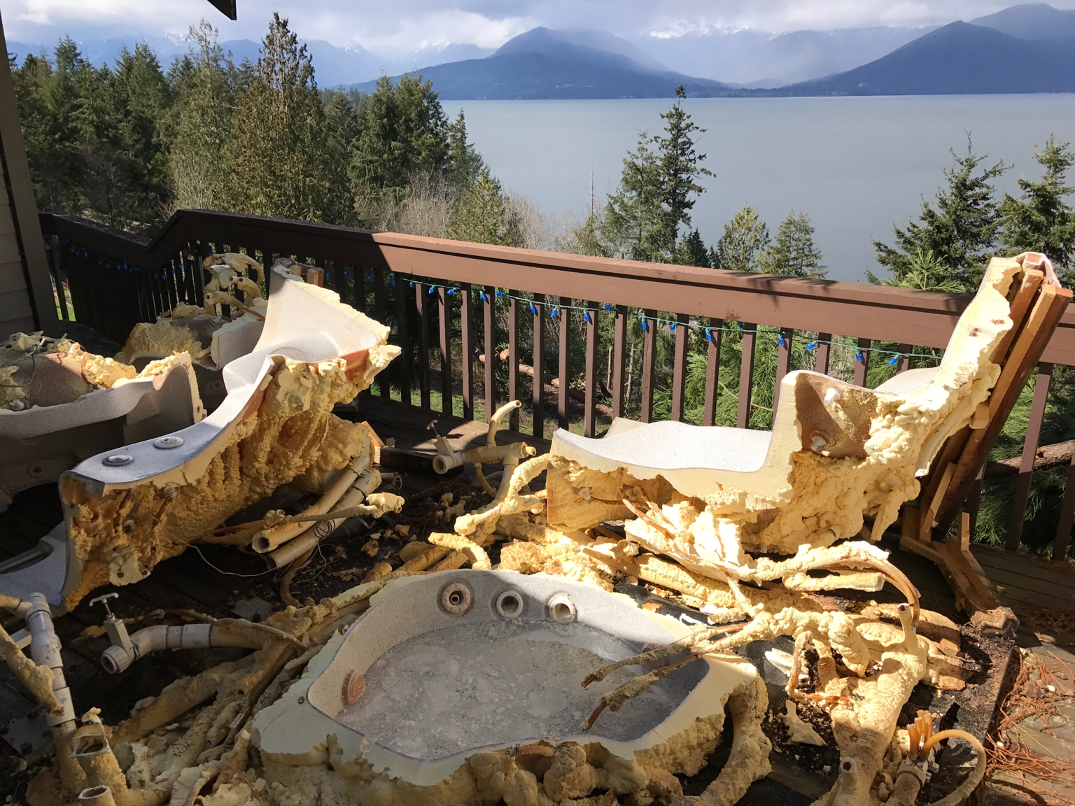

That's what I'm thinking but always nice to get a bunch of second opinions! This is moving up on my to-do list now that I can make relatively quick work of it. This will be fun! First I need to chop up my 20 year old Coleman hot tub. Thinking a chainsaw for that! Probably ought to do a video of the potential debacle.
