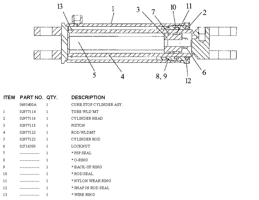

https://www.alamo-industrial.com/Pr...pring_brk-away_parts_manual__11-06__03-18.pdf
Page 20 in this parts book shows a cylinder design that I don't recall seeing ever. I assume the idea is to get additional force within a confined space.
Have you seen anything like it?
