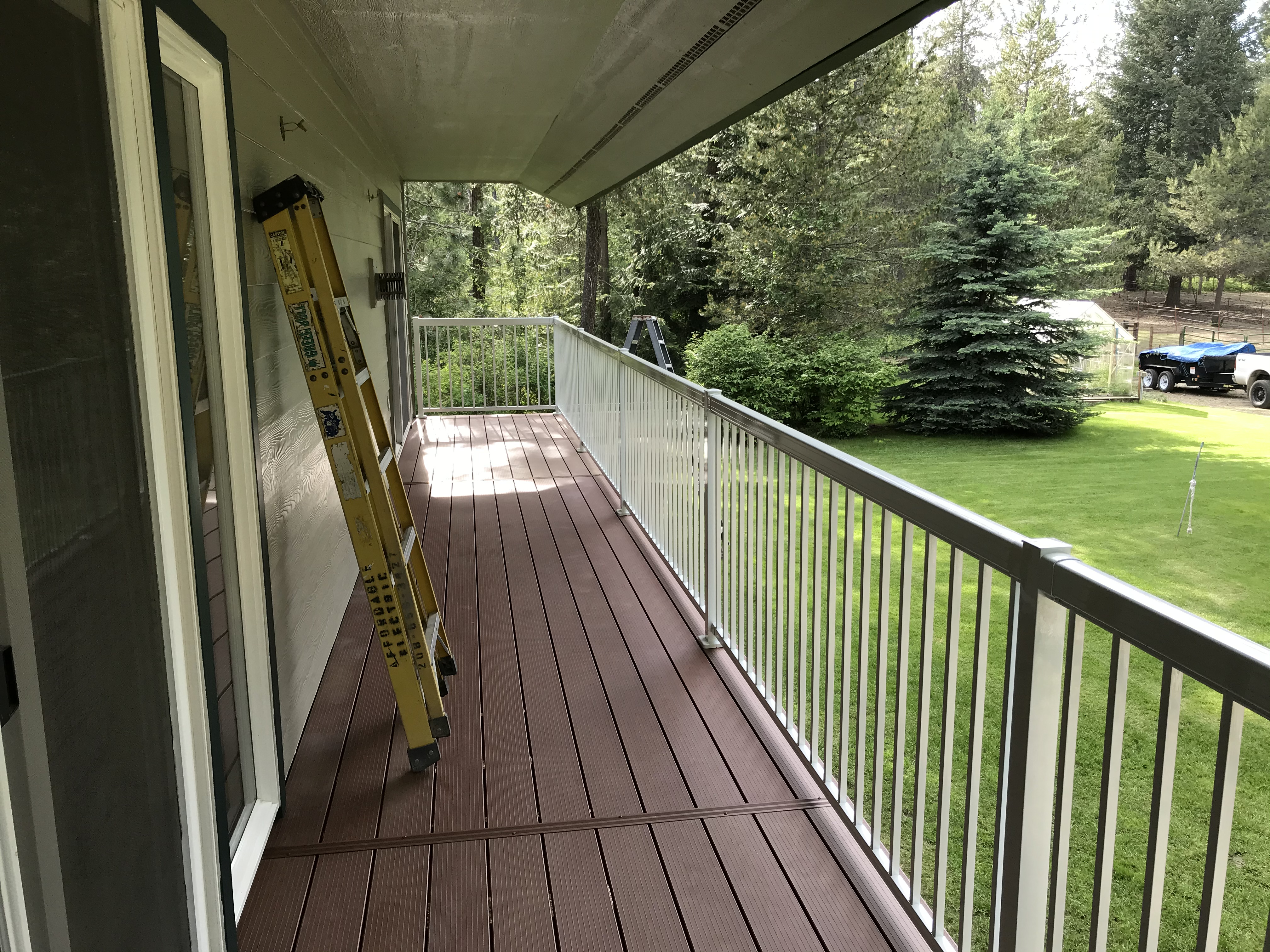

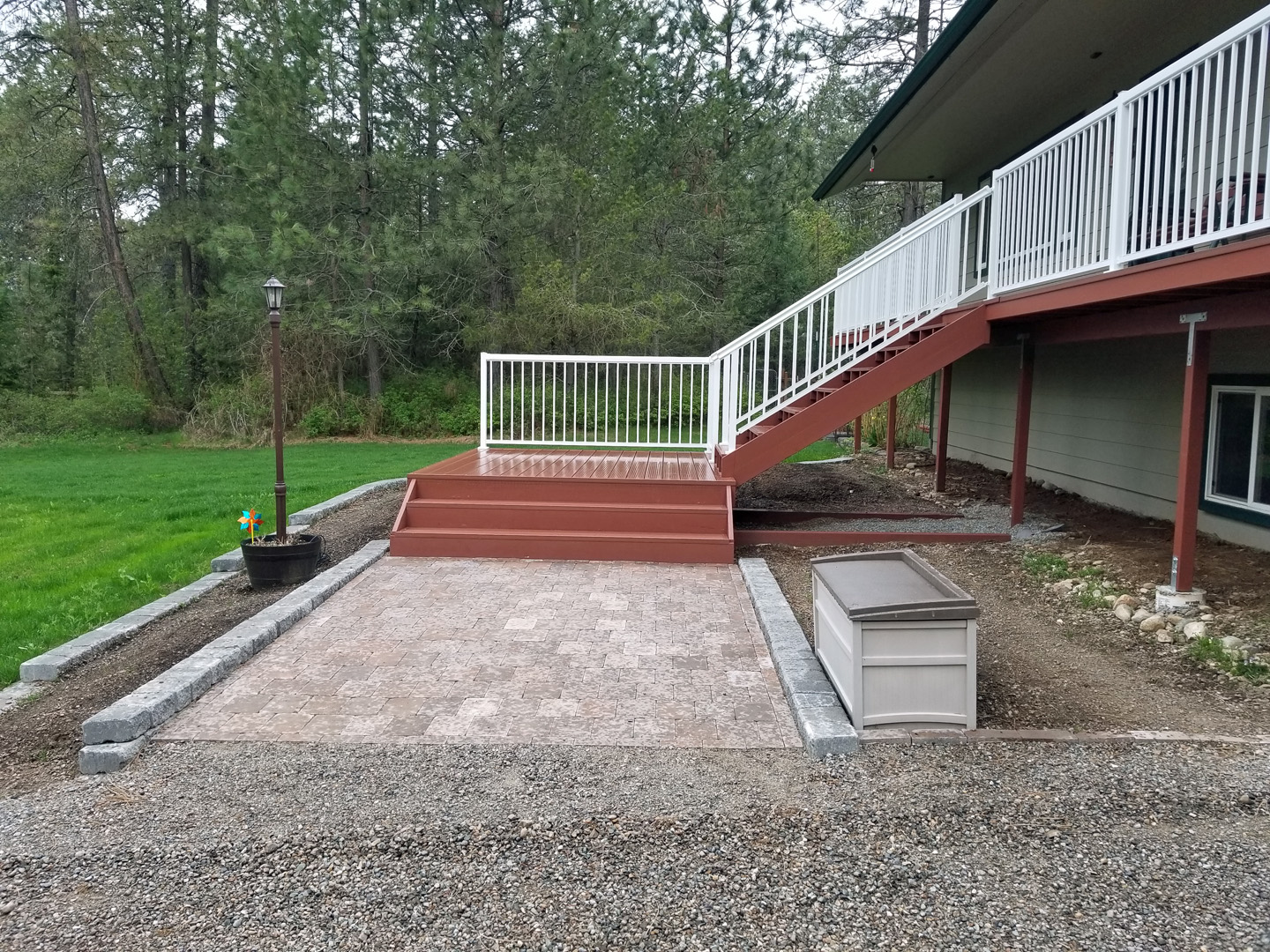

i made my forever deck using aluminum decking. Definitely not cheap, but will never do anything to it again except pressure wash.
and it can be blazing hot, lake last months 106°, and i can walk on the deck barefooted.
