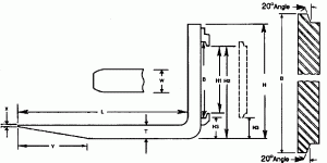

hello. does anyone have or know if the deere worksite pro pallet forks use standard ita class II (16 inch hook spacing) forklift forks? or do all major brand skid steer pallet forks use standard forklift forks/tines? thanks in advance for any responses, and please have a safe and happy holiday everyone.

hello. good morning. the 'B' height should be the easiest to get as you should be able to measure the outside of the rails. If it is easy to get the 'h1' distance (without taking off a fork... its not worth the effort) that would be great also. thanks a lot:thumbsup: btw I got the service manual for the 110 if you ever need anything. :)

The rails are spaced 16 inches apart outside to outside, The inside to inside measurement of the upper and lower hooks (B) is about 16 5/8 inches the rear of the hooks are almost 7/8" long. That would appear to be h1 for 14 7/8". It appears to me when fully hooked on the upper rail that the lower hook only has about 1/4" holding it in place.

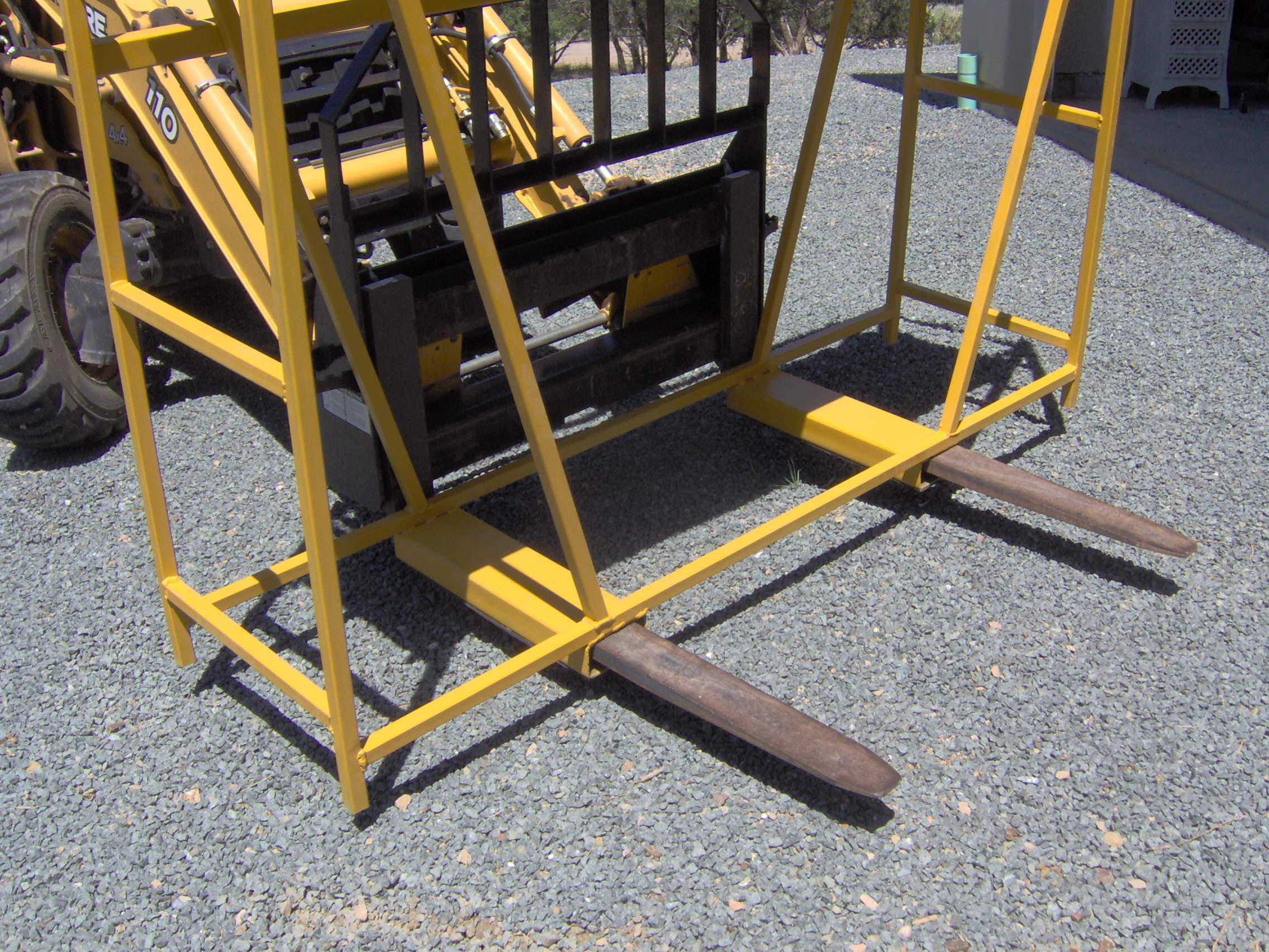

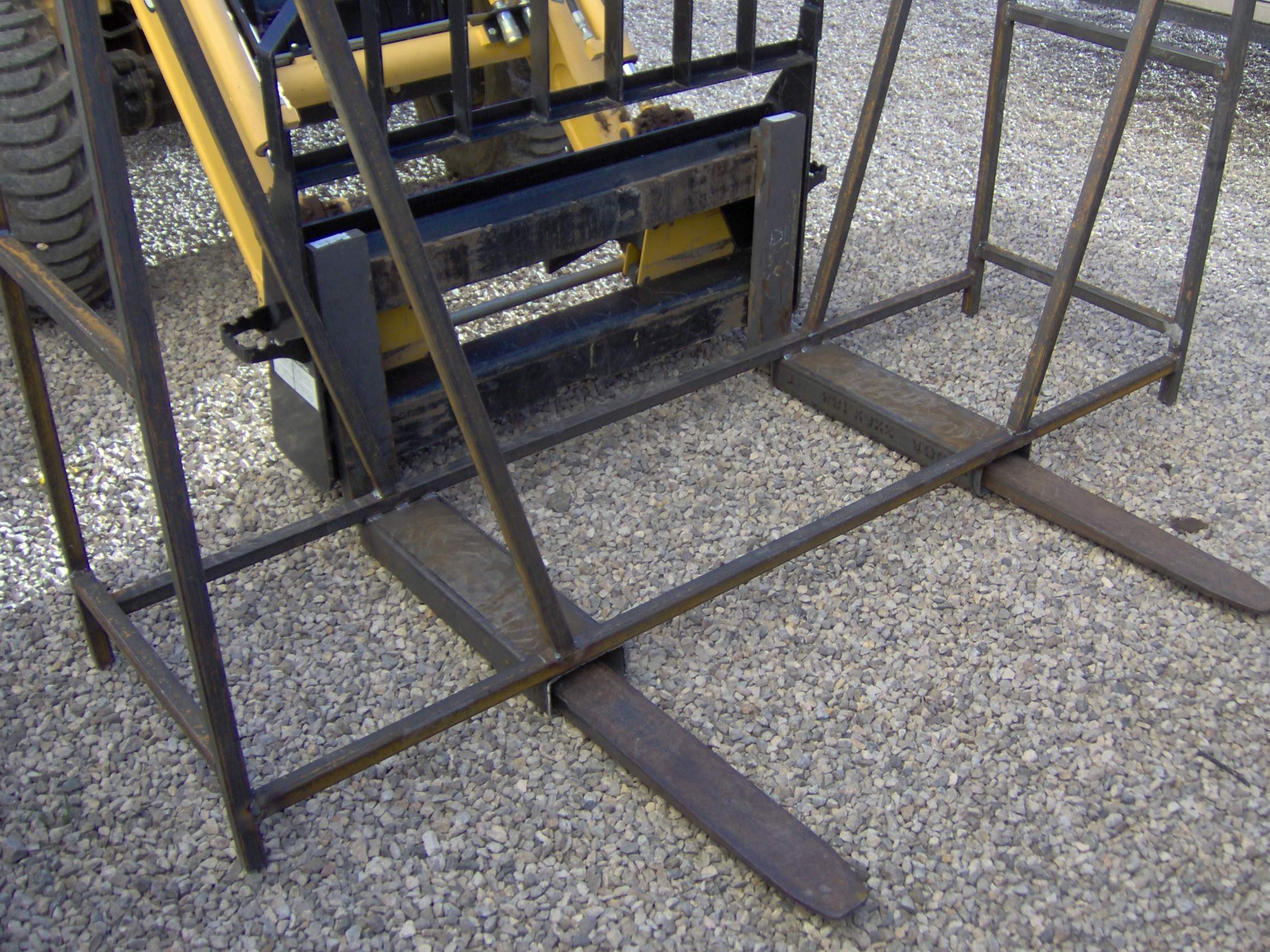

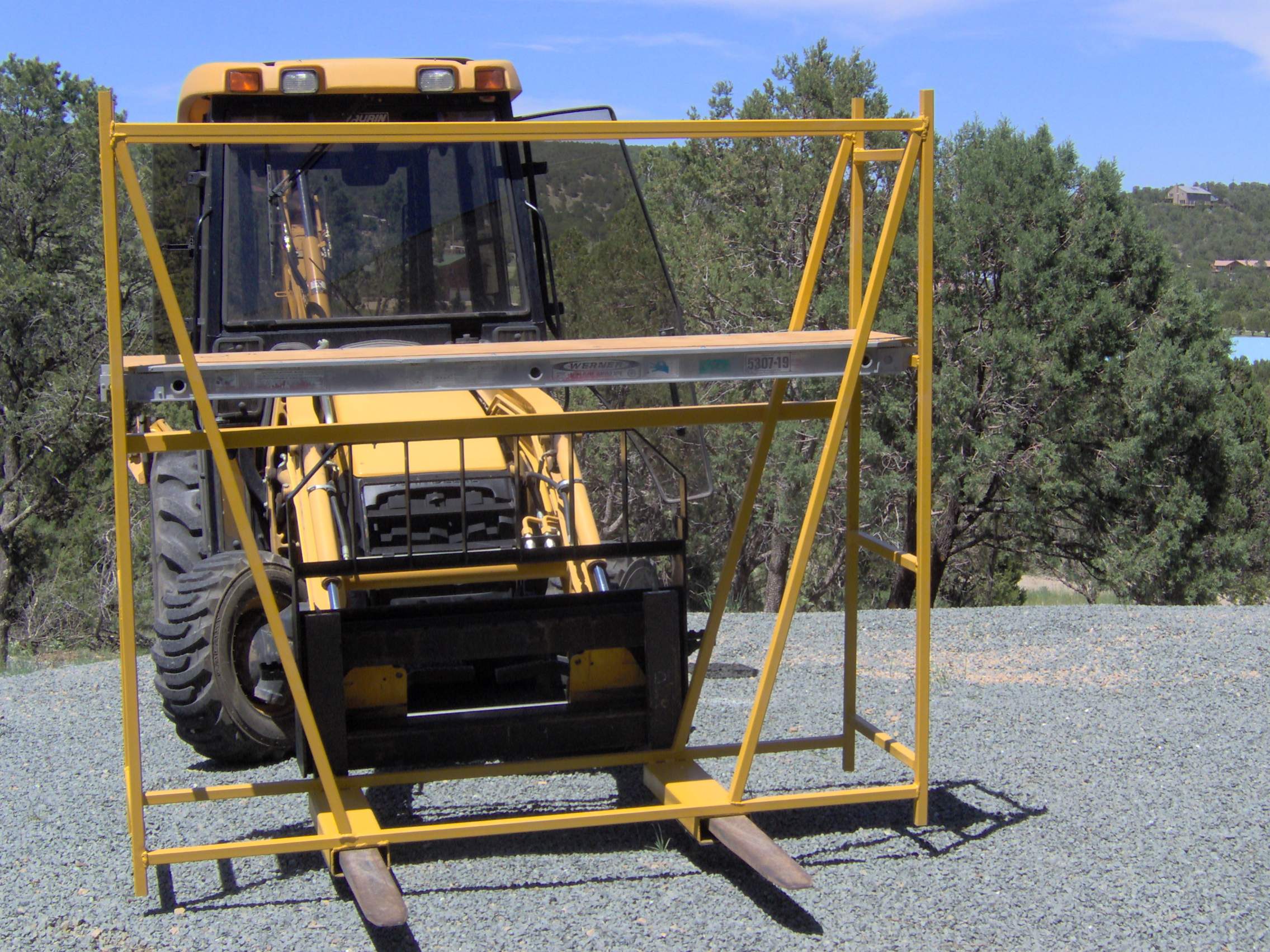

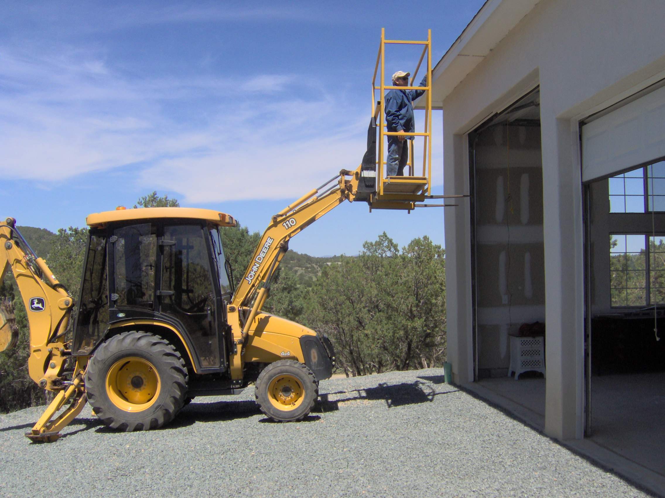

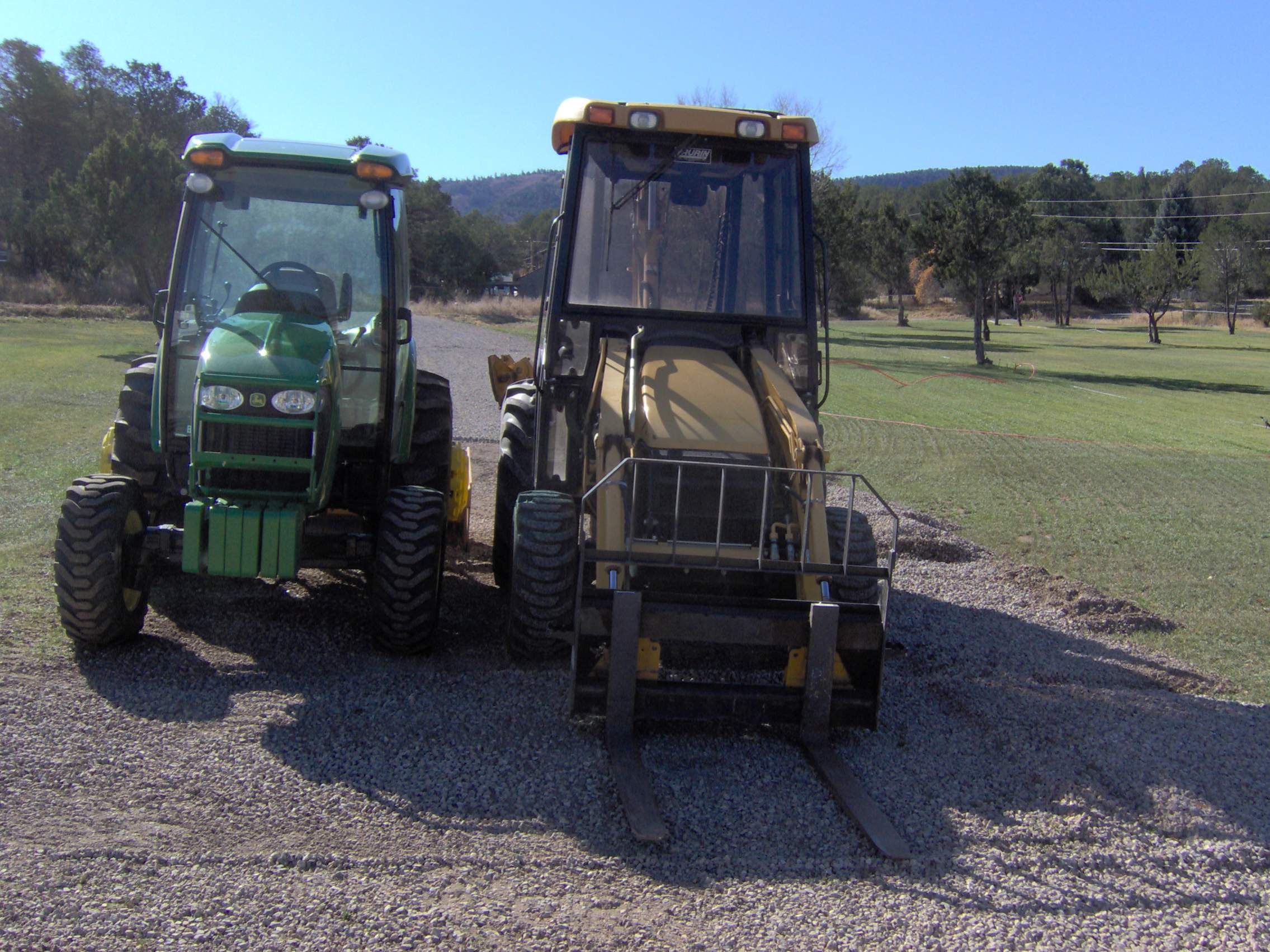

I bought these pallet forks with the 110 in Jan. of 2005 and have had zero problems with them as I would expect since this ian't a complex tool. Heres some pictures and also an add on scaffold attachment that attaches to the forks for higher work. When I built the scaffold attachment I also made a top handrail that can socket on top if you are using the top scaffold position but don't have pictures on this computer.

I believe most skid steer forks are class 2.
