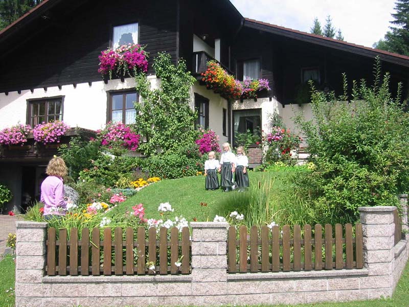

Atached is a picture of siding only treated with diesel/motor oil...
It's standard procedure for the last 80 or so years in this alpine area...
Most of the residents live to ripe old ages... cancer incidence is very low.
