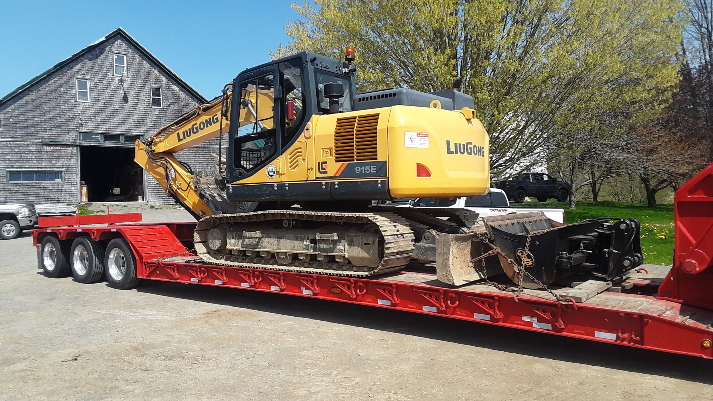

Well I've finally entered into the modern world
(tier 4 final) with my equipment. Hearing plenty of fuel related horror stories I'm wondering to what filtering efforts is necessary beyond the basic screw on type filters that I've been using forever?
Of course the machine has its filters that should suffice, but a 80 gallon xfer tank might be subject to condensation especially if there's a possibility that it could be idle for a month or so or even longer over the winter.
I may just be a little paranoid, but this is my biggest equipment expenditure yet.
It's got a Cummins with DEF and a big SS exhaust magic box thingie!

Nice! Is that a 15 ton machine? Very handy with the clean-up bucket and wrist!
At work we have the filters on the transfer tank pumps with clear water separators. I believe the filter elements have a desiccant in them as well. As always, proper maintenance is key, and ours are woefully under maintained.
And just like the machine tanks, the tanks will rust less and build less moisture when kept full.

18 ton there crashz.
Big enough to make a big mess! 🄳
