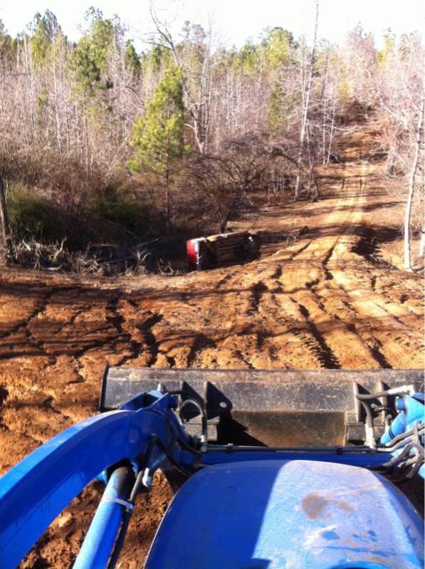

Truck and tractor

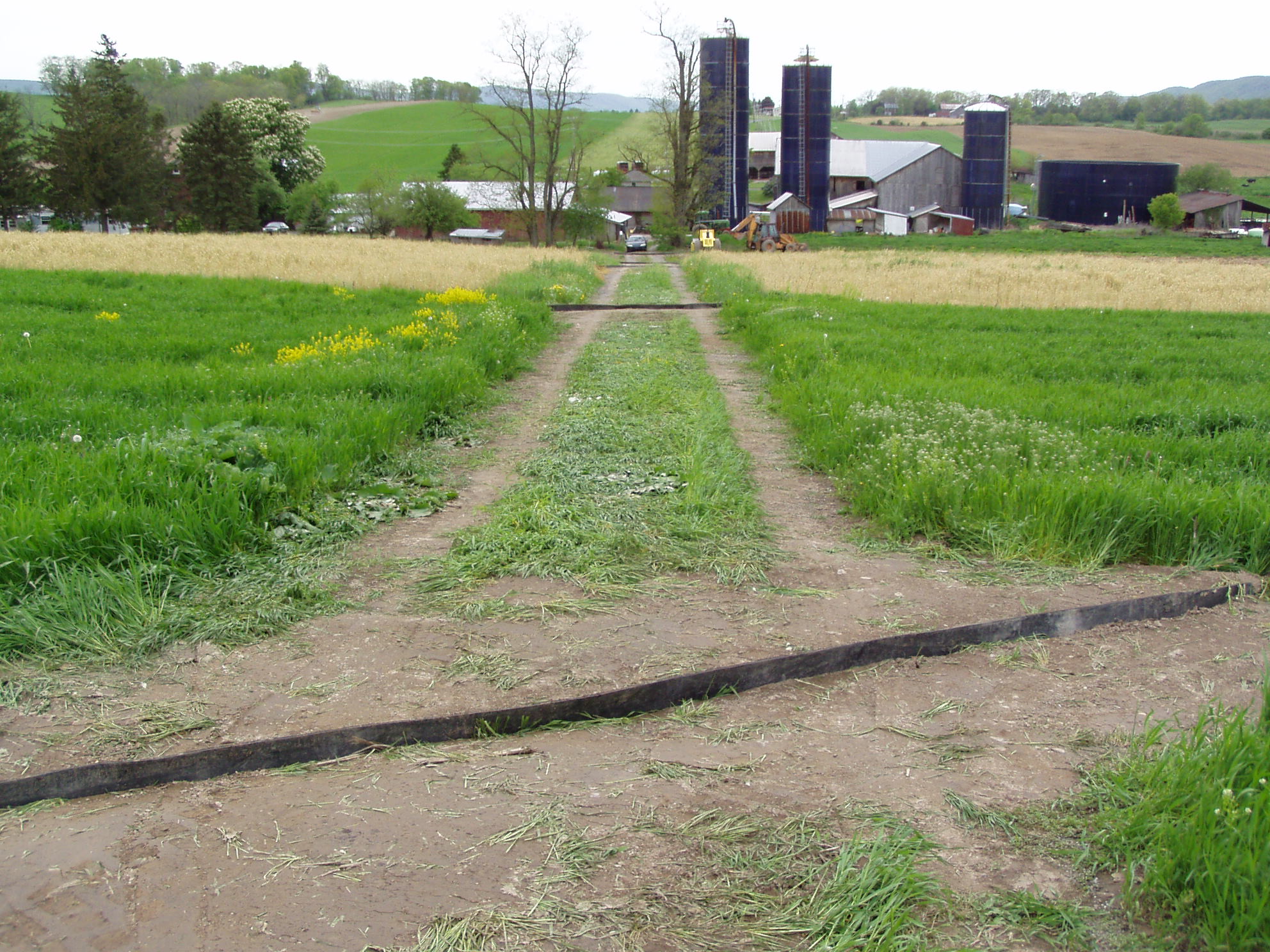

Wow, that road needs some preventative maintenance. I've uploaded two PDF files (hopefully) that show how to install some simple diversion bars made from used conveyor belts that you can pick up at a quarry. I've designed these to be installed on field roads for farmers. I'm an engineer, not a contractor so I can't give you specifics on the actual installation, but it is fairly simple. You can probably dig the channel with your bucket if the soil is loose enough. The beauty of this system is that the conveyor belt will flex down when you drive over it or scrape over it with a blade. Very nice for northern driveways where we have to deal with snow. They work well to divert the water off of the barren road, where the water creates channels and erodes the soil. Note the spacing table on the first sheet.

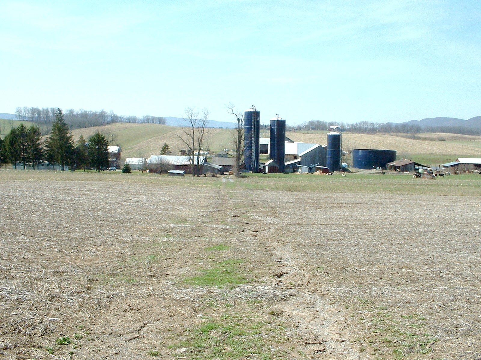

Thanks for the welcome. I've been getting info on this site for some time, but recently joined. I posted two pics of a farm field lane done a few years ago below. Here is a link to a gallery showing a few more pictures:
