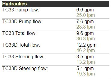

Have you considered lane shark?
   / Ditch Bank Mower for a TC33D
#9
Im googling lane shark now...................
Ok, you have my attention.......
It appears the mower is hydro powered, although it is not clear to me how. And I am also not sure how to use my rear remotes to power this besides bring a hydro line up to the loader and lock my remote lever forward.
It is nearly double the price of the mowers I am looking at, but I would rather support a FL manufacturer rather than the Chi-Coms. I wonder if they have a combat vet discount or something that could help me bridge the gap.

The more I look at this, I think the more I need to call them. My loader is actually pre plumbed with hydro lines out to my SSQA.
