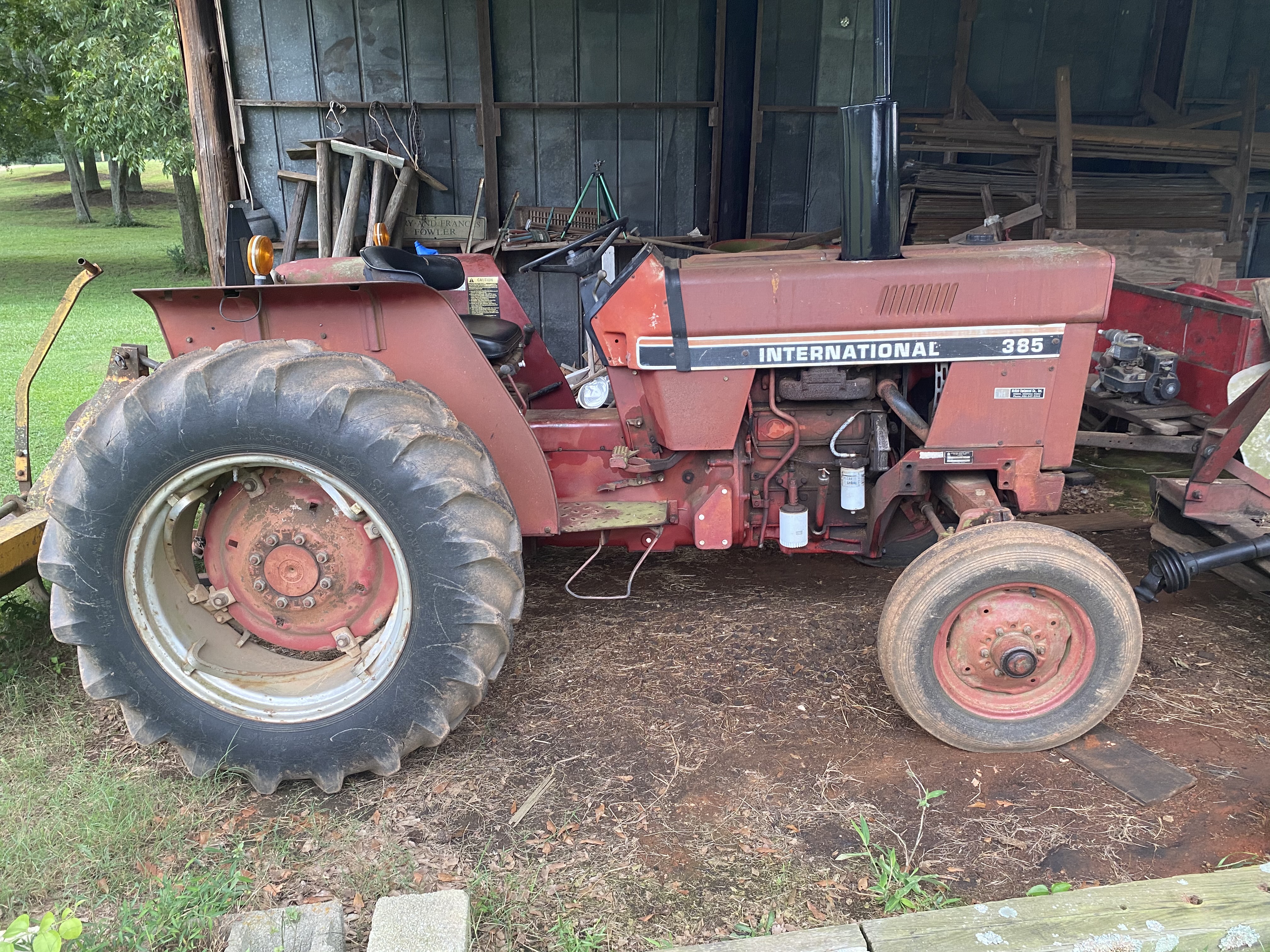

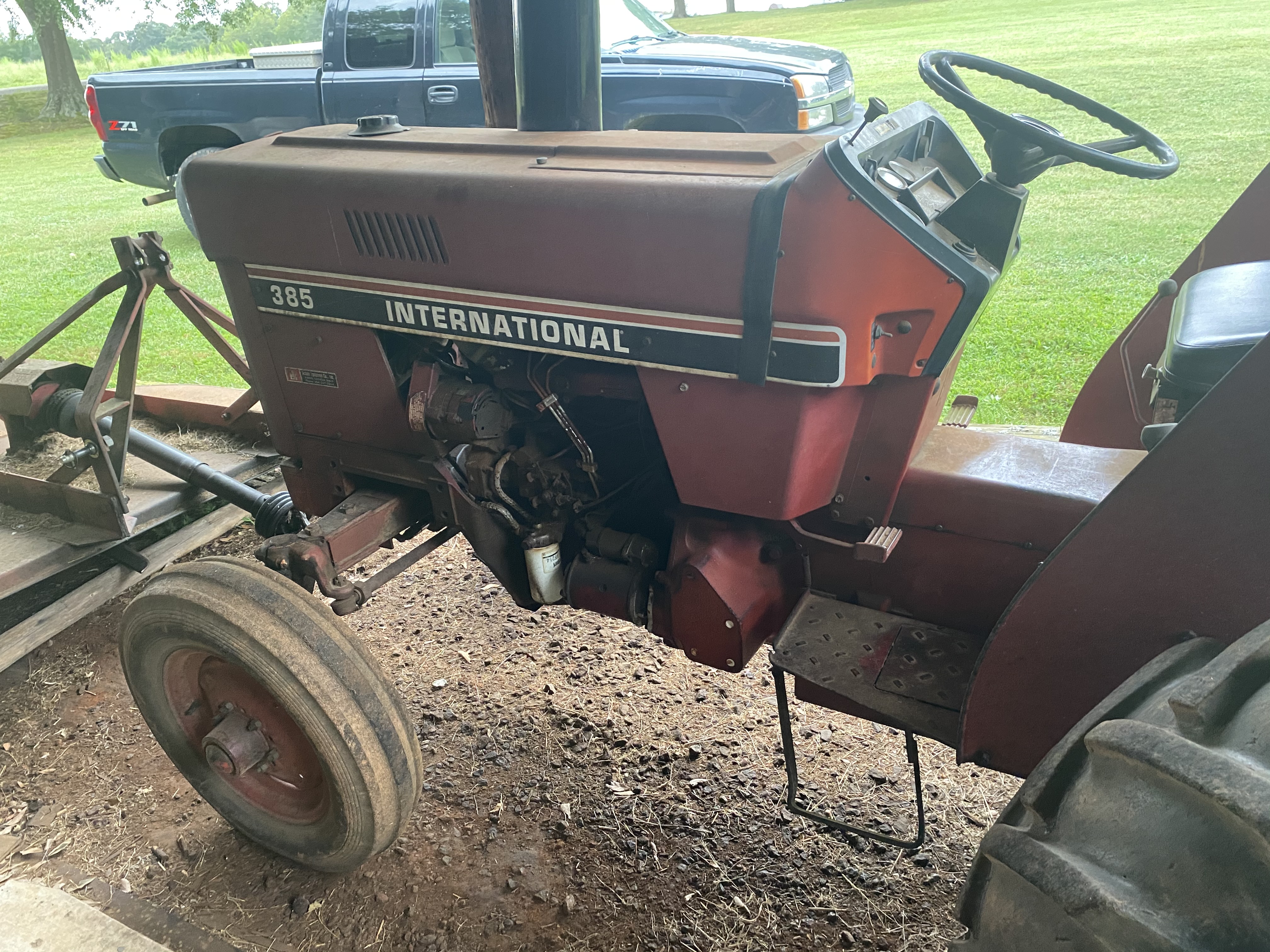

I know it has been a while since posting about this, but I wanted to post a few pictures of the tractor. They are attached to this post.
This tractor has my heart, y'all. It is my grandfather's (who, by the way, just turned 88, and still uses it often). He bought it brand new in 1985. It only has 1830-something hours on it. It runs like a charm. It cranks up with hardly a turn of the switch. It idles, revs up, and runs without any smoke; the hand and foot throttles are both very responsive. The only thing it needs, as I said, is some cleaning and paint. It has been well maintained its entire life, and has never been left out in the weather. I hope to make this a small project of mine over the next few years. My father and I just replaced the original fan and alternator belt today! The next immediate thing it needs is new front tires. (All the tires are original from 1985.)

   / DIY Tractor Cleanup TIps #7
Nice old heavy iron. It will outlast you. I see it has spin-out rear wheels. Should you ever go to adjust them be prepared for a ride. :)
   / DIY Tractor Cleanup TIps #8
Nice machine. Probably the best row crop cultivating tractor that has ever been made. We had a stable of them, 364, 385, 656, 1066, 1466 and probably a dozen Farmall 140s.
