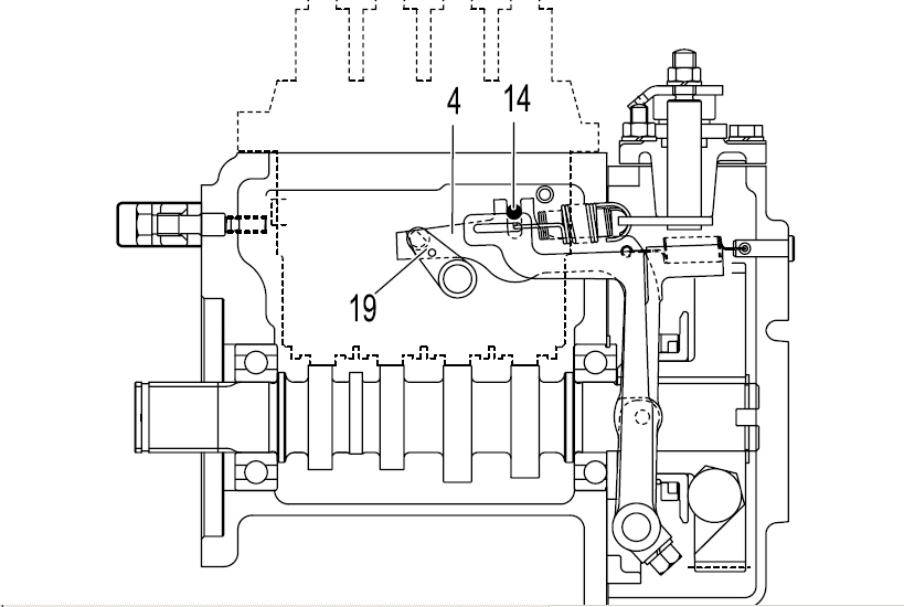

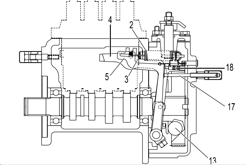

   / DK40 cranking but not starting #9
The fuel feed pump is a low pressure pump that pulls fuel from the tank and sends it to the injection pump.
Yours is mechanical. Some are electric. If it's failed your engine would not start. Seems unlikely given the symptoms of running fine until being shut down. But your test to check for fuel flowing would check it. Is there a troubleshooting section of the manual?
Your filter seems to have an automatic air return to the tank. On my tractors there's been a manual air bleed screw. Air in the fuel system would cause the tractor to not run, or run poorly if it's in only one or two cylinder lines.
   / DK40 cranking but not starting #10
This situation will turn out to be something simple. Don't go tearing things apart looking for ghosts as you will cause far more problems than you solve.
Last page in the engine manual. Lever 19. Make certain it is moving in the Off and On positions. Cables have been known to slip and then not push lever 19 to the On position.
The mechanical lift pump on your tractor may be there to deal with low fuel levels in the fuel tank and going up or down hills. In all other circumstances, gravity delivers fuel to the injection pump.
Is part of your fuel tank above the level of the injection pump?
It may be that your fuel level was marginal for needing the lift pump with fuel sloshing around and getting sucked up. Once you stopped the tractor the level became to low to get a re start.
There is usually a lever or button on the lift pump to allow you to operate it manually to prime the filer and lines up to the injection pump.
Fill the fuel tank completely. Remove the intake line at the injection pump and see if a steady flow of fuel comes out just sitting with no cranking. If no fuel comes out, see if there is a manual way to operate the lift pump. If there is, then pump and see if now fuel comes out the line feeding the injection pump.
If there is fuel to the injection pump, then either lever 19 is not in the correct position or your system is full of air and needs to be bleed.
It is not a safety switch problem as the engine is cranking. Further, lever 19 is manually operated not controlled by an engine stop solenoid. This is not electrical!
