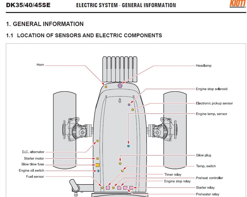

I try not to be a parts thrower, but I know the DK SE series was plagued with starter relay troubles, including mine. A quick $15 try, as the relay is standard type. See pic below for location
