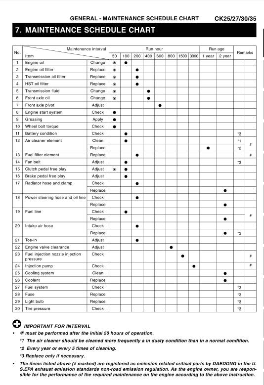

My wife packed up a bunch of "papers" somewhere into storage when we moved our computer desk to make room for my daughter's bedroom and my owners manual was in it. Does anyone still have their manual handy that could give me the intervals and requirements for the first 2 or 3 services after the 50 hour, I think I remember a 400 hour service but can't remember if there's one before that, and I assume the 400 is all the filters and hydraulic fluid but can't remember
   / Dk50se hydro anyone have a owners manual #2
Please find attached a maintenance schedule for most of the tractors in the Kioti lineup. Even the Kubota tractors have a maintenance schedule that looks like this. Save it to your phone, so you always have it. Kioti%20Maintenance%20Schedule.jpg

Thanks but I'd prefer to have the info from my series and model tractor not the ck

Now you have a link to the manual on my server: The information you seek is on 9-2 and 9-3

Thanks I appreciate it, I took a screen shot just in case, pretty much what I was suspecting though I don't know why one would change the oil every 100 and not the filter, I been doing that every year even if I don't get the hours
Agreed... Oil and filter together. Oil filter is one of the easiest maintenance things to do on the tractor.. And it is about the cheapest filter too. So why not.
