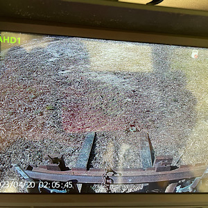

Wanted a front camera to be better able to ”see over“ the front attacment. Rear one to look at whats going on behind without having to turn around.
7” display worked great on a factory bracket. The cameras, I enlarged their mounting bracket holes to fit over the roof studs. Just enough spots and wriggle room to run cables without drilling cab. Split screen or full screen, not too bad for $90 and about an hour and a half. red circle is lift arm ends, green arrows are tires. If anyone knows how to get the stupid vent knob off……Part of why it took so long, I ended up pulling the screen and knob through the headliner(gently).

Not sure, that was part of the intention. My forks weren’t here when I did this. When I get them on the tractor, I will see if I need to relocate.

I think I made the view better. Mounted camera to the grille guard. Much better view (IMO) of the qa plate and forks

Yep, delivered to the front porch by Amazon. Wanted the rear view more than the front so I don’t always have to turn around to see whats going on.
The other handy feature I realized was now if I lift a grapple full of brush I can see under the load too.
