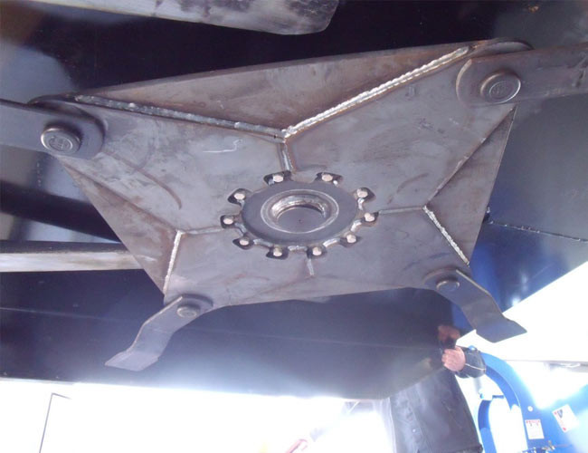

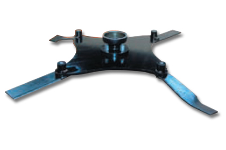

Wondering if brush hogs / rotary cutters come available with 4 blades instead of the two?
Any advantage between them?
Never saw one with 4 blades. So, not sure if they even make them!

Might have to get one from Australia. :)
From:
XHD Series | FieldQuip
From:
Brushcutter Slasher | Bobcat | Earthmoving Attachments | Himac Skid Steer Attachments Australia
Three blades:
NEW Bomford folding tri wing slasher<br /> 4.6 meter cut, 3 rotors - 3 blades each with stump jump pan.....<br /> Rear axle suspension, Heavy duty aircraft tyres, level lift.

Brown is the only domestic rotary cutter that uses four blades that I know of.

There are several available with two spindles, and for blades (2 per spindle).
On a rotary cutter you want larger, heavier blades to be able to cut larger brush, so four blades wouldn't really help.

I have an old Woods Brush Bull 7ft drag (drawbar pull) single spindle bush hog. The "stump jumper" has four holes for attaching four blades. It currently has two. If you remove/unbolt the left side and install the four "banana shaped" blades you could cut hay.......sort of. The blades would discharge it out the side and some to the rear.
