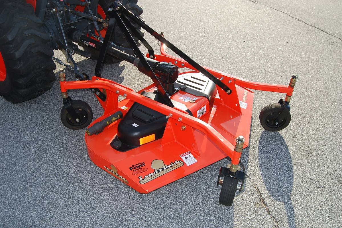

I would imagine it might. Particularly in heavy coarse grass initially.

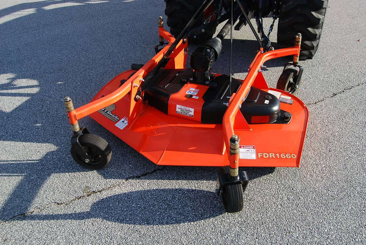

However both these Land Prides are designed for 15 HP and up according to land pride. Specifically designed for CUT's they claim. The 16 series maxes at 30hp but the 25 series goes up to 50 HP. So its just got a bit heavier duty gear box not a rating for a bigger tractor. And its metal is a bit thicker too and it comes in at a tad over 800 pounds the 60 inch is 577 pounds. But the blade speeds are similar.
Would the 60" tend to scalp less than the 84" on my hilly property?
There is also a 6 footer in both models. So its 5 or 6 or 7 foot.
Given the same would you go for something in between or are you happy with 60" cut your getting?

Why don't I just offer this guy a bit less than $1300 for this 60" mower and see what happens... Ive already bought two things from him. A box scrape and a set of forks. Maybe he will consider it. Im thinking $1150?

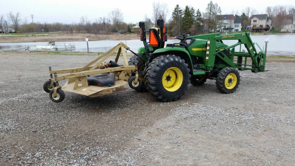

I run a LandPride FDR2572 behind my JD 4310e, which may spec a little lighter in weight than your Kioti, but has around 24 PTO HP. I tried an 84 before I bought the 72. The 84 was too much, had to reduce travel speeds to maintain PTO RPM and maneuverability suffered. Trying to make a tight turn, and forward to backward changes were definitely felt. My thought is the 84 would be too much for you as well, no matter how good of deal it is. Probably best to wait for the 72" model to come along. The LandPride is a nice unit, and I can get parts for it from my local Stihl and Ferris dealer, because there is not a LandPride dealer in town. The rear discharge is really nice for mowing along side of items that can not be spayed by clippings. 20150421_191418.jpg

My very fear exactly. However the Toro doesn't go where a tractor would go either. There is a difference. How much... well.. I'd like to know.
What do y'all think about my offer on that one in the pictures?
