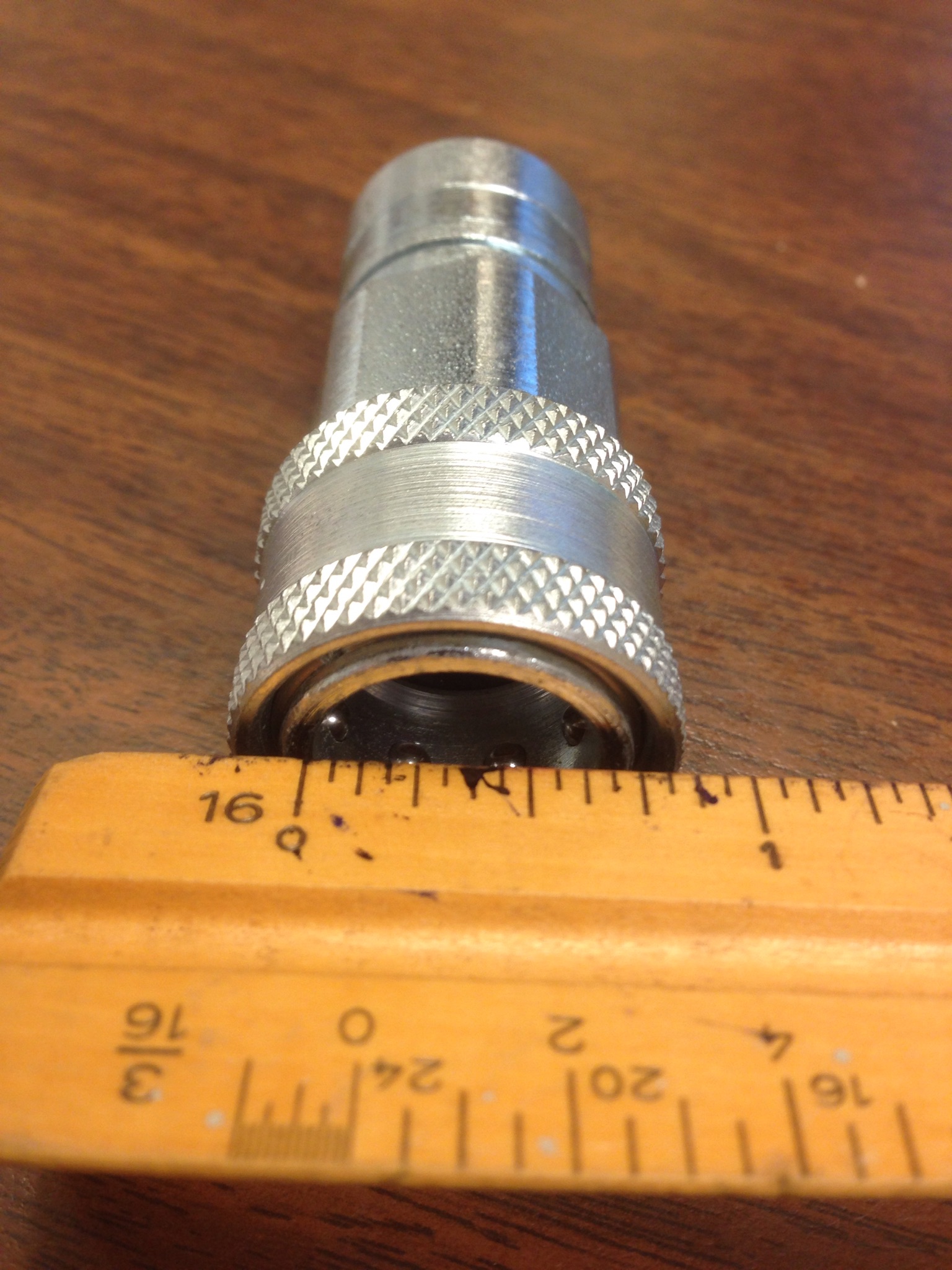

Feb 9, 2016 / does anyone k ow what size coupler this is? getting a wicked grapple but this couple #1 yukonhunter Silver Member Joined Oct 15, 2013 Messages 178 Location leroy ny Tractor John deere 5100m, mf1643 cab and kubota bx2370woods bb720x land pride disc and reverse tiller Here it is..thx Attachments IMG_24981.jpg 559.8 KB · Views: 220
Feb 9, 2016 / does anyone k ow what size coupler this is? getting a wicked grapple but this couple #2 kennyd Advertiser Joined Jul 6, 2003 Messages 13,753 Location Westminster, MD Tractor John Deere 3720 CAB/TLB, JD455 It's a 1/4" coupler, probably ISO5675 "AG" type but cant verify without seeing/knowing what numbers are on it.
Feb 9, 2016 / does anyone k ow what size coupler this is? getting a wicked grapple but this couple Thread Starter #3 OP yukonhunter Silver Member Joined Oct 15, 2013 Messages 178 Location leroy ny Tractor John deere 5100m, mf1643 cab and kubota bx2370woods bb720x land pride disc and reverse tiller Thank you

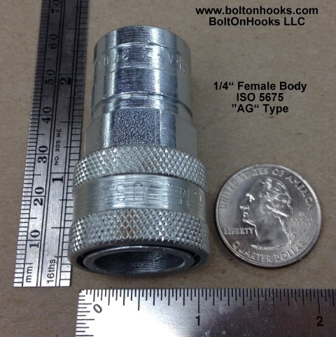

Feb 11, 2016 / does anyone k ow what size coupler this is? getting a wicked grapple but this couple #4 lostcreekranch Super Member Joined Dec 14, 2012 Messages 7,948 Location Austin County, Texas Tractor NH TL-100A with Bush Hog 5045 FEL, WR Long 3rd function, LS XR4155HC w/FEL, WR Long 3rd Function. This might help. http://www.discounthydraulichose.com/v/vspfiles/downloadables/qd_sizechart.pdf
