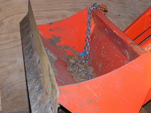

Today, I needed something to push some dirt and decided, since I had the steel, to build a small dozer blade for my Bota. I had a job where I needed to move some tilled soil "uphill" to level out a guy's yard. I didn't think he'd appreciate me back dragging onto his sod, so I fabbed this to bolt onto my bucket.
It's 6 ft long, made out of 3/8 x 4.5 in flat iron. The perspective of the pic is hard to see, but the bottom of the blade is perpendicular to the bucket edge and the top of the blade angles forward, mostly to give it some stiffness at the ends. Also, it keeps some stuff from rolling over the blade.
Used it a about an hour today to move dirt up the hill. Worked slick. With it being outside the bucket, I could see easier how it was going.

Ron, this looks pretty cool. I'm easily impressed when people are able to fabricate their own solutions. But I'm trying to figure something out. You said </font><font color="blue" class="small">( the bottom of the blade is perpendicular to the bucket edge)</font> ...
From you picture, it looks like the blade itself is considerably lower than the bucket edge. Is that just my eyes, or am I missing something about what you said above?

You are correct. The bottom of the blade is about 2.5 to 3" below the lip of the bucket.
I'll take a better angle pic tomorrow.
What I tried to say was that the bottom part of the blade is perpendicular to the bottom of the bucket.
Hope this helps.

Thanks Ron for trying to clarify. I'm almost with you!
When you say </font><font color="blueclass=small">( the bottom part of the blade is perpendicular to the bottom of the bucket )</font> , you mean that on the blade, the bend outward from the bucket starts at the bottom of the bucket, and the blade extends down another 2-3" from there?

So how is this better than tilting the bucket all the way forward and using it as a blade? or will the bucket on the BXs not tilt far enough?

</font><font color="blue" class="small">( So how is this better than tilting the bucket all the way forward and using it as a blade? or will the bucket on the BXs not tilt far enough? )</font>
While reading the Operator's Manual for the new FEL manual (in preparation for the new BX2300 tha should be delivered later this week) I noticed that it specifically said not to turn the bucket all the way forward and use it as a dozer blade.
Apparently it puts a bad strain on the hydraulic cylinder and the whole loader assembly.

Good Question Chucko.
I've tried smoothing dirt using the bucket tilted where the cutting edge is vertical. It will go into that position. It might be putting strain on the tilt cylinder in that mode.
However, I can't see how much dirt I'm moving when trying that, so it's like pushing blind. Also, my blade is 6' wide, so I can see the dirt buildup on either end, which gives me a better idea of how much material is moving. And the extra 2' moves the dirt faster.
