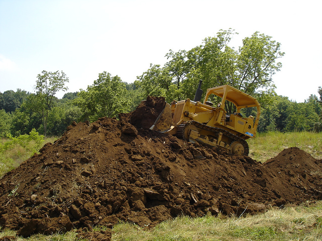

Track loader can definitely dig a hole.
For your use case and if you're maintaining land that's already tame, I'd recommend the dozer with 6-way. Track-loader bucket is usually only the width of the tracks and follows the angle of the loader frame. Unless you're skilled it's challenging to sculpt the land with it, but it can be done. We have this machine on our farm where we don't have a tractor w/loader, so this is very versatile for odd jobs like loading implements, loading dirt in the truck, knocking limbs off the trees, man-lift, etc. We've cleared a lot of land with this machine. Sometimes, a dozer would've been nice.
Like someone else said, you just need to buy both :)

It seems like track loaders can be found cheaper than dozers of the same vintage and weight. For moving dirt from one place to another, the track loader wins. If you are able to find one that has a 4 in 1 bucket, you’ll also have a very versatile machine for moving logs, brush, etc.
If you want to slope and grade, a dozer is hard to beat.
