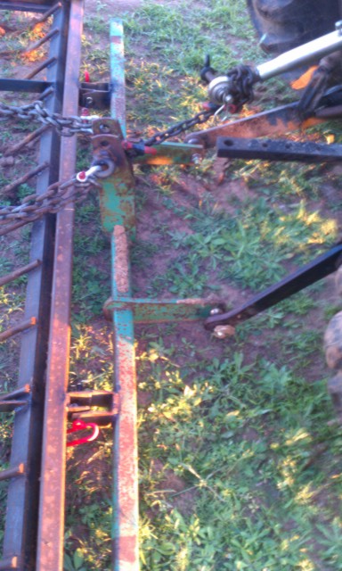

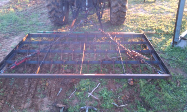

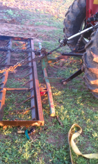

The drag works! No kick up, pulls good. I am going to have to modify the top link connection. Had to use a short piece of chain, as my top link is not long enough. Was able lift the drag and lower it. I am going to raise the point where the chain connects to the draw bar. Think i am going to use cable and turnbuckles instead of chain.

When i get back home Sunday will put a couple pics of how it is on the tractor. Bringing draw bar back home to modify and will have pics as i go on it. Now that I know it works I feel alot better.
   / Drag Harrow Project
#38
Hooked up on the tractor
