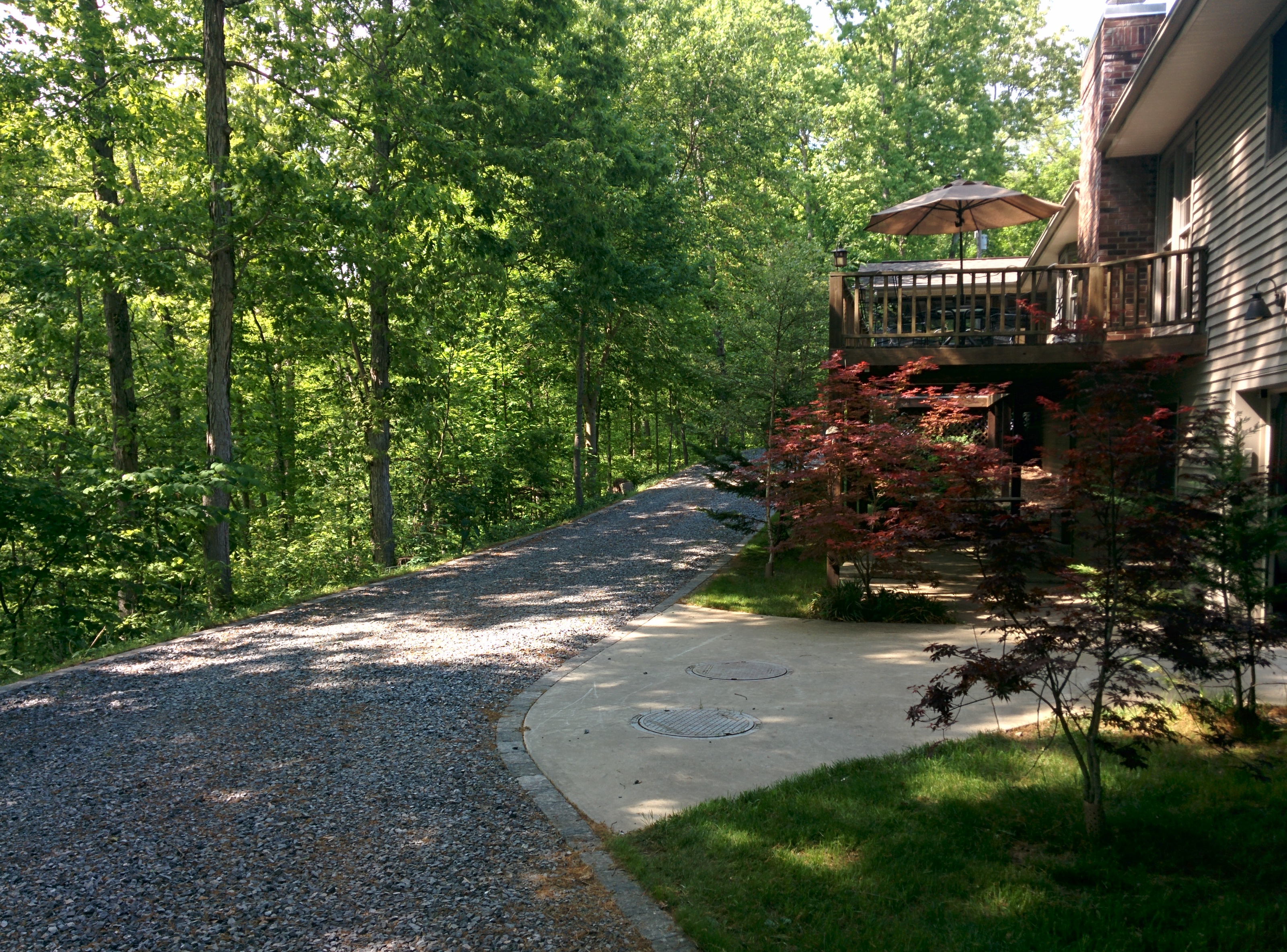

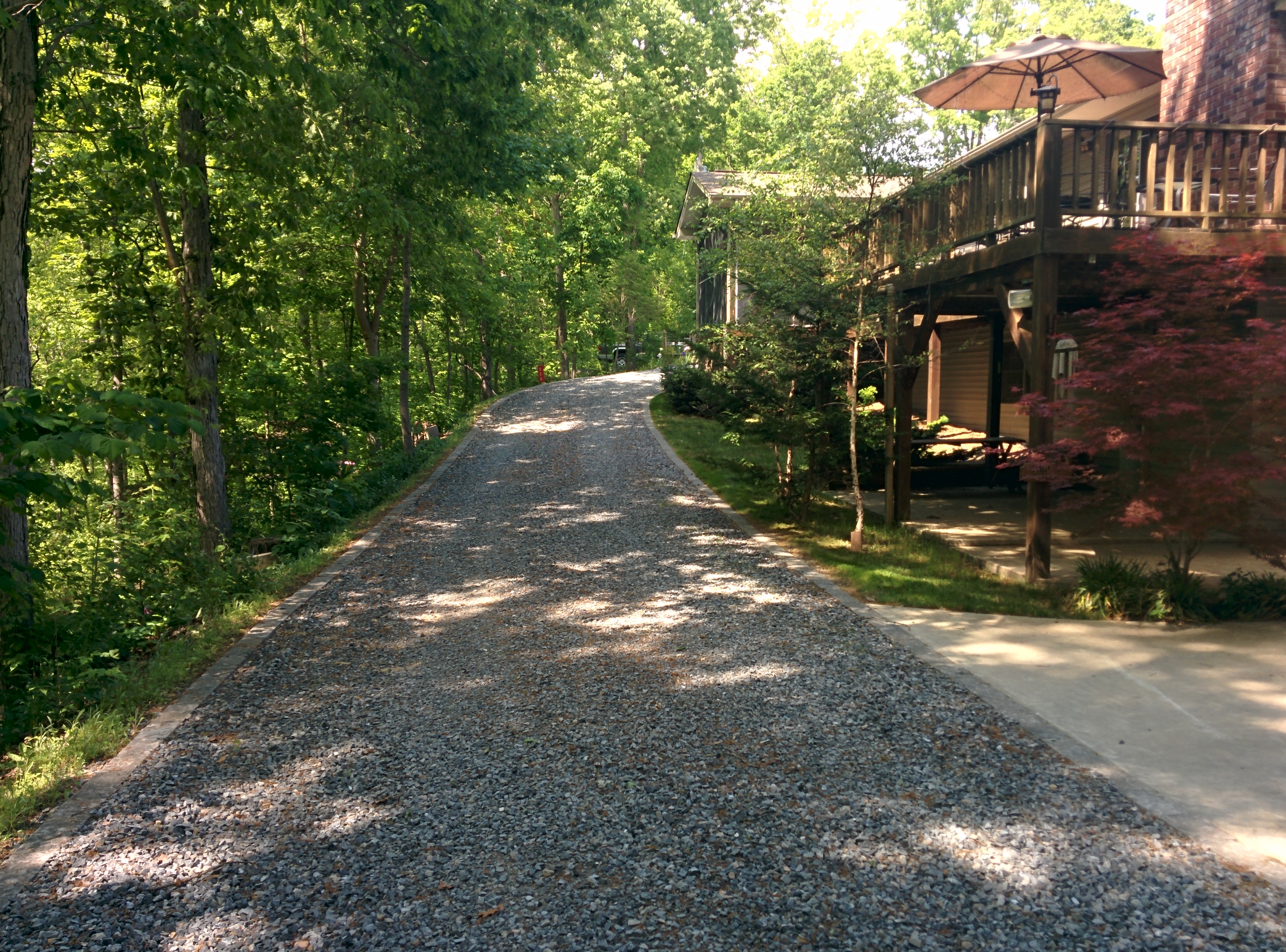

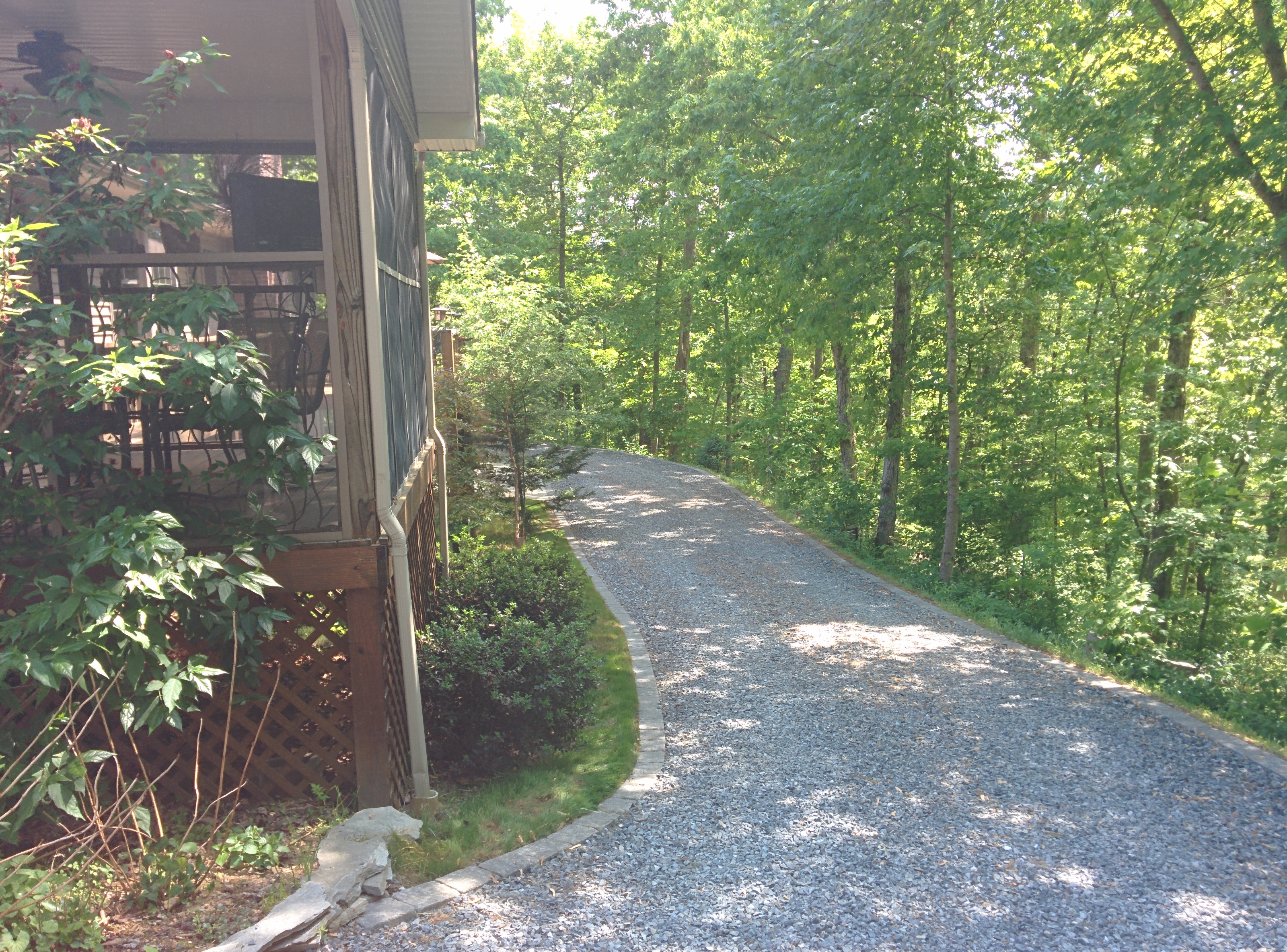

I used pavers to border my gravel.

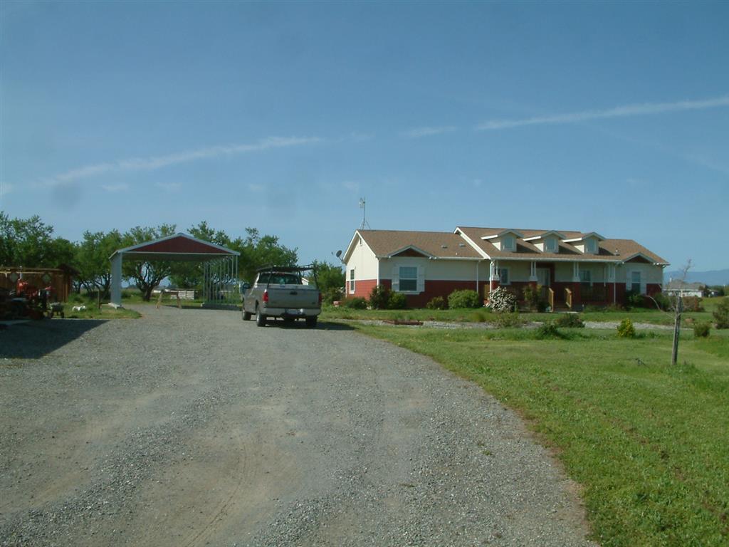

Gravel works fine, IF it's installed properly. The driveway at my ranch is 20 ft wide x 330 ft long and 6" thick. Three 2" thick layers of crusher run, each layer watered and compacted with a vibratory roller). The area was excavated before laying the gravel.
No maintenance required during the 10 years I owned that ranch.
That grey colored gravel looks a lot better than concrete or asphalt, IMHO.

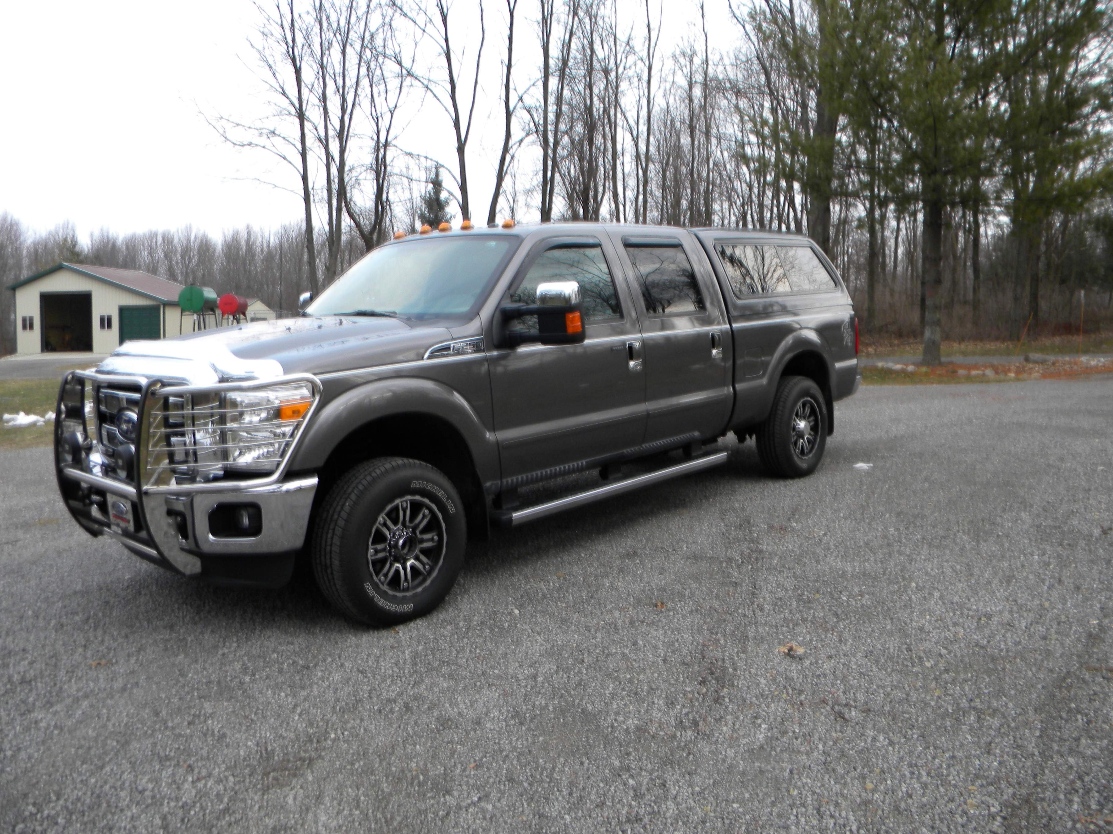

We put slag on our driveway 8 inches thick.Been there for 20 plus years and has held up great.

Not really. Just thought 10 ft is too narrow, 15 ft is marginal, so I ended up with 20 ft wide. That driveway in proportion to the house and carport looks right to me--not to narrow, not too wide. Like Goldilocks:eek:
