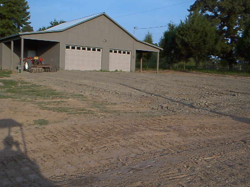

Gary Shop Apr 2010 .JPG This is how it looked after putting down the shale around my shop which was built first then house a year or two later. Sorry, don't have any of the final product.
If you cant afford asphalt or concrete, then all this advice about pavers is for sure out of the question due to cost. Lots of folks gave advice on sidewalks which while looking good don't work for driveways.
I couldn't afford that so I just went with base of crushed shale topped with crushed limestone after a few years of settling. My first loads of limestone that I put on the driveway in 2008 (25x 50) for access to the building site was pure white and looked very good but 3-4 years later the delivered crushed limestone was white with brown spots so not the pretty white of the first stuff. It still works for mud and dust control though.
I first put down about a foot of shale on clean surface (no grass or weeds) since the whole area was cut down to level a hill. I just spread it with a dozer and he walked it in a bit to settle it. Not even a fully loaded concrete truck makes a dent in it when dry but would when wet. After about 3-4 years of weathering I found that the shale was turning to dust on the top 2 inches from sun and rain exposure..
The crushed shale is great for a base but it has to be sealed from the elements because sun and rain will convert it from rocks to powder in a few year which is why I had to come back with about 3-4" of crushed limestone on top. It has held up fine since covering it over with the limestone.
Crushed limestone was my cheapest option since I didn't want to spend the money for concrete and would never do asphalt which requires yearly maintenance to prevent or fill cracking with asphalt topping. It is never ending maintenance for asphalt. It may not look as good as concrete, but it serves the purpose of keeping me from travelling thru mud when it rains and no dust when the wind blows.
