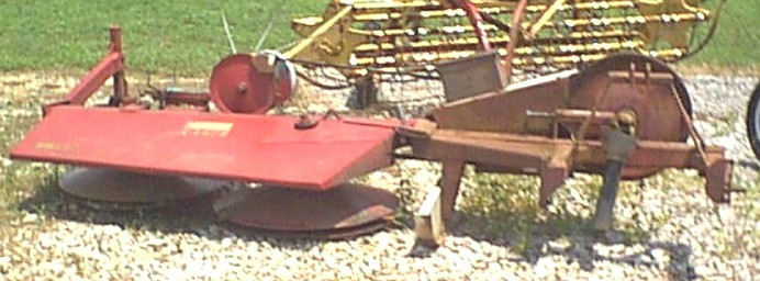

I am not sure where you are located, however, we have a good used Reese drum mower for sale here in central Ky 42765. The mower is field ready. Price is $2395 picked up here. Ken Sweet

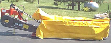

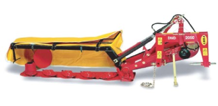

We prefer the disc mowers as well, If all the tractors have a hydraulic outlet at the back? We do stock the model 2050 (7ft) New Fort First Choice for $5795 and we can deliver one to western Pa for around $150. It does require at least 1 remote line out the back of the tractor. Ken Sweet
