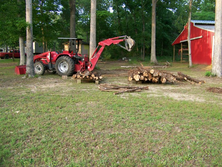

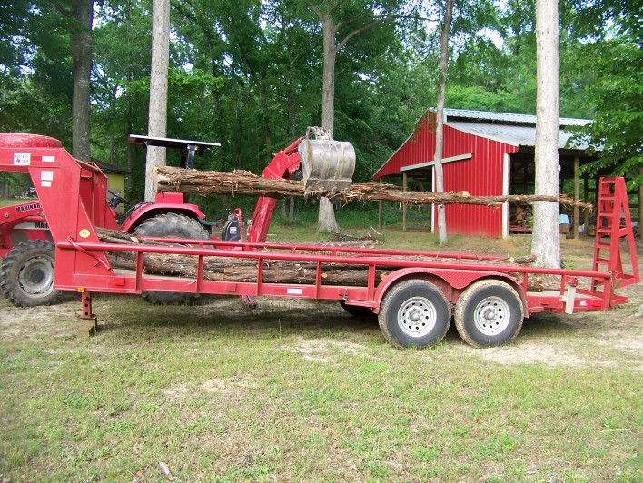

I started putting fence posts in 2 years ago along my driveway. I cut the posts myself on Lee's goat farm (Weldingisfun). Lee loaded them with his Mahindra's loader after I limbed the trees. Since I did so much work, I was treated to a vension supper. Yum. 4-23-10 Six to Twelve Inch Cedar Logs.jpg4-23-10 Stacking Cedar Logs.jpg4-23-10 Unloading Cedar Logs.jpg

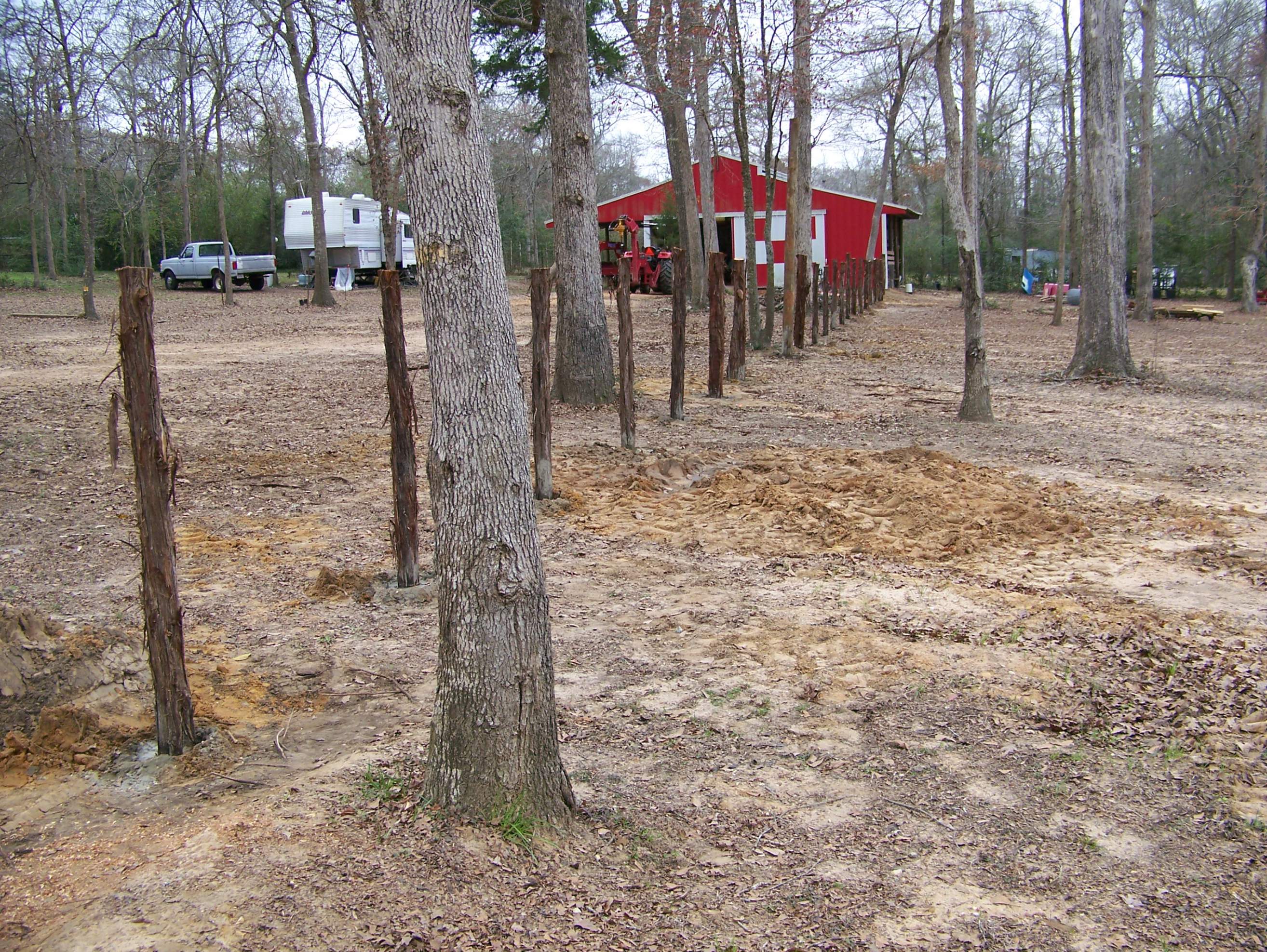

After I got the logs home, I cut them to length and pressure washed them. I decided right then I would never strip cedar posts with a pressure washer again. Ever! Luke and I planted them on beside my half of the paved street that is on my property. I use it as a driveway.12-8-12 Posts Lining Up.jpg12-8-12 Luke Cleaning Out Post Holes.jpg

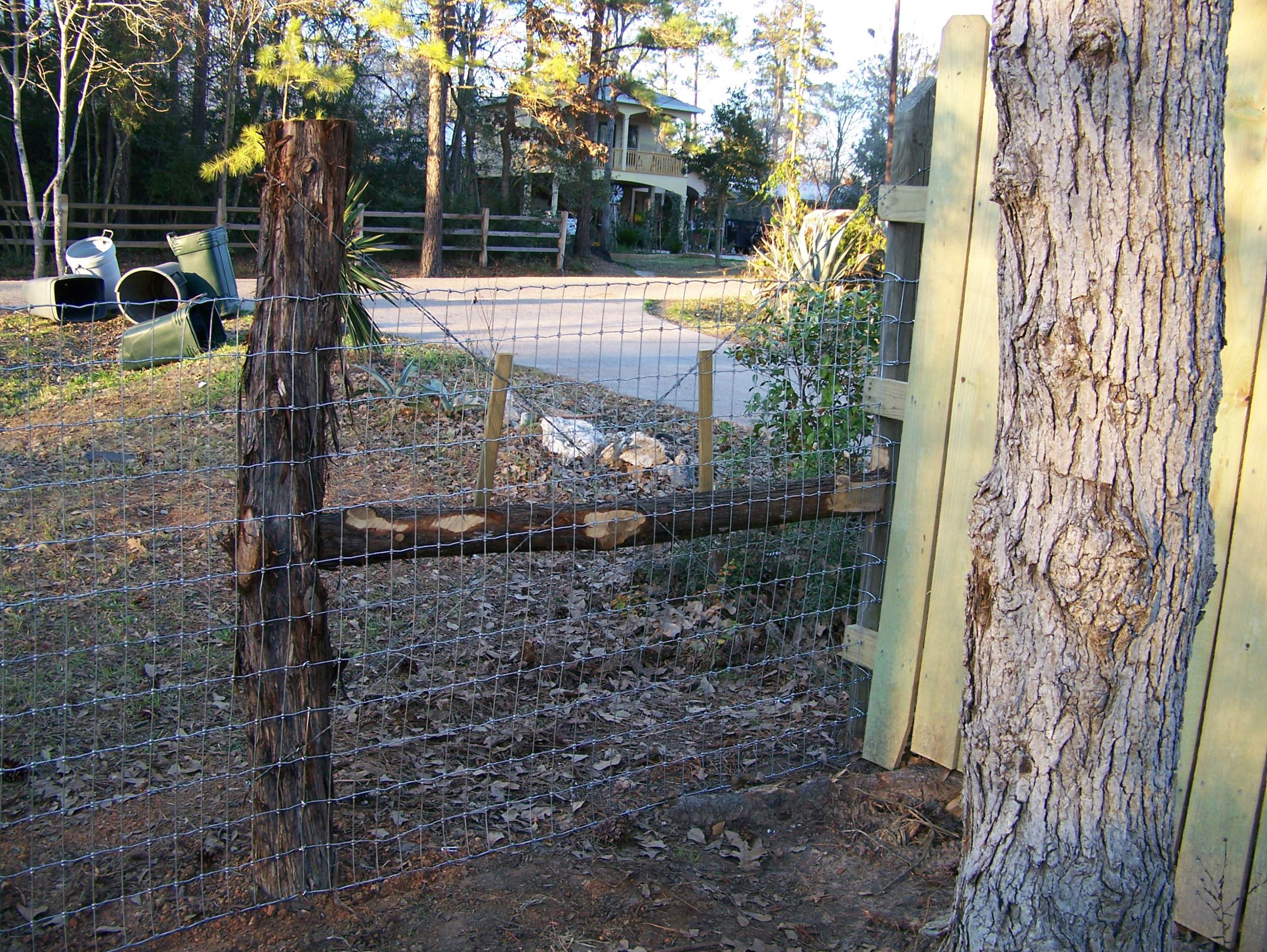

Last Spring I fenced in my island duck pond with non climb horse fence and a corral board on top.

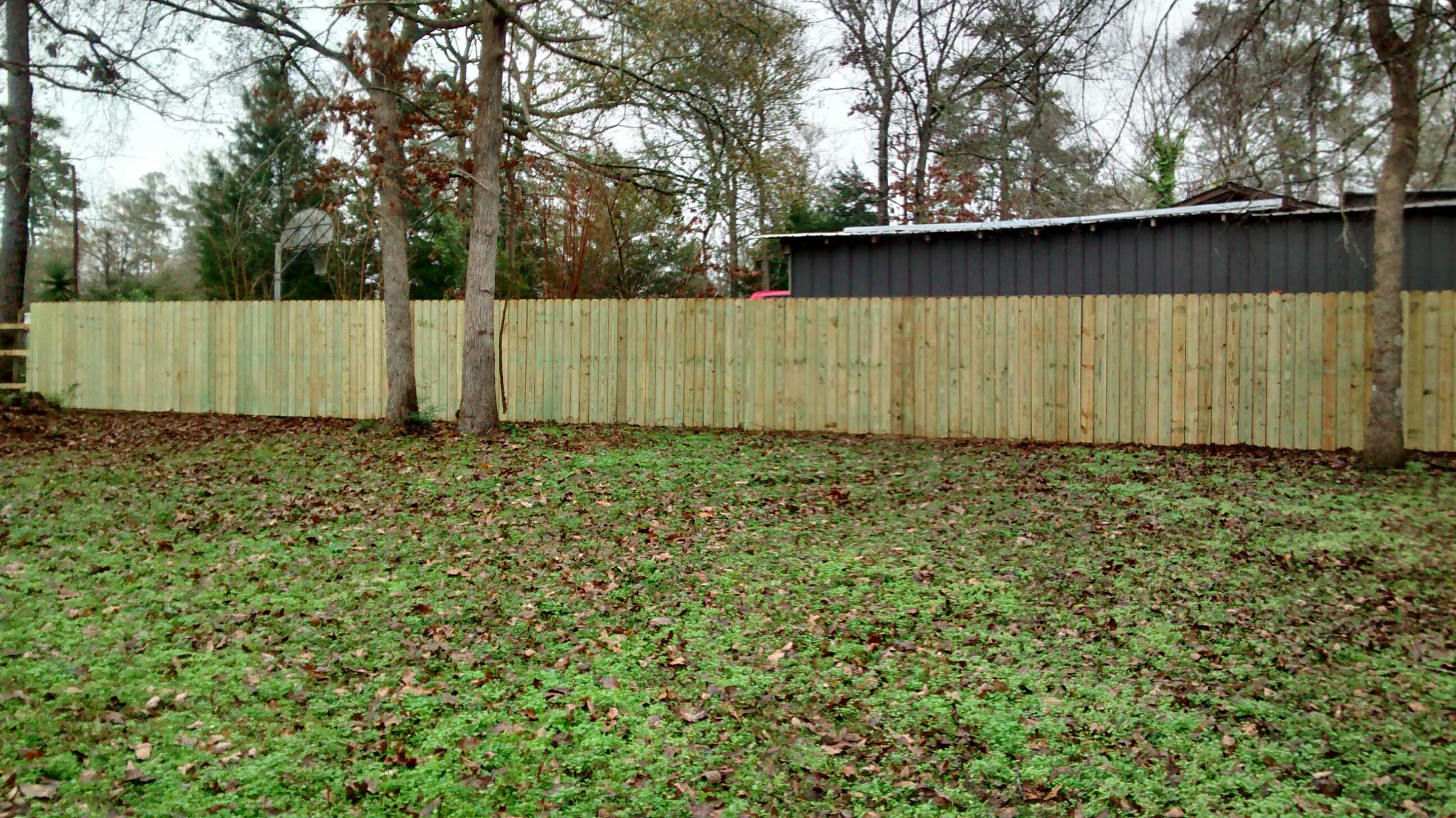

I love the look. So now I am fencing in about half my property so my Heeler pup can run free. First I finished the wood privacy fence on my close neighbor's side. I started this fence in 2002. I just finished it in Dec. 12-26-14 Wood Fence Finished.jpg12-24-15 Brandi on Trailer with Fence Boards.jpg

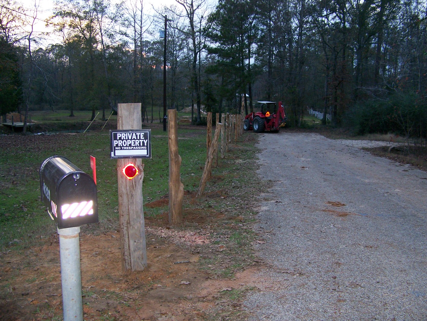

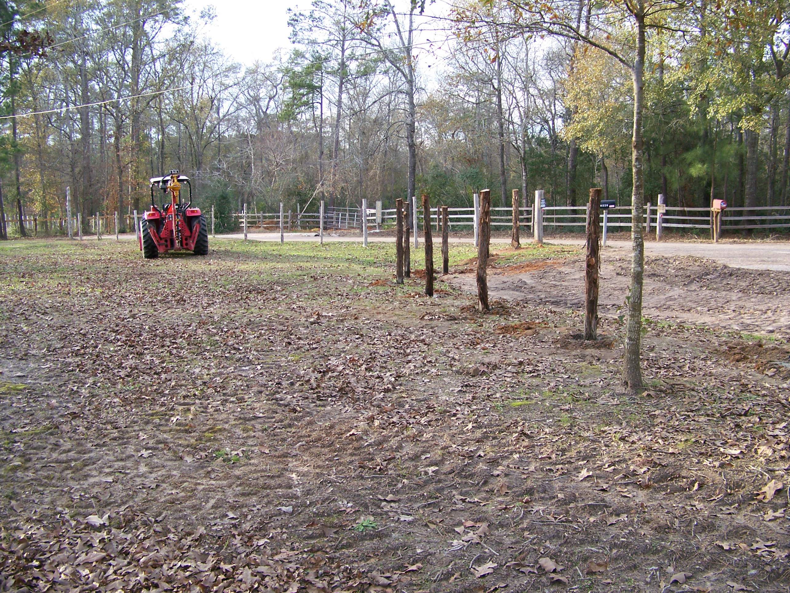

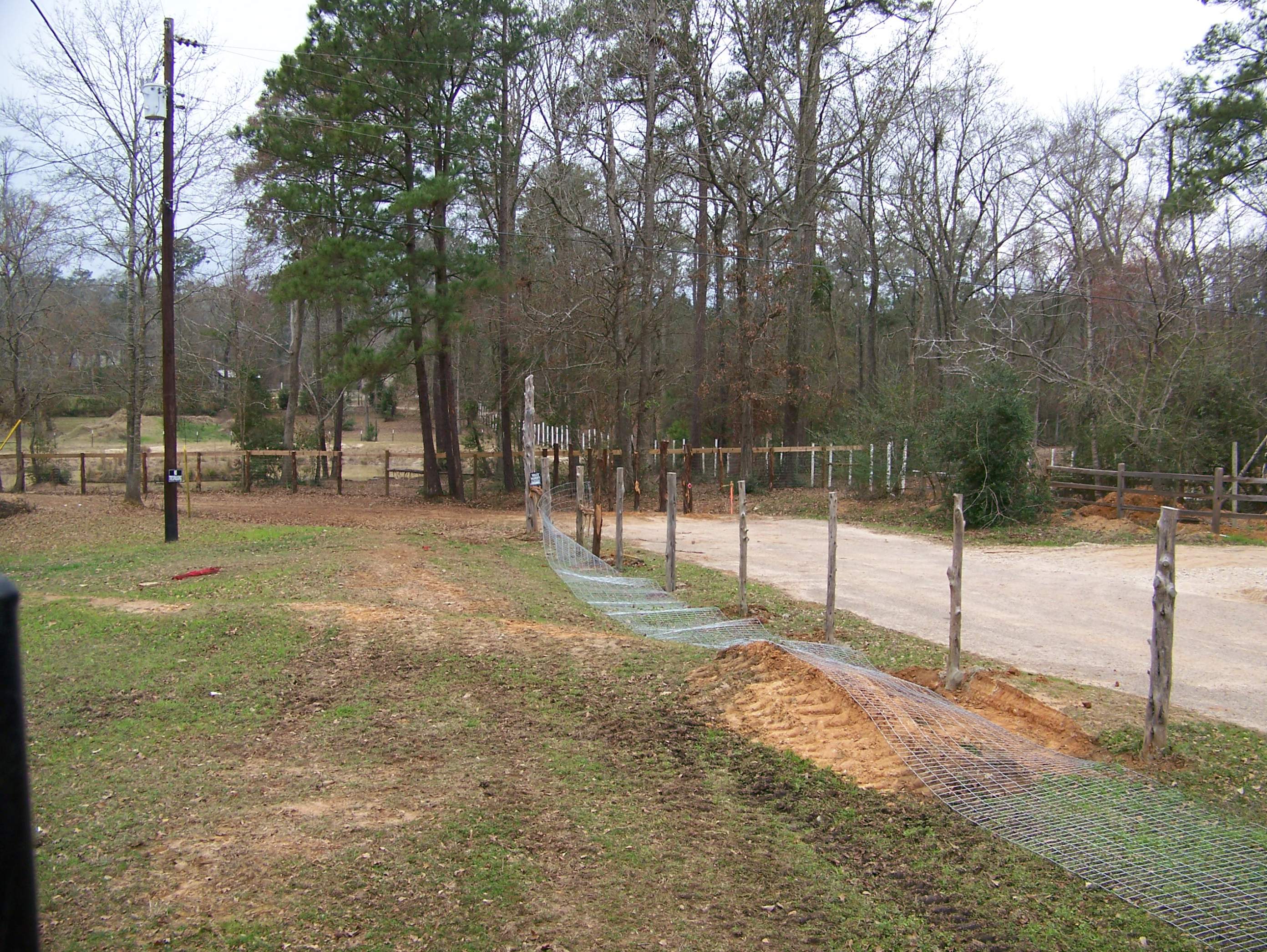

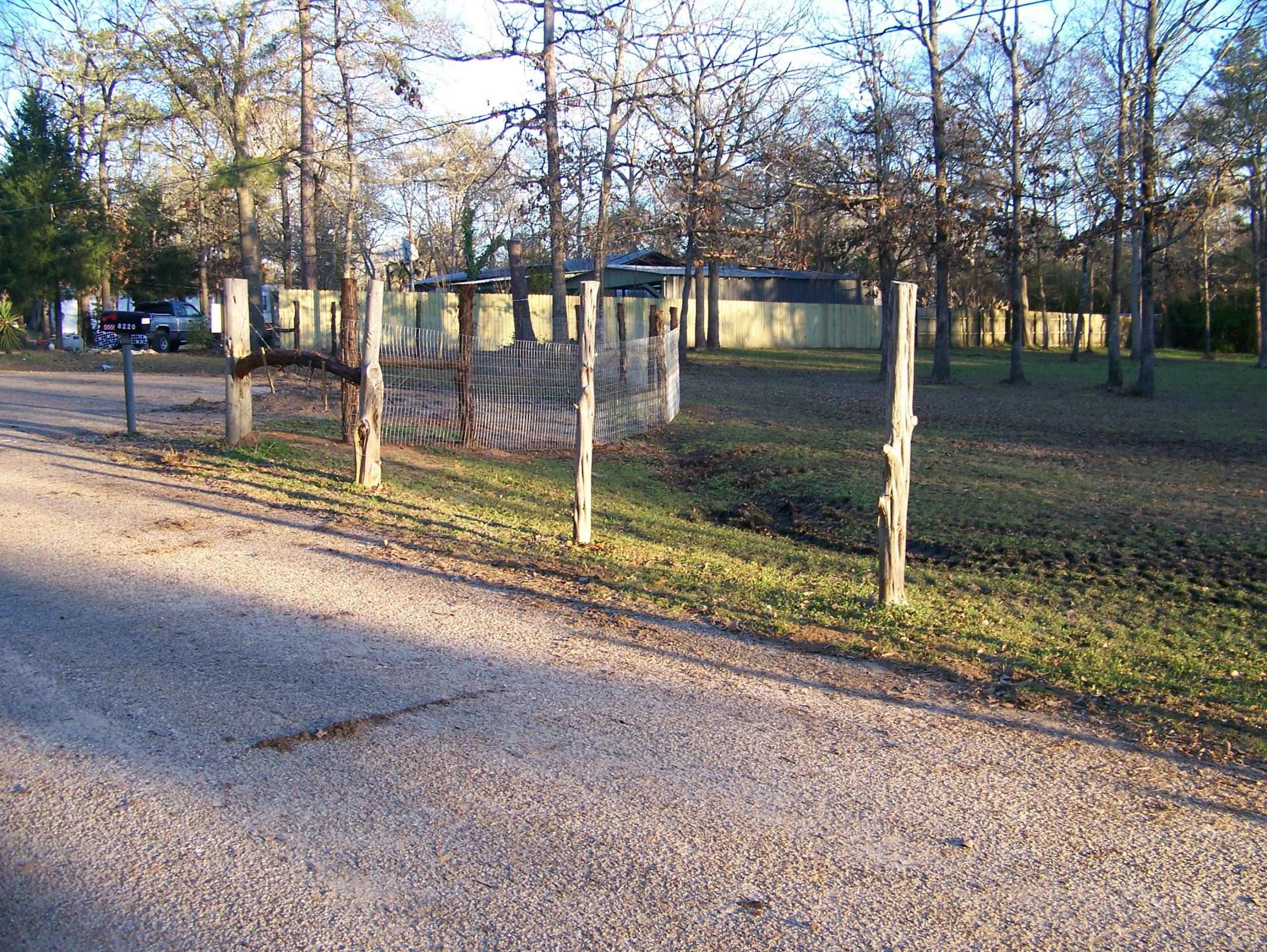

Next I installed posts for my front yard along the Cul-de-sac. I then stretched the fence tight enough to strum the wire. I like a tight fence! I stretch it with pine 2x4s bolted to the wire with a come-a-long anchored to the loader bucket of my Mahindra. I put the backhoe stabilizers down and nothing moves. I came up short with the wire where the driveway turns from pavement to dirt and gravel, so we had to add another bracing post pair 12 feet from the end. Talk about frustating. I have made numerous rookie mistakes so far. Like putting a brace post too far from the end post, over 7 feet. I cross the brace posts with barbed wire. My dangerous mistake was using used, rusty barbed wire and tried to twist it tight. Don't do it. I won't again. It broke and almost wacked me in the face. Another mistake is not putting the pressure washed, stripped posts in without concrete. I pulled about a dozen of them up and reinstalled them with Quickcrete.
1-16-15 Cul-de-sac Posts.jpg1-27-15 Cul-de-Sac Fence.jpg1-27-15 Front Fence Corner Bracing.jpg1-31-15 Driveway Fence Going Up.jpg1-31-15 Fencing cul-de-sac & Driveway.jpg1-31-15 Driveway Fence Stretched.jpg

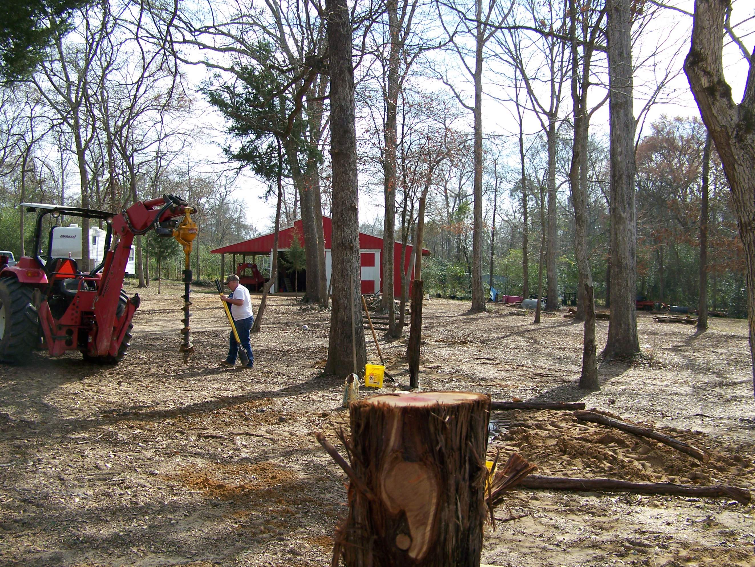

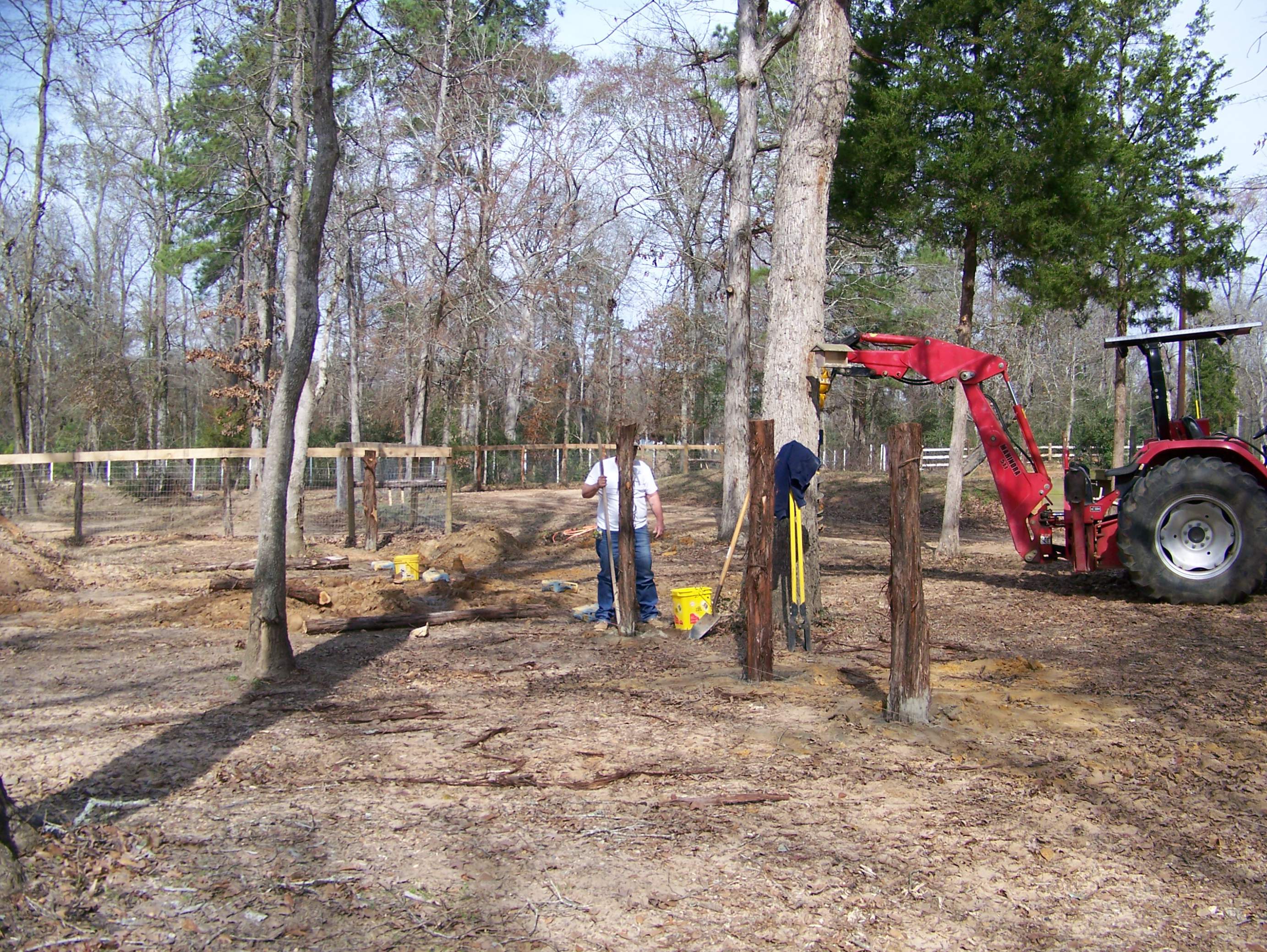

Here We're installing the posts between the duck pond fence and my barn. I'm leaving a 16 foot gap for a gate. Deep post holes are easy with a hydraulic auger on my backhoe. I planted a 16 foot treated pole for the gate post. It's 4 feet deep. I will swing a drag wire from the top of the pole to the far end of the gate. I use the wire bottom gates and bolt a corral board across the top. But I will be making a walk through gate near the mail box out of corral boards and non climb fence. Never know when I will get the horses this higher cost fence entails.;)
My friend Brady has been helping me all week, since I took off over a week and swapped out his truck engine. After 5 days of quiet, he suggested I pull my truck up and crank of the CD player. We listened to Stevie Nicks and Fleetwood Mac the rest of the day.
1-31-15 Fence Brady Action Shot.jpg1-31-15 Truck CD Belting Out Stevie Nicks.jpg1-31-15 Cedar Fence Posts.jpg1-31-15 Brady Hiding Behind Post.jpg
