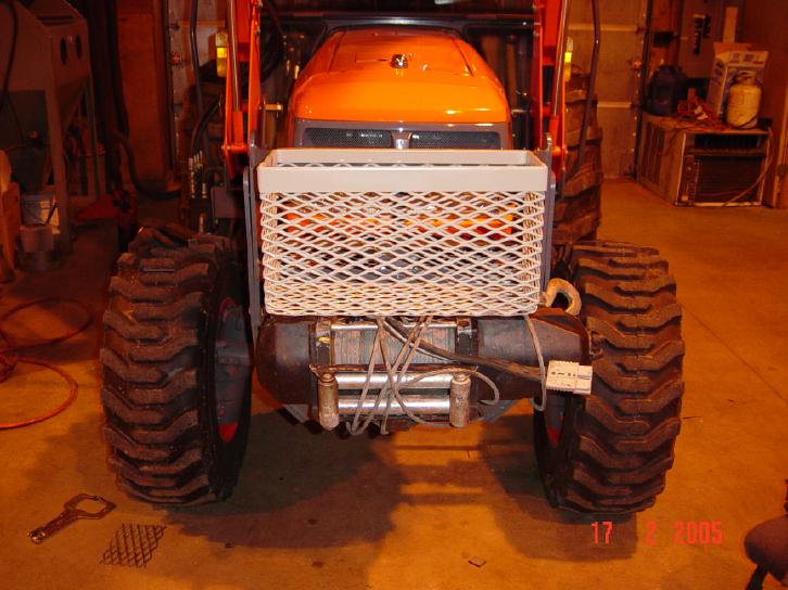

put a hitch on the front of the tractor
like this
here's a pic from behind.
were still working on the brush bar and a removable chain box.
i'll be using it for several things including an electric winch

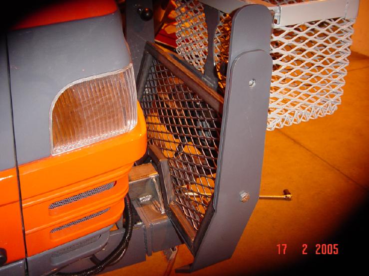

   / Dump Trailer / Backhoe Conunbrum #9
here's one with the winch and chain box mounted.
