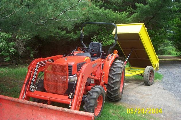

Lookin good. /forums/images/graemlins/cool.gif /forums/images/graemlins/cool.gif
Specs - size, capacity etc. How long did it take you to build? How much $$$ invested.

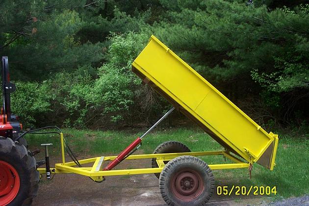

One more pic

Very nice!
I like the yellow "primer".
I'm sure Kub orange is to follow!!!! /forums/images/graemlins/wink.gif
   / Dump Trailer #5
That is great!
Did you draw up the plans yourself or find some "commercial" plans somewhere? What's the capacity?

That is the final color (saftey yellow). Sorry no kub orange. The plans came out of my head and a little hen scratching on paper, just so that I did not order too much steel. Capacity I don"t know but its 4"W x 7"8'L x 18" high. Tires are 7.50x 16 8 ply. On the test dump I had it level full of wet sand, no problem. Cyclinder is a 3" x 30" stroke. The box is 10ga mild steel, sub frame2"x2"x 3/16", main frame 2 1/2"x2 1/2"x 3/16". Even got leaf springs in it. If I would have had that 20 years ago I could have save handling a million pieces of wood.

Very professional looking job. It looks like it will give you many years of useful service. Thanks for posting the pictures. It's always motivating to see projects like this.

It took 2 weeks off and on and about 700 bucks. I don't count my time cause I am retired. I had looked at a smaller tandem commercial built and the guy wanted $1500 for it, used. Tandem's are OK in some places but when they turn on soft ground the tear up a lot of real estate.
   / Dump Trailer #10
Your capacity (volume) is 46 cubic feet (about 1.7 cubic yards).
Sand has a density of ~150-160lb/cubic foot. (Depends on how wet it is) = ~7,000 pounds in your test dump
