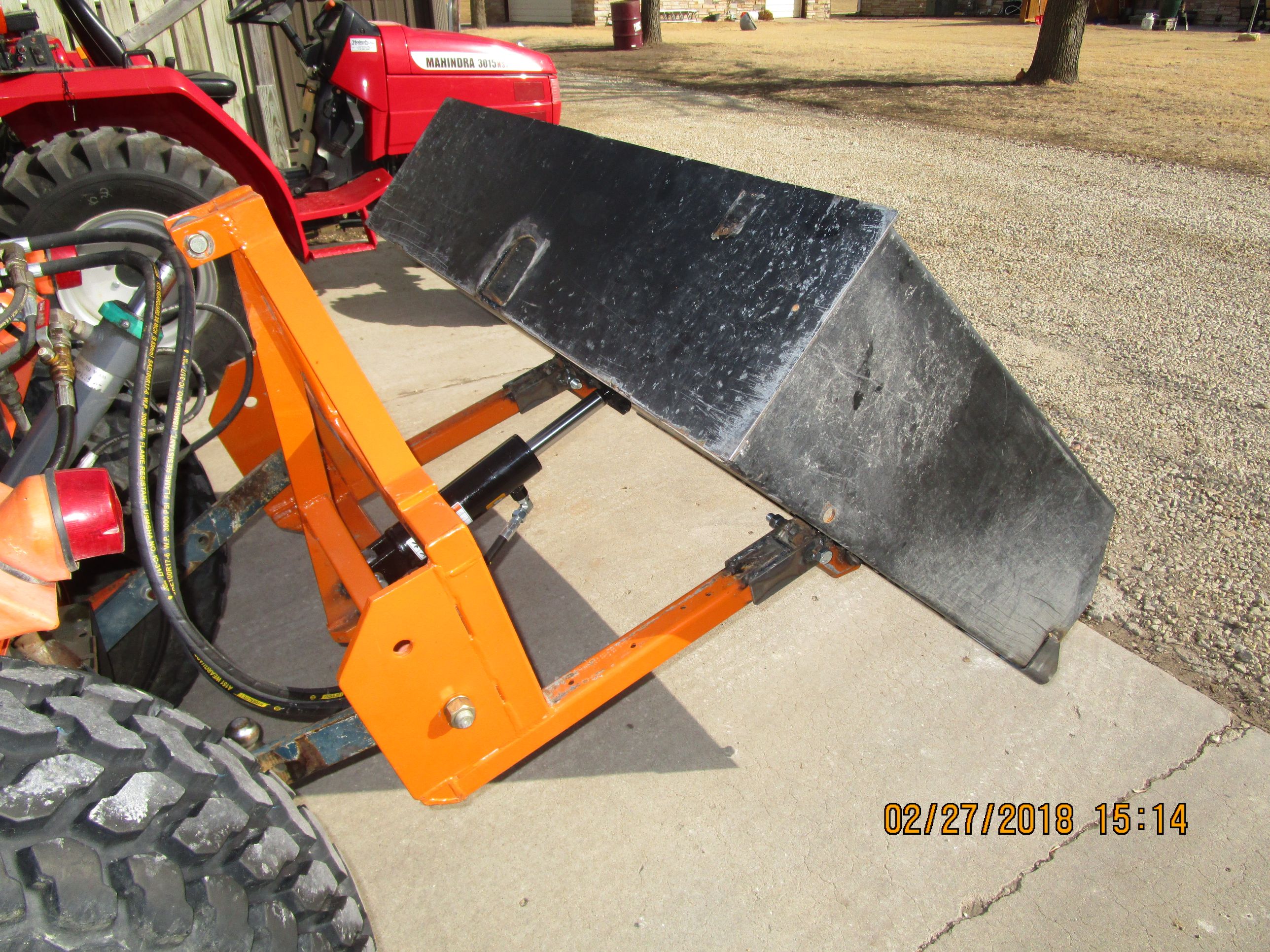

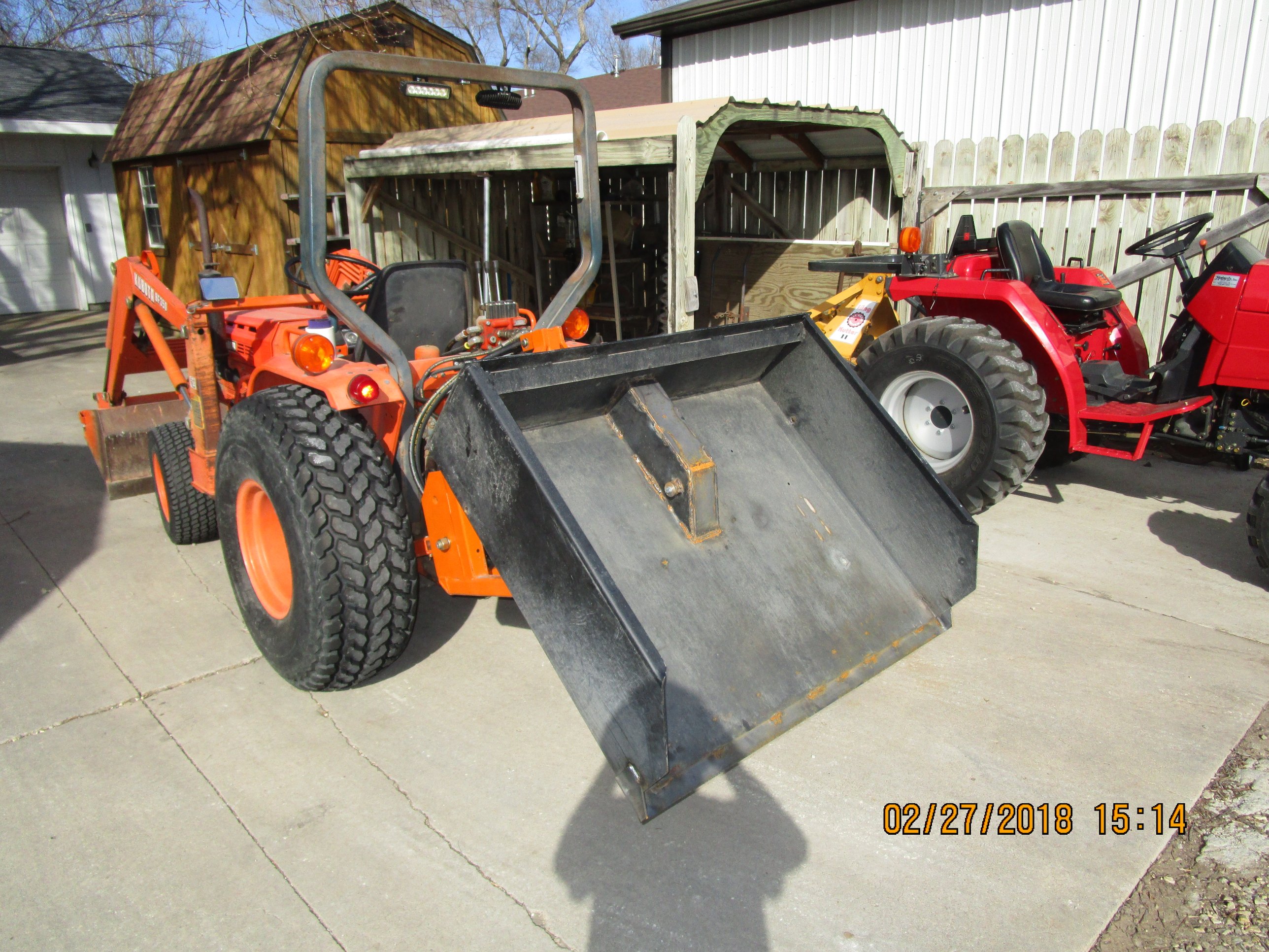

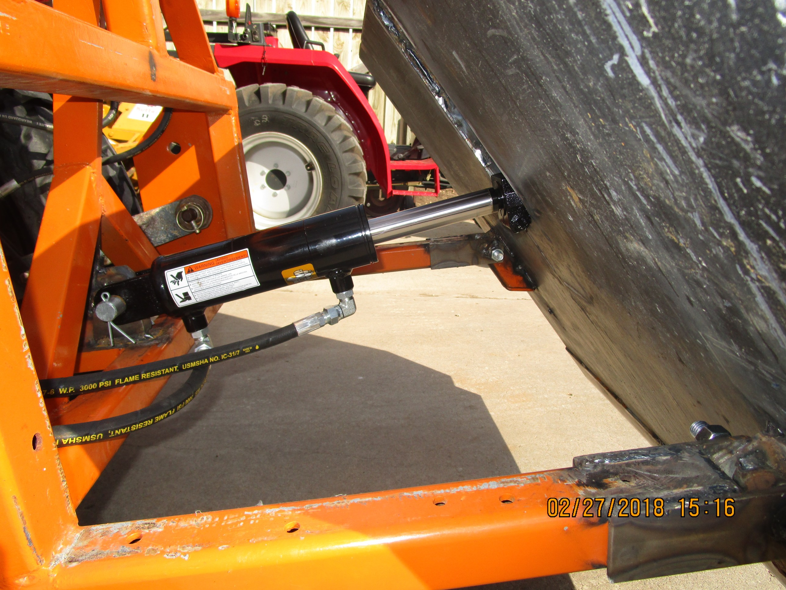

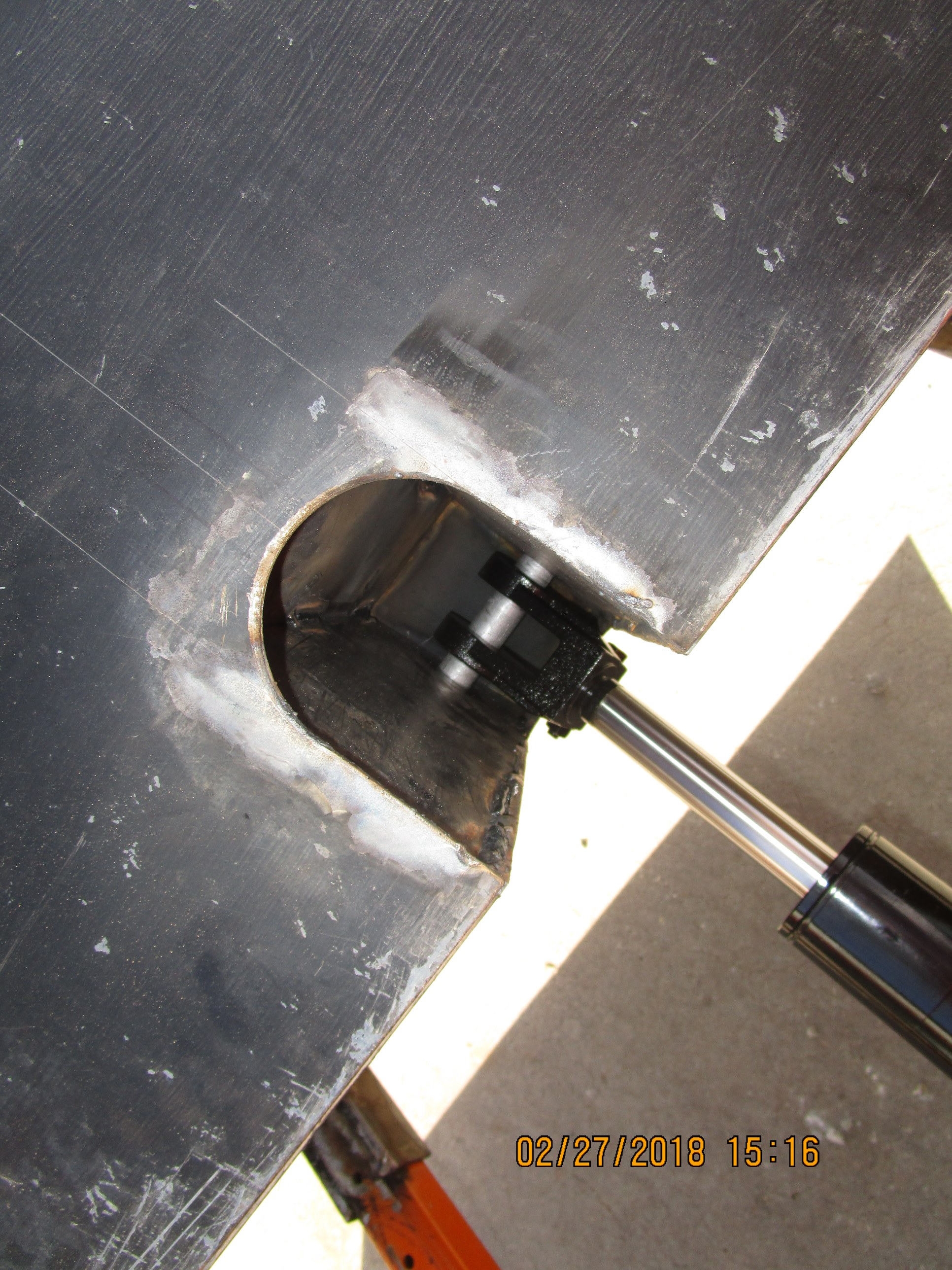

I added a 2.5" bore x 6" stroke cylinder and hinges to this box that was formerly bolted to the 3PH carrier to facilitate load dumping. I had been using the TNT top cylinder to dump the rigid box but not getting enough dump angle especially on a slope. The box will carry about a 1/2 cubic yard if heaped.
Edit: Looks like a bit of black paint might be in order. :)
On a side note, it's interesting to see that the Europeans tend to use the 3PH in lieu of the FEL to load, carry and dump heavy loads.

Very cool and nice fab work. I have noticed the same thing about the europeans using the 3ph as a bucket loader on the many youtube videos I have watched on tractors. They also have some prety cool and inovative stuff

I realize that the "pond scoop" type 3PH buckets have been around for many years and have probably moved many thousands of yards of dirt. Not every tractor has a remote valve available but most tractors have provision for a rope operated dump trip. :)
The hydraulic cylinder also allows a bit of grading and smoothing capability by tilting the bucket. Limited back grading similar to what can be done with a box blade is achievable.

Any developments concerning the mahindra loader?, also looks as if combo top link cylinder and dump cylinder can work in unison to create even greater dump angle if you have clearance underneath.

You're right on with the combo dump. The two cylinders offer a lot of capability. Also the dump box combined with the FEL more than doubles payload capacity with each counterbalancing the other. I think people are generally adverse to rear attachments that require turning the head to see what's going on. I like them because it puts weight on the rear wheels where it belongs.

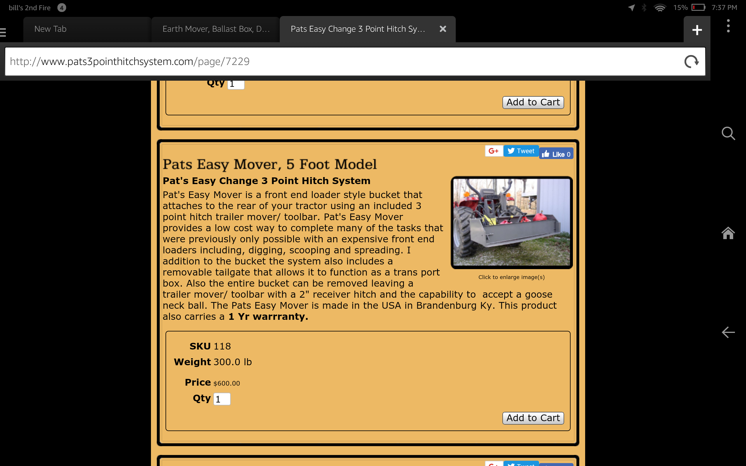

The Pat's Easy Mover @ $600 for a five footer would be a very cost effective tool and not require any auxiliary hydraulics.

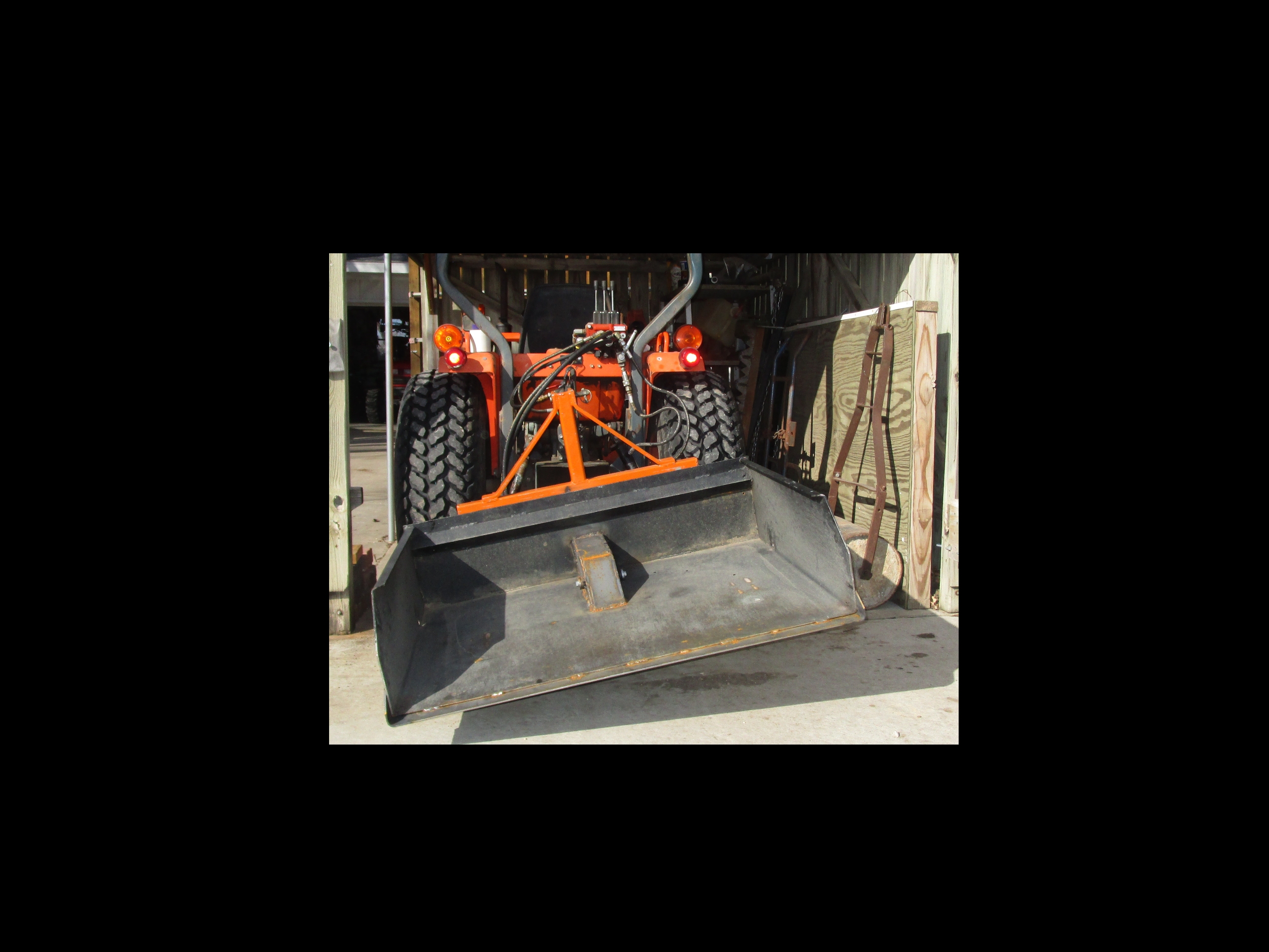

Nice attachment npalen. I never thought of using the 3pt dirt scoop as a ballast box for FEL work but it makes more sense than having another unitasker sitting around. I could pour a concrete block that just fits inside and still use the scoop if needed elsewhere.
