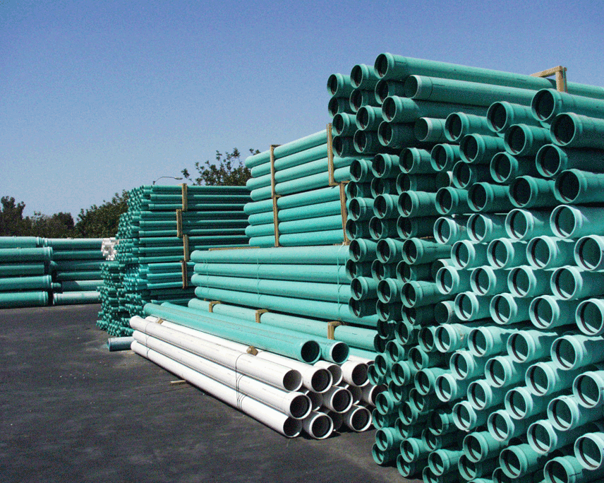

I was thinking the same thing, some schedule 10 PVC bell ended stuff like what is used for rain drainage.
sounds like it would be better than the corrugated for humidity removal. Would be more expensive but some aluminum would really transfer temps much better but would cost 4x for materials...
Mark
Was thinking that too - green pipe..
