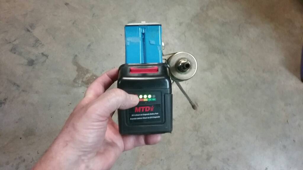

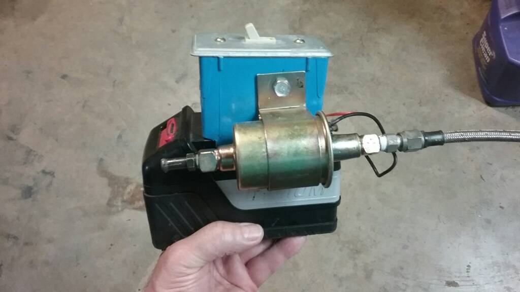

Something to consider. Years ago I strapped a universal 12 volt electric pump to an 18 volt lithium ion battery, the kind for drills, etc. Put a switch and two hoses on it.
Now you can transfer fluids easily. I use it to fill mowers, tractor, etc.
Recharge battery in it's charger. You could always just clip lead it to 12 v battery, switch inline.
I just ordered two extra pumps online from Wal-Mart $10.79.

That works also, but I'm cheap :)
The electric pump is more versatile also.
I bought this battery with charger on clearance. It works well. You could use any li-ion battery, 12 to 20v...or just clip lead to the tractor , car, mower battery.
