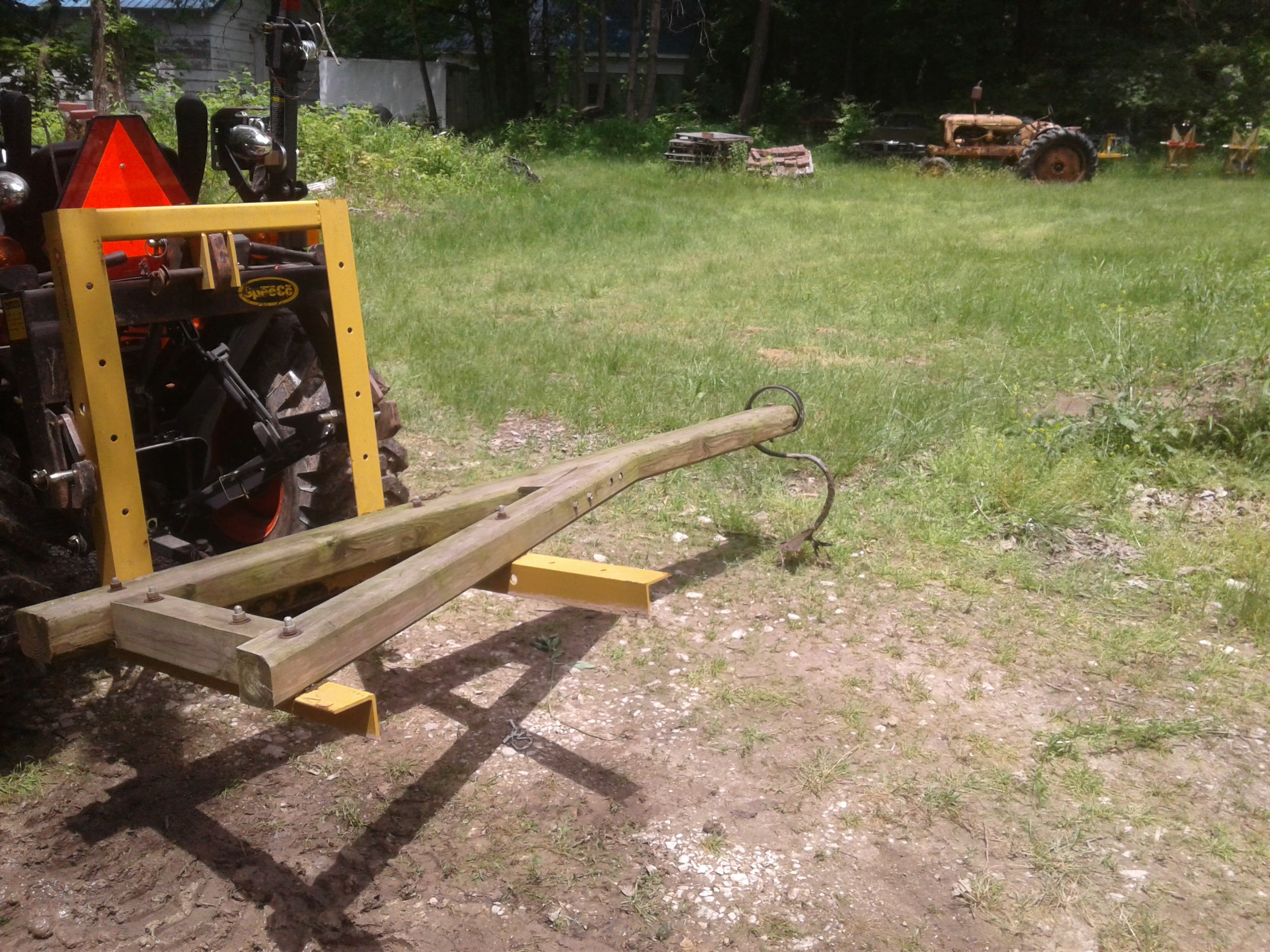

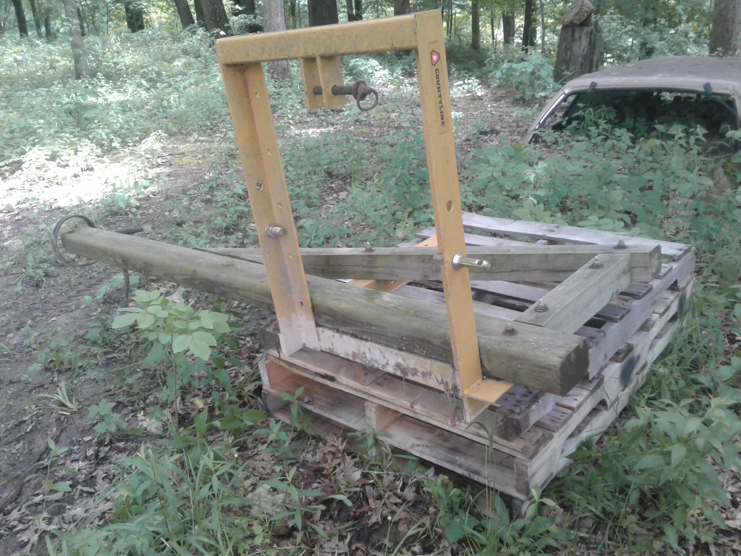

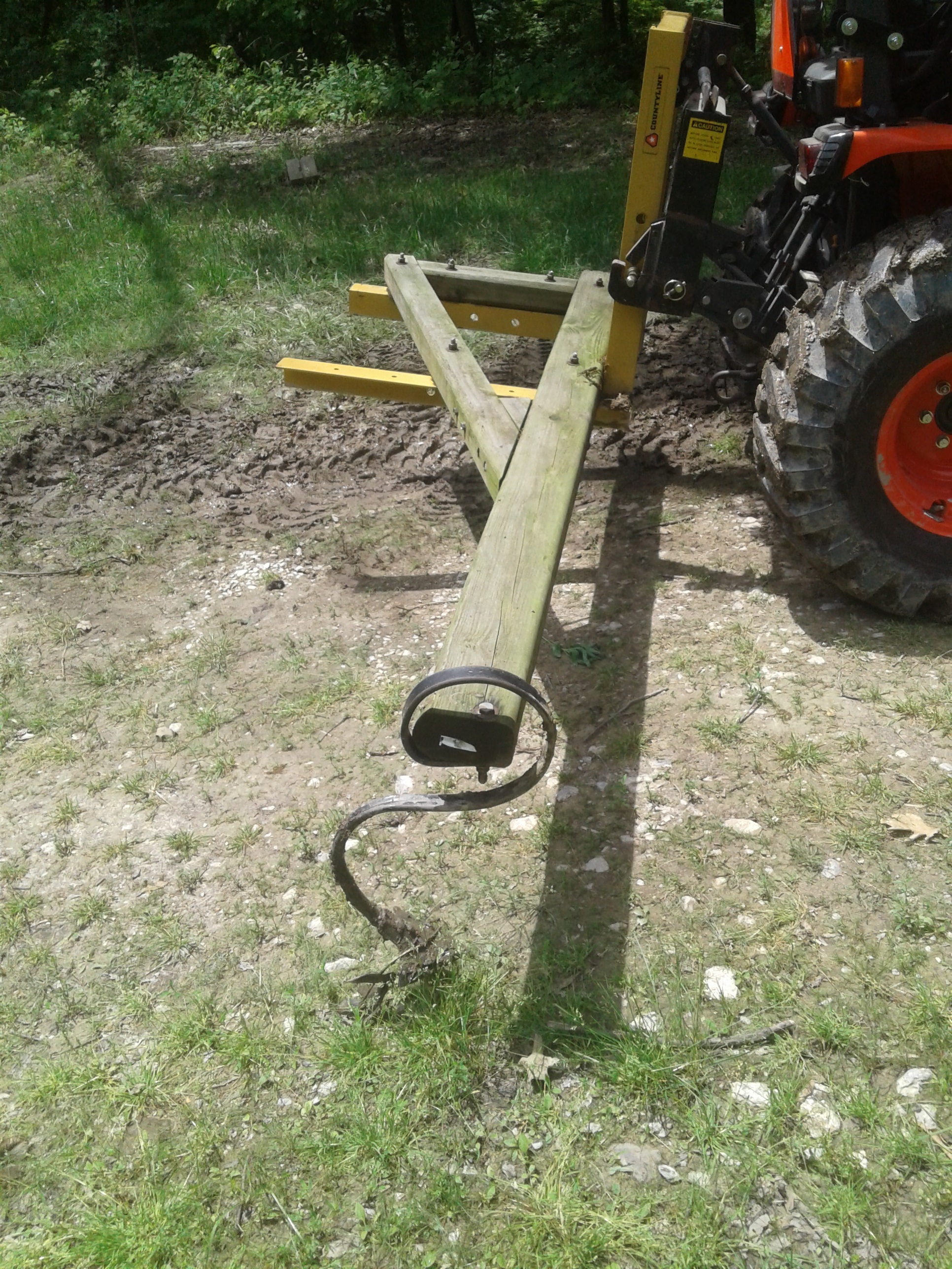

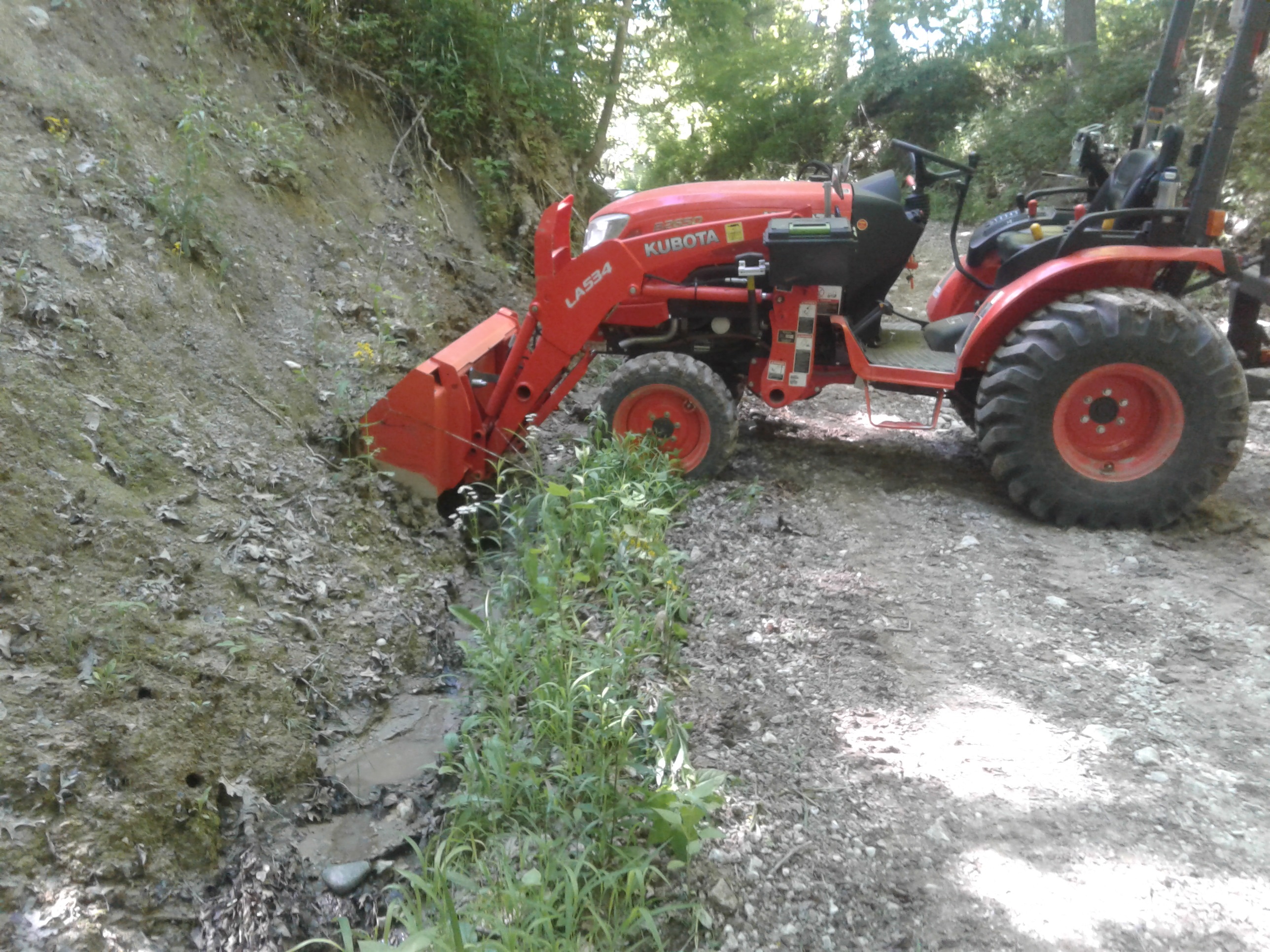

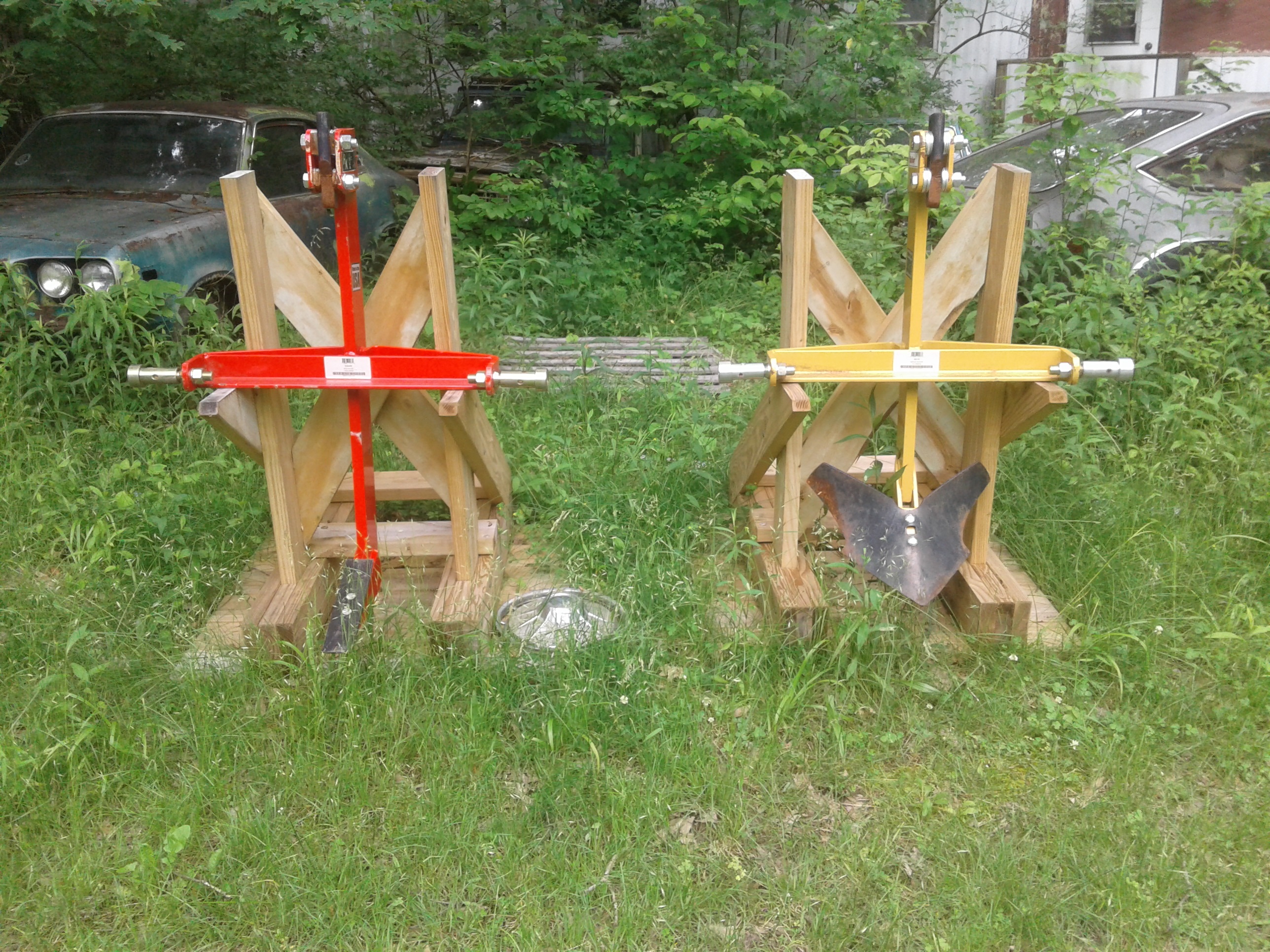

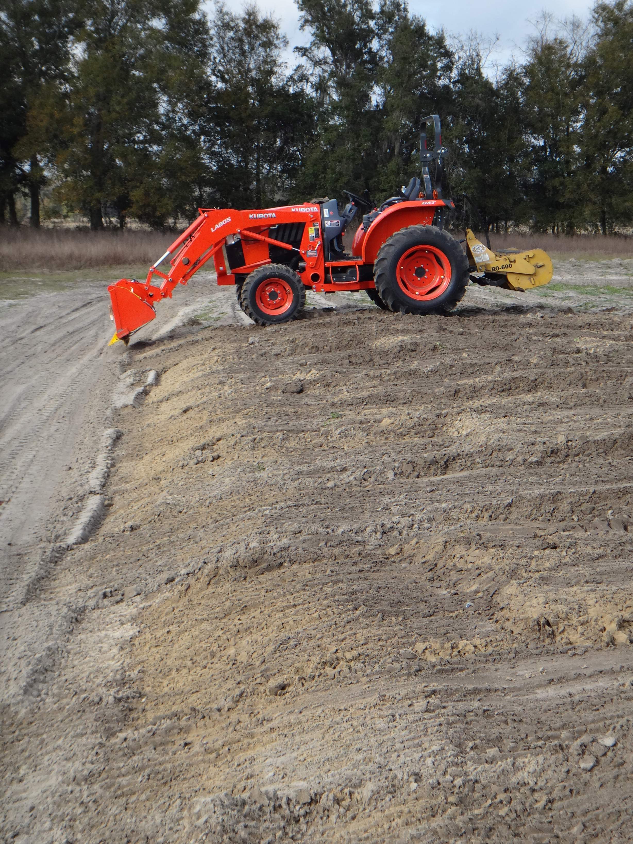

Made this 8 or 9 years ago. Idea was to open drainage ditch after a mudslide and minimize damage to hillside drive. Wondered if I should dismantle it and salvage the carryall. Tried it today, definitely need TnT, not sure if a solid digging tooth would be better. It is an emergency tool to keep water flowing until drive is repaired and ditches can be cleaned.
https://www.tractorbynet.com/forums/videos/426238-talk-about-white-knuckels-3-a.html?highlight=
Ideas to improve this tool or photos of your "ditch cleaner" appreciated.

Do you have a rear blade?
Bruce
   / Emergency ditch opener needs Top 'n Tilt

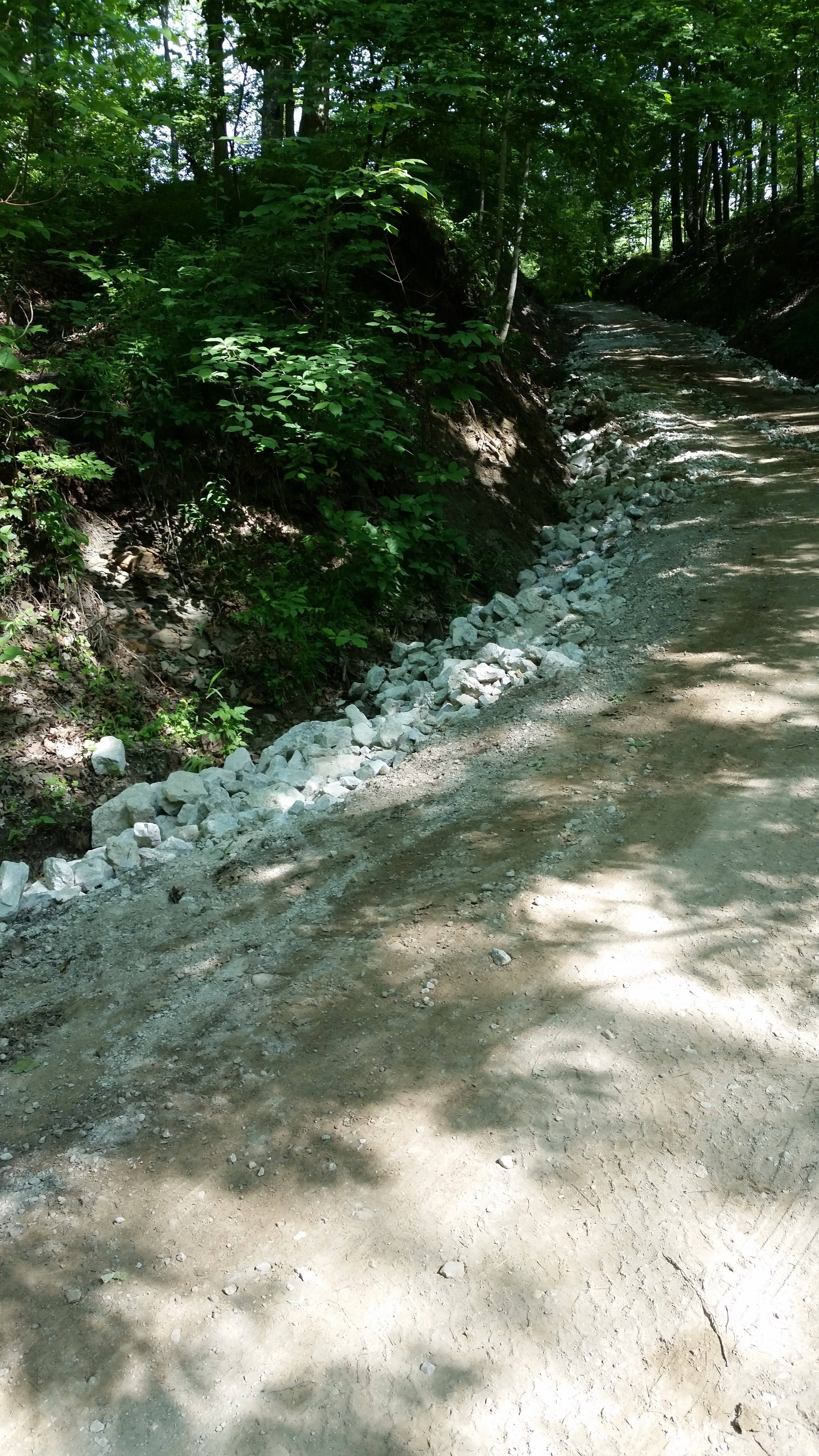

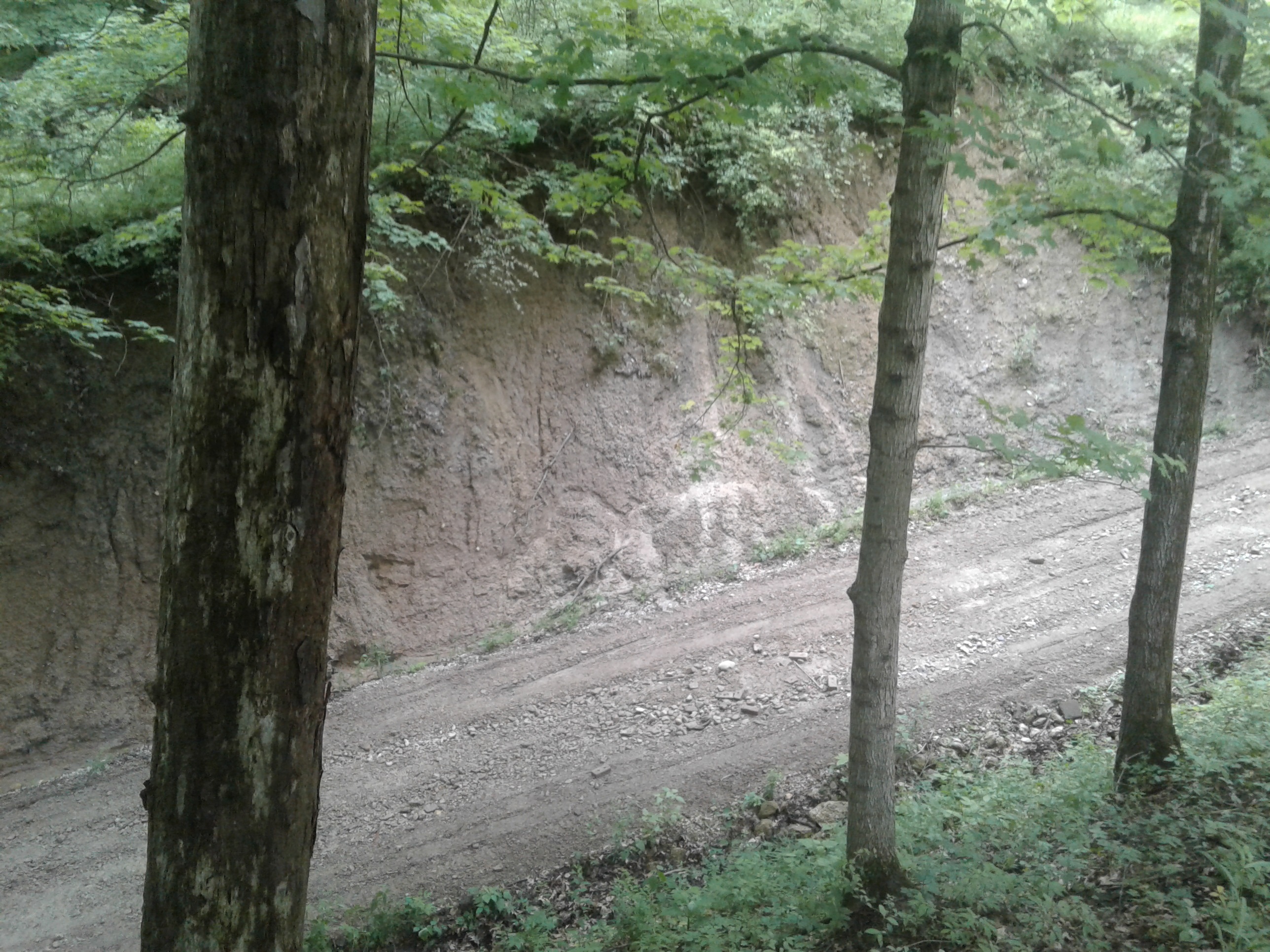

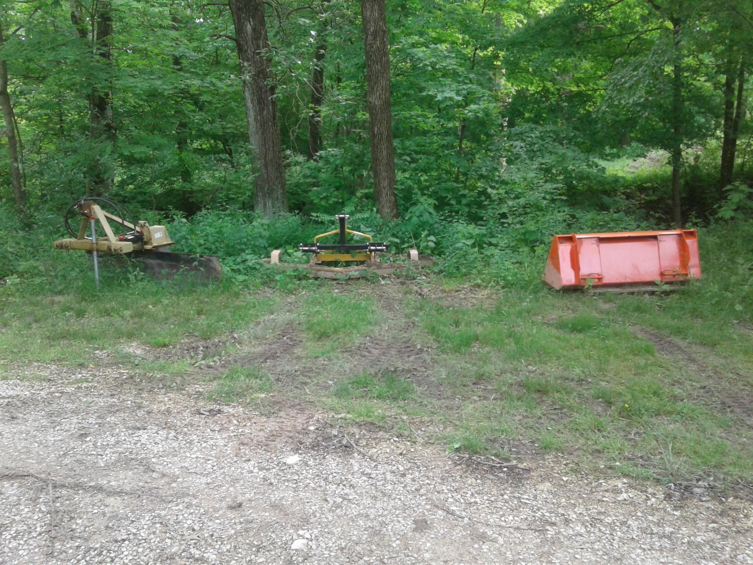

Ratchet rake wrong tool for job. I have a box blade, several other implements. Looking down from hillside you can see a mudslide and condition of drive after land planing. Not yet ready for ditch cleaning, expecting 2 more days of rain before I have 3 decent days to clean it out.
In recent past, drainage ditches have been reinforced with construction blocks and rip-rap gravel. Both hard on 3pt blades and box blades.
Best solution may be sell place, move to the flat lands.

Can you please ID the cars in the pic of the middle busters ??..thanks...just curious...
mazda rx3, amc eagle

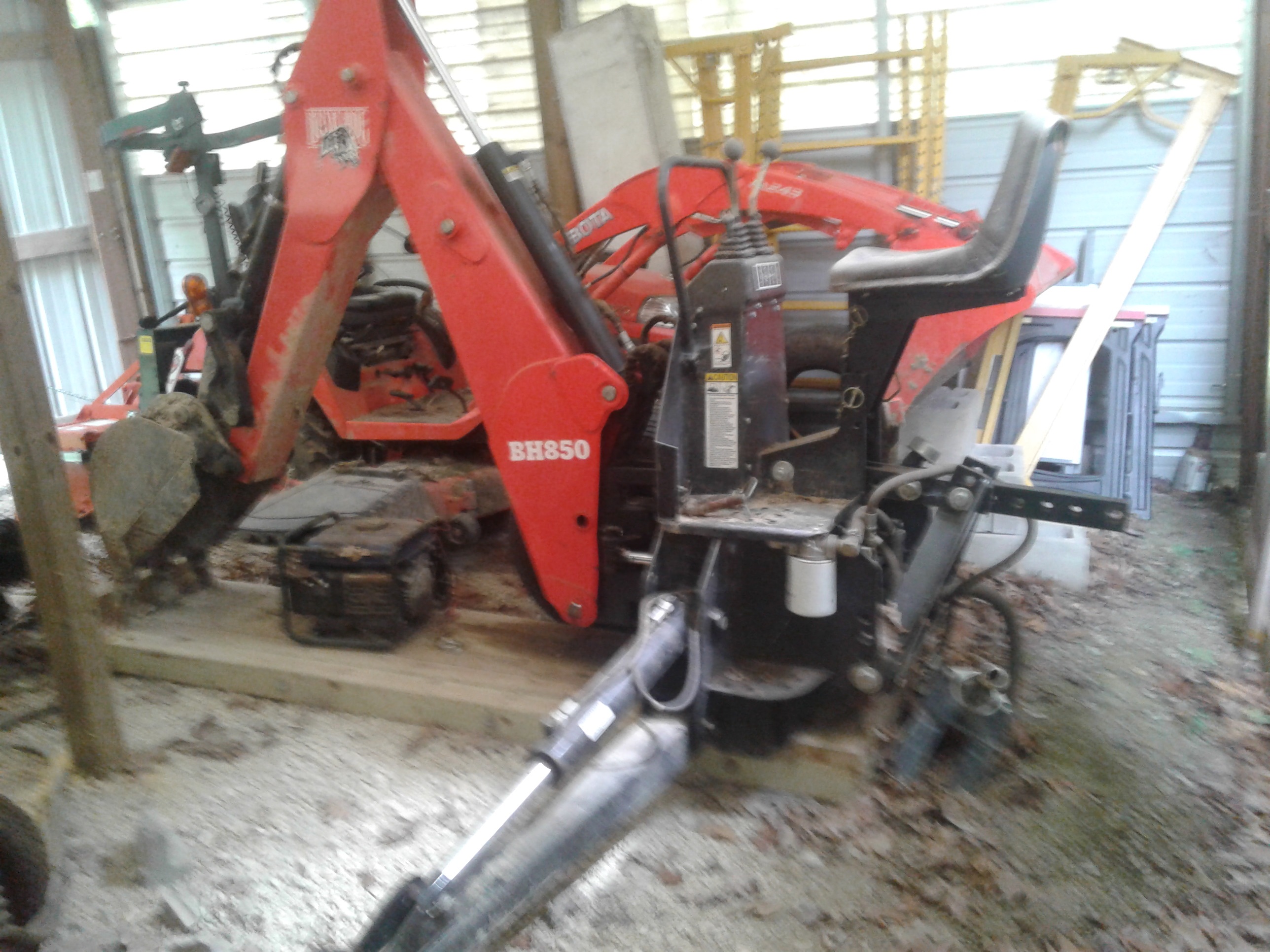

My suggestion were a couple of items 1) a rear blade that offsets. The greater ability to offset the better for cleaning out the ditch. But not much use for rip-raft rocks. 2) a back hoe. This would seem to be a better item with the rocks in place. And you have one! 3) a pressure washer to loosen the mud more and let it flow away down the hill.
