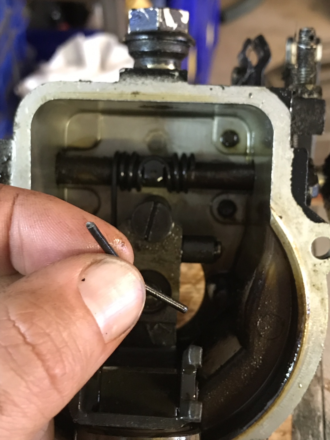

Following a suggestion from someone who PM’d me, (thanks - you know who you are) I had a look at the governor.
It didn’t seem stuck - but I found the cause.
The spring that pushes the bearing forwards has a leg missing. It was thankfully jammed in the bottom of the housing and hadn’t been munched by the governor.
Does anyone have a dead pump that can be plundered for a spare?
Or does anyone now the part number for this?

From the picture this looks like a pretty simple spring. If it is hard to find online, I would make one from scratch. For help with the making of a spring go to YouTube channel “this old tony” and search for “making springs at home”.

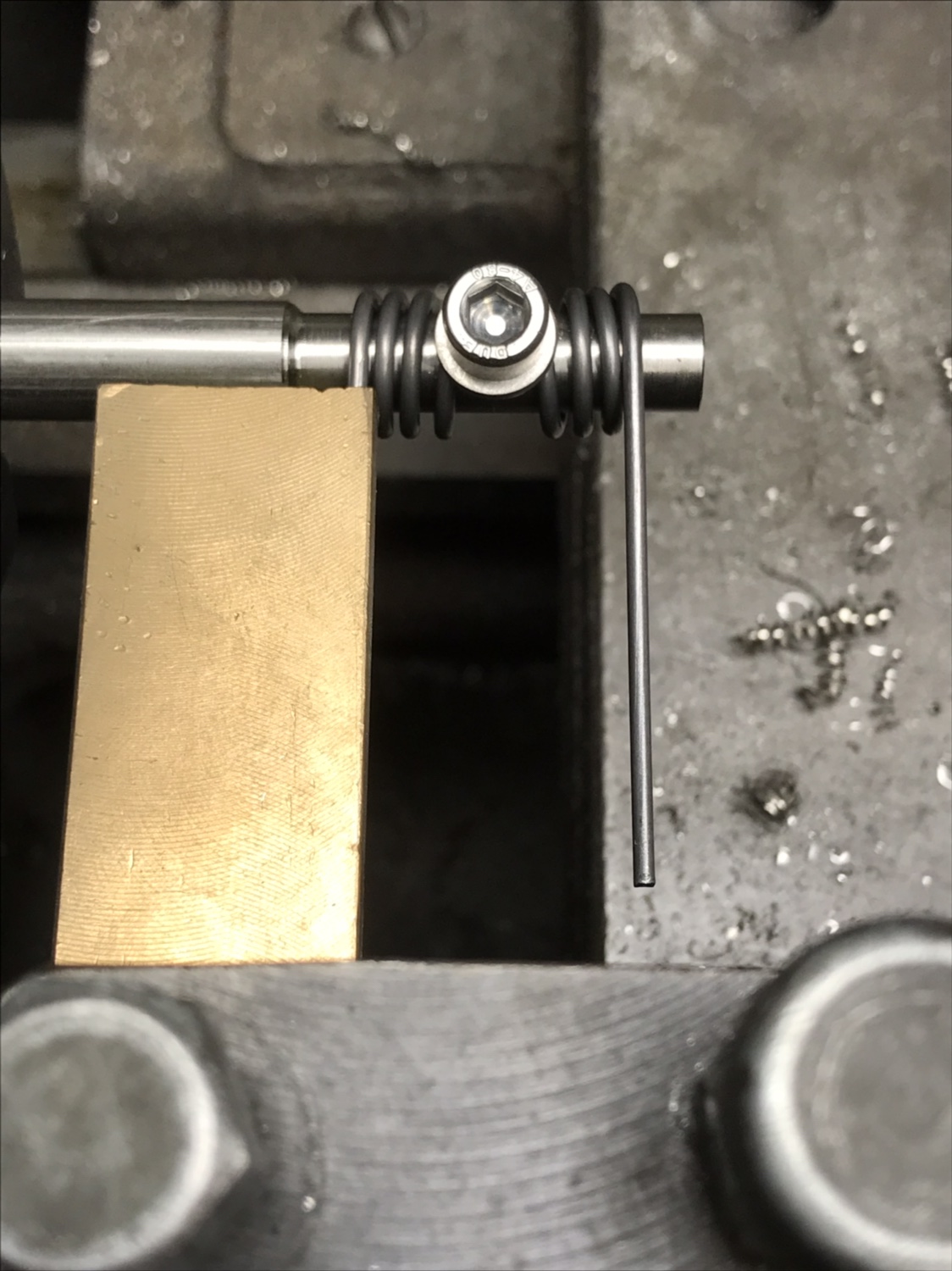

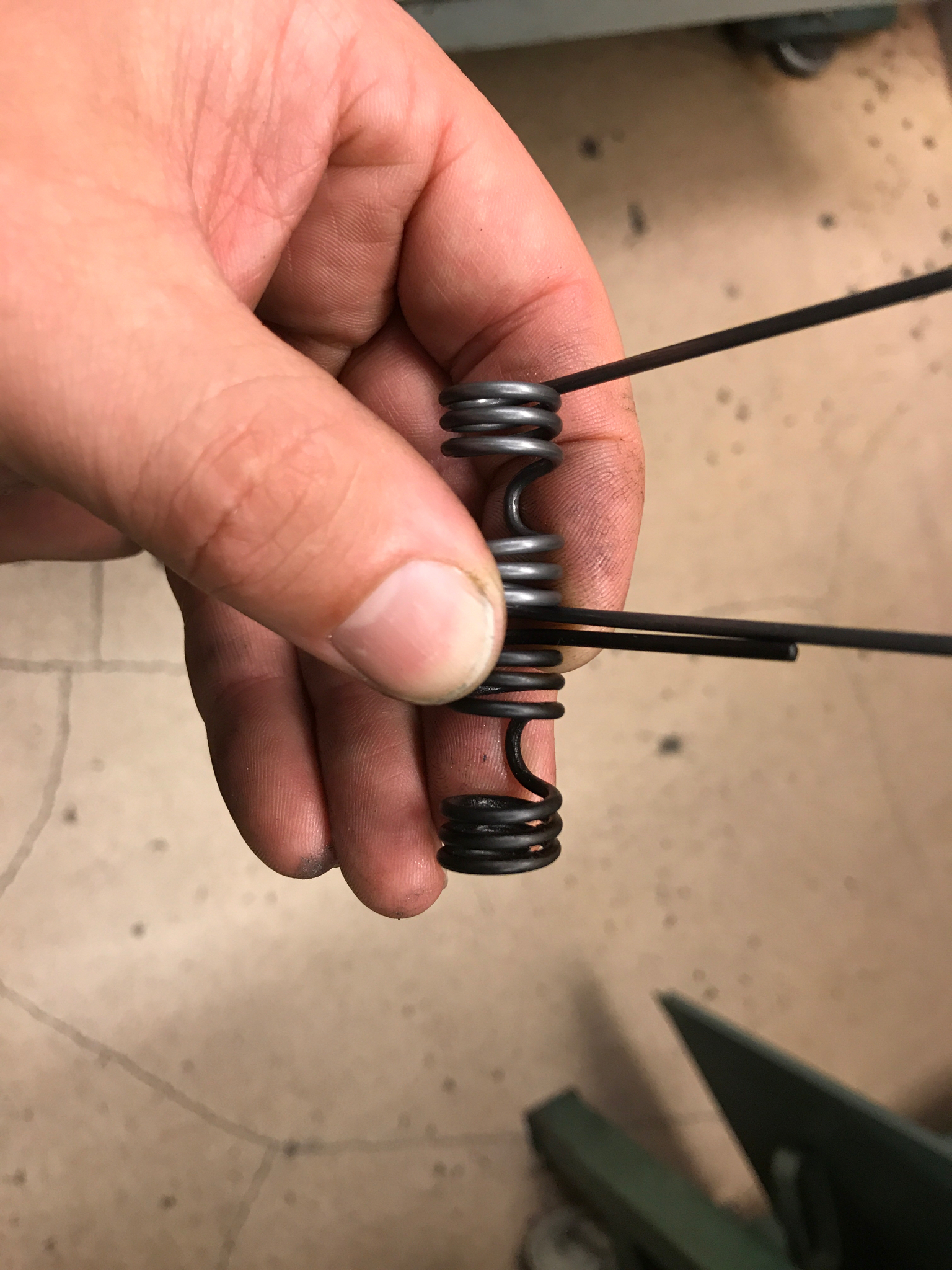

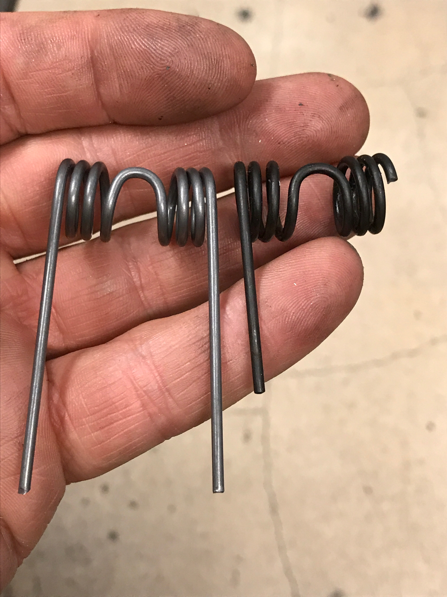

I’ll update when I’m done, but this is the last 5 minute’s work and first attempt.... IMG_9001.JPGIMG_9001.JPGIMG_3831.JPG

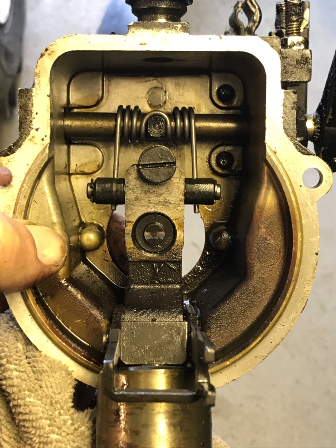

So. We’re up and running again with correct throttle response.
Thanks to all who helped!!
Piano wire was sourced at the local hobby shop. I got three meters (anticipating a long learning curve) and only used one meter.
The mandrel diameter was calculated using this online resource. Helical Spring Mandrel Design Calculator
I didn’t use a wire-tension system to wind on the mandrel - just a chunk of bronze up against the mandrel itself. (See picture)
Total cost - about $5 including new gasket material to re-seal the pump.
